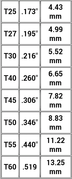

I stripped the screw T40-45? in the fender stay. Im not sure how best to extract this. Any thoughts?
Thanks!

Try this before you break out the dremel. First confirm the correct driver, T40 or T45. Source some fine sand, (mason's sand, pool filter sand, or scrape some off of fine sandpaper). Dip the tip of the driver in water, and then the sand. Then use a impact driver. Many times, the sand will create enough "bite" to free the fastener. I've done this on recessed fasteners when cutting a slot was not an option. YMMV.

I always take a torx bit one size larger and pound it into the hole. It’ll cut its own grooves.

No doubt it works for the smaller sizes. Best be swinging a big hammer when cutting grooves on the larger sizes.
