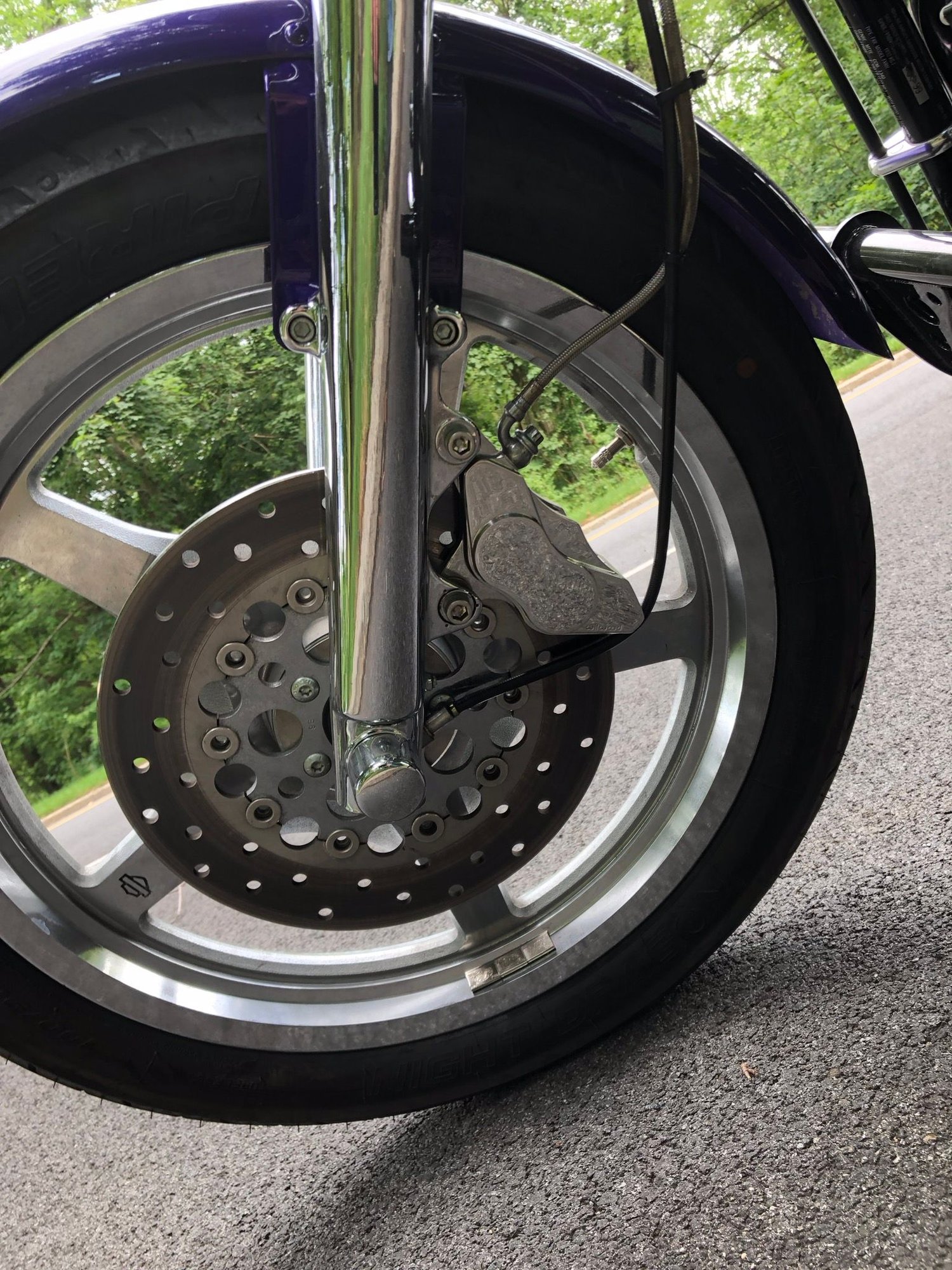

Here’s my current single caliper.
Old Jul 16, 2018 | 04:01 AM
grbrown's Avatar
grbrown
Joined: Jun 2007
Posts: 45,429
Likes: 2,898
From: Bedford UK
Until recently I had twin 6-pot calipers with 13" floating rotors on my Glide. Jus' sayin......
