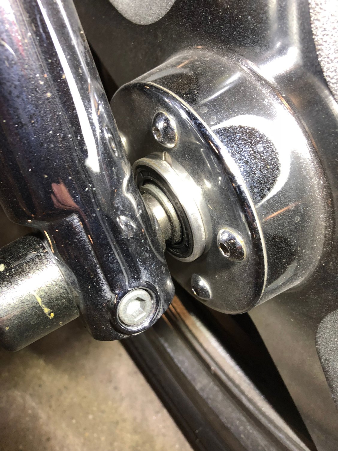

Just so it doesn't look like I'm losing my mind and posting random photos, Multi and I are exchanging PM's on the subject...
Here is the bearing area:

Are you losing your mind?
Yeah good pic

"Spacer 43613-92" ??? ... that's a center spacer sleeve ... don't need that
You will also need a hub plate to seal that particular rotor / thunderstar wheel combo from water intrusion ... Just like you have on the LEFT side
Yeah, stupid copy/paste mistake. I meant:
PLATE HUB 43985-98 - which is NLA...
