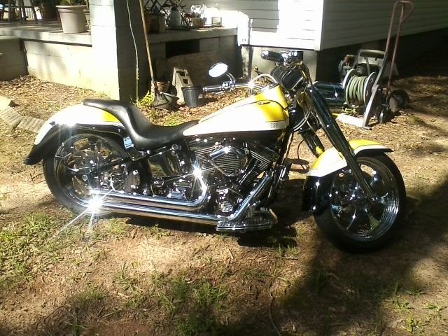

I didn't even think about how the front would be slammed. I don't know if they just used a spring drop kit or changed the tubes! guess I'll find out soon enough haha. I have not had it on a lift yet so I don't know how far the forks extend, if it was just a spring lowering kit like a burly or progressive would the tubes fully extend when its on a lift? would hate to have nice chromed out tubes that I couldn't use. do you have any idea on the stock ride height? and where to measure that? only pic I have at the moment

most likely they are a spring kit in the front and yes it should extend out* when you put it on a lift.. I have a set of stock springs that are barely used for the front...what rear lowering kit is it in the rear??Progressives?

The frame will sit approximately 5" of the ground, maybe a 1/4" more when sitting stock and upright.... The front springs most likely are progressives and the use a plastic plug to set the front ride height. I believe I used a 3 1/2" plug on top of mine when I replaced the springs. It actually picked it up a 1/2" over stock. As for the rear, if they are adjustable shocks you want to adjust them so that the curved part of the swing arm is even with the top and bottom of the frame.. Sort of like matching the curved sections..
ok thanks for that. 5", its a starting point. the rear shocks appear to be adjustable as I look at them through the frame. lots of threads showing on the stem towards the back of the bike and I can see the lock nut and the larger long adjustment nut. looks like a light copper/brass colored hardware setup and what little of the shock body I can see also has the same light copper/brass color if they are the stock shocks from 98 I will get some newer ones and just which over the lowering links to the new ones.
I looked at the fork lowering kits and see the plug you are talking about. depending on which kit it is I should be able to just add a little longer plug to raise it up some. I like the lowered look so I think I will just bring it up a little at a time to find where the ride smooth's out and go with that setting. what is the plug made of in the forks? PVC? looks that way!

Yep just regular PVC from your local hardware store.
