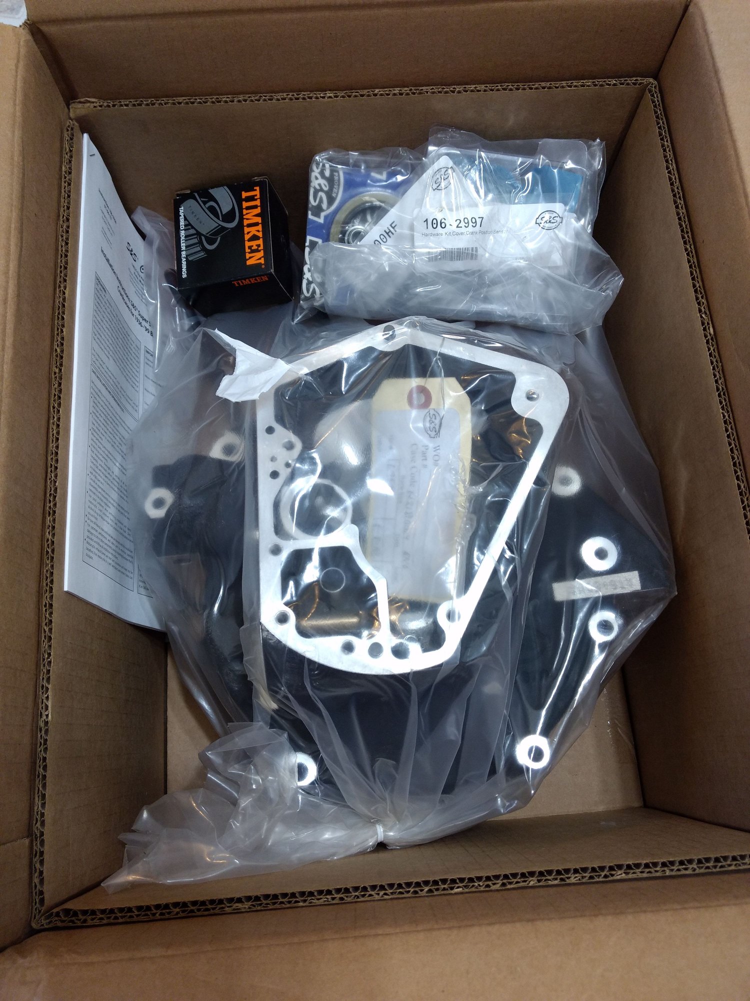

Early Christmas to myself... Lol... Now just have to find the time.... I have the gasket set as well.. Cometic C9766. As soon as I start the motor tear down the lifters need to go back to Fueling... Never could get them to quiet down hot... Cold, not a problem so Fueling wants them back... I think at this time I will also need to check lifter block bores... Never had an issue with oil pressure but it doesn't hurt to check...

That sexy, S&S cases are a good as it gets, of all the brands I've worked with they have always been the best. Clean beefier castings, excellent fit and finish and the machining has alway been spot on, never had to rework anything with them unlike several other notable brands.
Thanks twisted.. yeah they are... I have a steel S$S breather in my OEM cases that should transfer over shouldn't it? My first case job...
Who is going to line lap the pinion bearing race in for you ? That's the only non plug & play part beside checking the Timken bearings end play, use that as a set as it comes out of the box, they are matched with spacers. 99% of the time it's dead on but I have had a few I had to adjust.
Breather should be a direct swap just check fit and spin before assembly.
