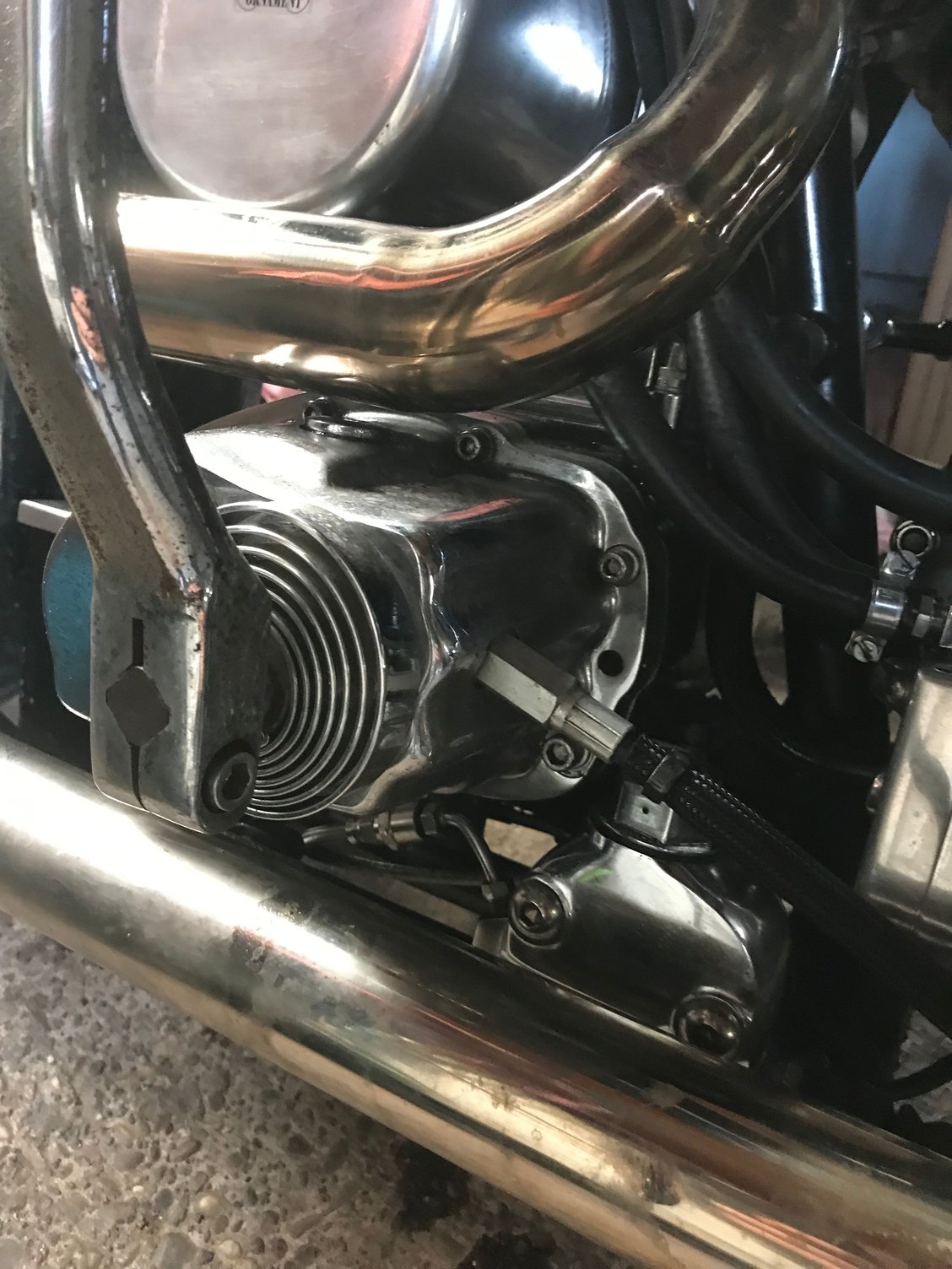

Originally Posted by Stevo1340
thank you
its great to get good advice
ill try it and let you know
it’s sometimes frustrating when people assume that everyone should know at least as much about bikes as they do
very much appreciate the very useful help
This it the ****er
