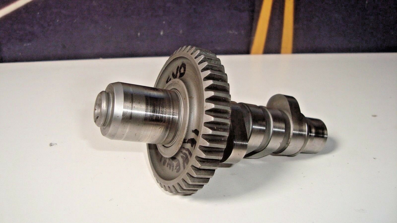

By looking at the pics, lobe design of E5S is almost square, so it will open valves in full, almost instantly, within "few" degrees. To me, this design looks different what I'm used to.
I'am not actually looking for an expandable, or universal cam for supporting my possible future setups, but always trying to find best cam for the exact setup I build. If cam has to be changed, that's not an issue as new cam cost is just $250 or so, and some small amount of work for me; maybe 1.5 hours + bleeding times.
As this is hobby, I am not that much into mainstream, but rather want to research and try (and error) something new. Otherwise it wouldn't be fun...
Some internet pictures of E5S lobes. Valve opening looks pretty brutal to me..:-)

I think this one is going to be a wash. Compression will always "ALWAYS"... aid in the entire power band. More compression= More Power... However, there are many cam characteristics that will determine where the power will be made but it needs the proper compression to release it... Both cams will have early cylinder fill with both iv's opening@25*. Yes you can bring the E5s to 10.5 but keep in mind the corrected compression will be 9.77:1/206 ccp and the EV46 will be 9.61:1/201 ccp. This alone will make a difference in tuning the bike properly in which I suggest you get an AFR meter to aid in properly tuning your motor. If you take a close look at the cam characteristics you will see that even though the E5S has greater overall lift, I think the duration of the EV46 will accomplish close to the same power band (but only a dyno will tell) not only that I also think the 46 will carry out further than the E5S (which will put more are under the curve) and will also be easier on the valve train.. Square lobes are harder to keep quite and the E5S is known not to carry out into the higher rpm ranges. Now look at the LSA With the E5S @104.5 and the EV46 @101 the 46 should come on sooner, especially with higher compression. I'm not trying to deter you on cam selection however I think you should do the increase in compression and a dyno tune on the 46 and then swap the cams and do the same with the E5s. It truly is the only way to really confirm any improvement.
