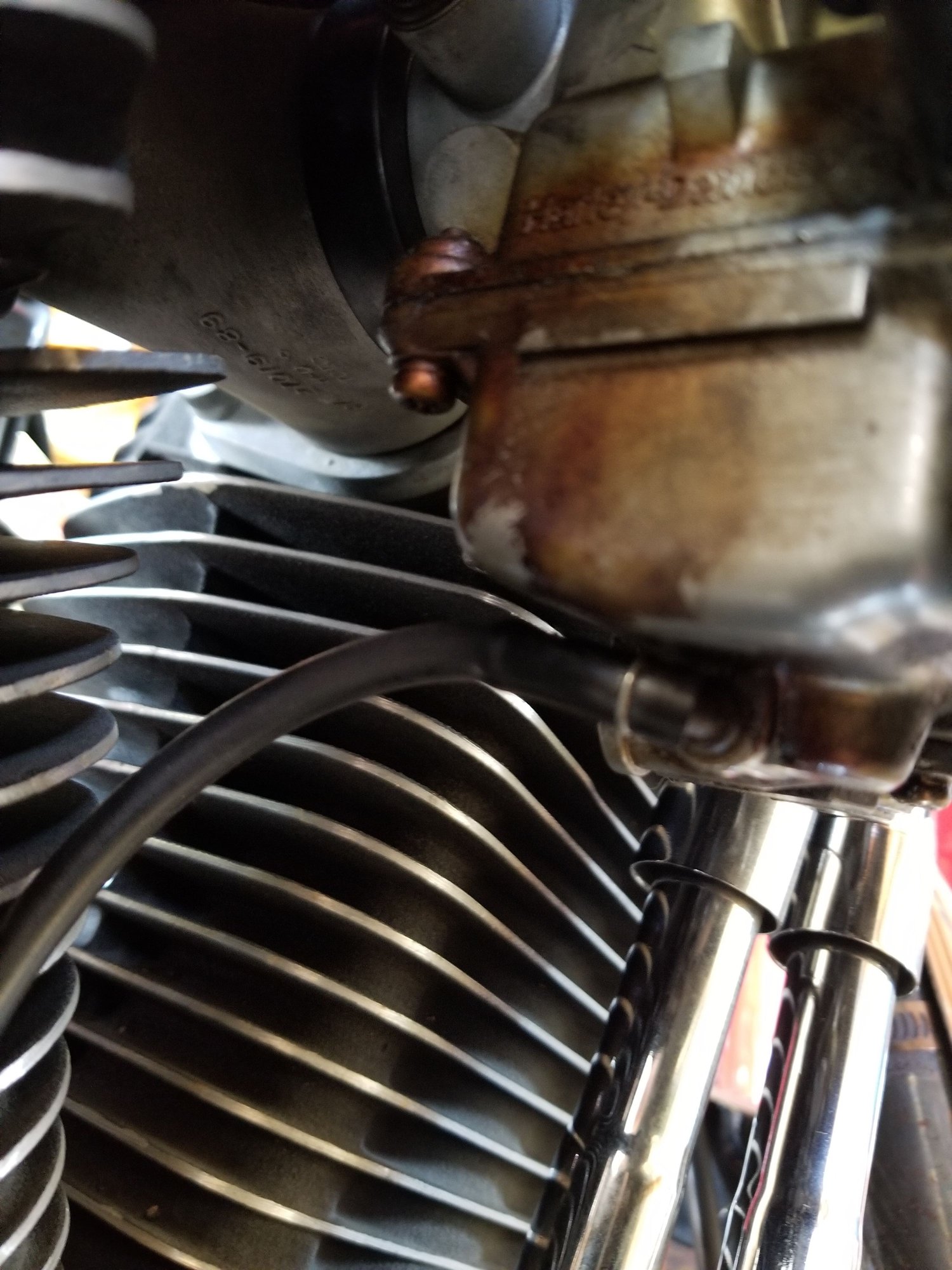

Default Pics
Here is a picture if the hose.
Old Apr 13, 2019 | 05:53 PM
misfitJason's Avatar
misfitJason
Joined: Dec 2010
Posts: 6,849
Likes: 1,389
From: Florida
its the overflow
