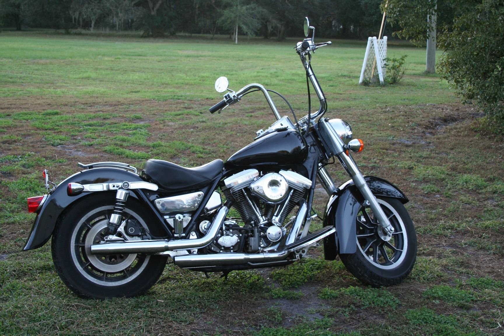

I have a 1986 FXR I bought in 1986 with only 110 miles on it. I love the bike and will never get rid of it. I also have a 2007 Springer and a 2016 Indian. Both of those have a 6-speed transmission. When I ride the FXR it just seems that when tooling along in 5th gear that it needs a 6th. I contacted Baker about a 6-speed drop in transmission. They told me it was a little more complicated than just "drop in" but the biggest issue was the cost. It is not my primary rider and I even have the antique tag which dictates limited mileage per year. I feel like I cannot justify spending more than the bike is worth, although it is sort of priceless to me. Just wondering what I could do to get the RPM's down in high or 5th gear. Change the rear sprocket? Compensating sprocket? Front Sprocket? Re-gear the existing tranny? Does anyone have experience with doing this? Weird that it never was an issue until I have logged all the miles with a 6-speed.

I see it's an FX chassis but whats with the FL tins and front end?
The up grade to a Six is worth it... I did it in my 98...

The front end is a '99 Heritage. I added the tin kit made for an FXR as well, along with running boards. I always liked the look of the FL and the ride/handling of the FX so voile. It is a very comfortable bike/ride.
