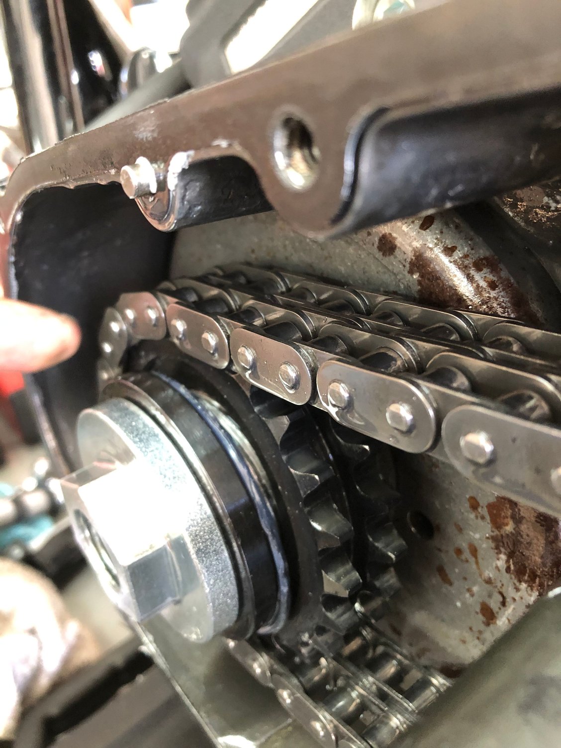

I was riding home from the gym last night..Took off from a red light was going through the gears when all of a sudden the bike lost all power. It didn't shut off, but the gear wouldn't engage. Thought maybe it slipped, down shifter, the bike lurched and gear still wouldn't engage..Coasted to a stop, probably in the worst area as the next street was uphill around a blind curve, no sidewalk, and I just got done KILLING my legs in the gym.
Got the bike off the main road. Checked tension on the clutch, all good there. Went through the gears with the bike off, seemed everything was fine. Started the bike again, and something just didn't sound right. When I first hit the start button there was a short whiz. Once upon a time the screw holding in the jackshaft backed out and the starter made the same noise. Will pull the primary off today and get a better look. I'm hoping the chain tensioner didn't fail.
I swear this bike has ghosts...There's always something

Look at the compensator. There was some nylon in there that looks like it came out.
Full on primary.
Prices of metal and nylon in fluid
Chunk of nylon bouncing around like a ping pong ball

Took the compensator apart
You can see where it started rubbing on the spacer.
The threads are ground down. Probably the metal shavings I saw in the fluid
More ruined threads.
