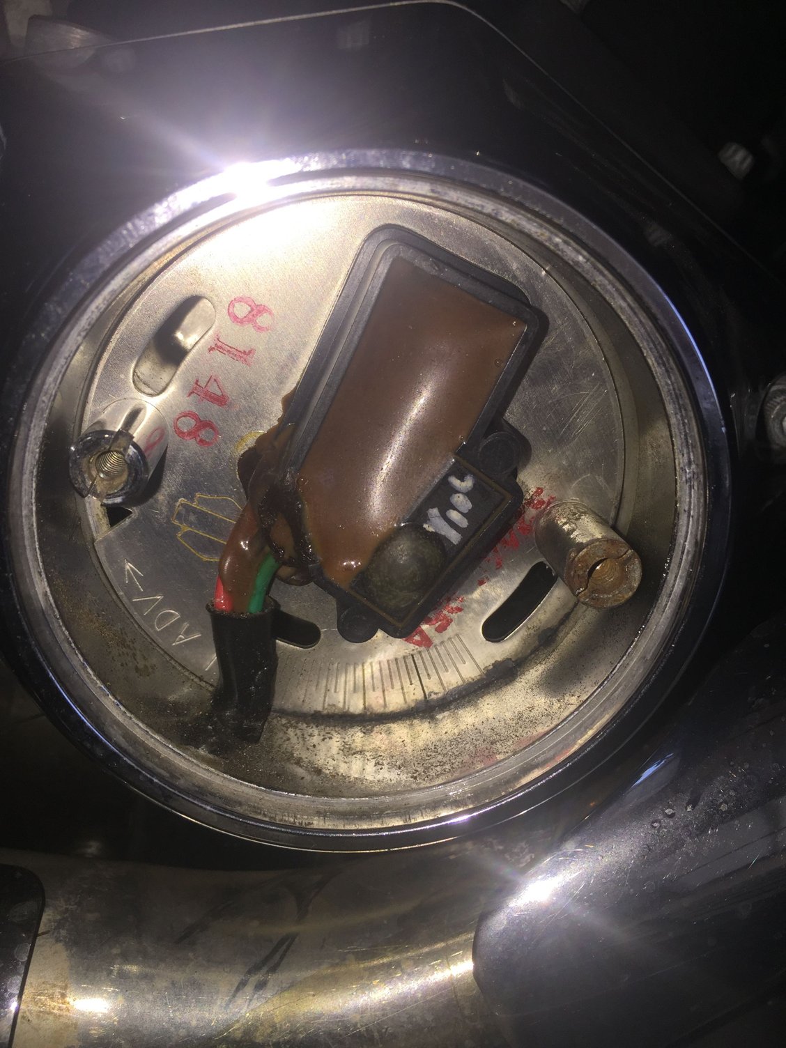

Cam position sensor is melting the brown goo out down the wires. However the bike is running great and no blowing fuses. I’m gonna replace it anyways....mileage and years.
No codes and everything is checking out ok by using the breakout box.
Could this failing sensor cause the ignition fuse to blow?

On Amazon you can hey a CPS made by standard Motor Products it's a direct replacement with Deutsch pins.. Real easy to do, right into your connector. part number it's MC-SPA3. There like $40..

Melting....,
Got one ordered.....on amazon. The new one appears to not have that brown goo. I suppose the electronics have probably improved since 1998.

The Harley "B" model sensor has black goo. Supposed to not melt.
