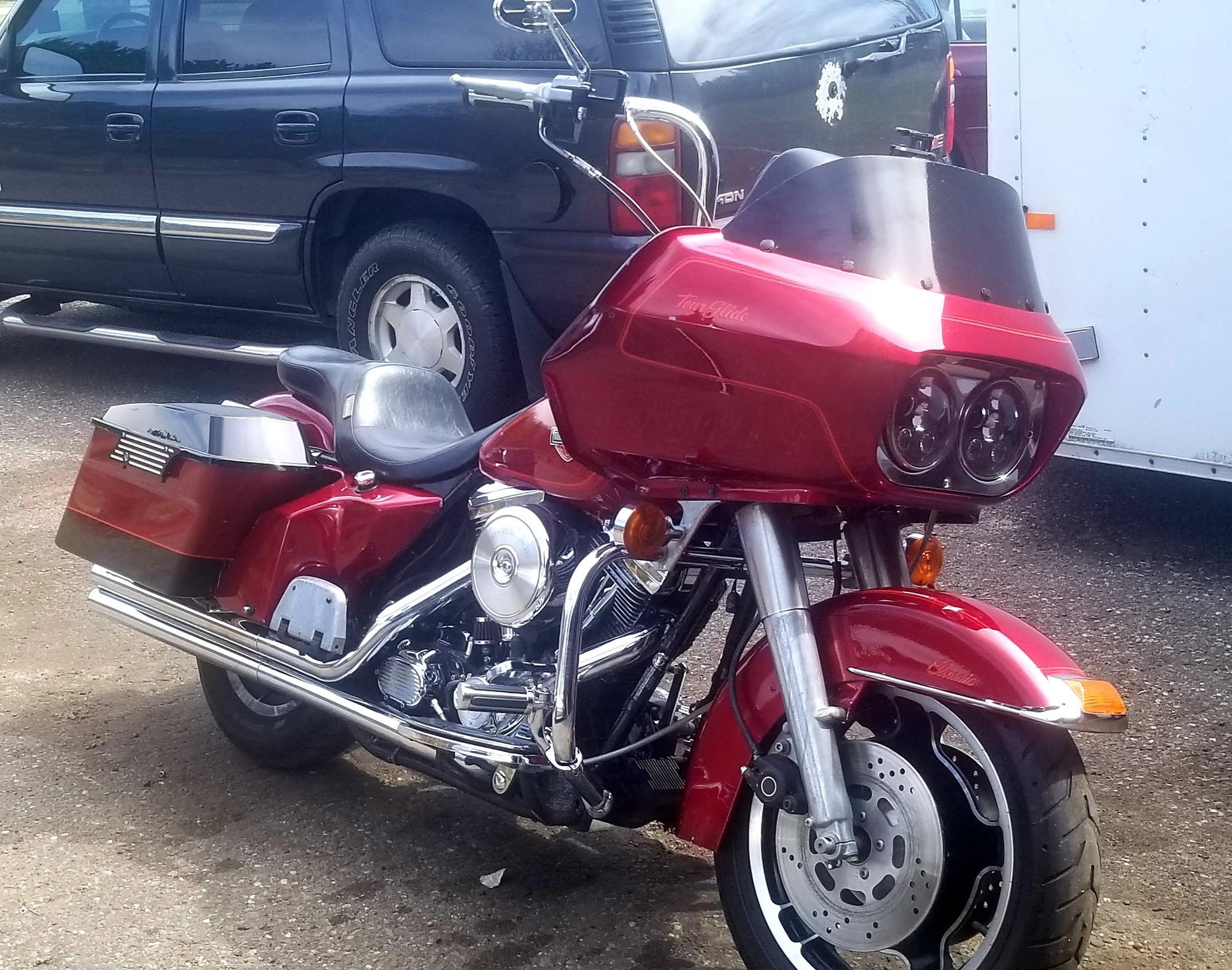

I have done this to my tour glide and order a pair off ebay for under a 100 bucks plug and play. they work awesome! been over 2 seasons no problems. you do have to do a little trimming cuz they are more deeper. but not hard.
Wow! That's good to hear. I never found any that "looked" shallow enough in photos. Doubtful you'd pull your mount just to show us the mods you did, but do you recall the brand of light you used? And is that a Corbin saddle?

The brand was Sunpie and after work today Ill pull headlights out and show you the mods I did. only mod was with snips to metal mount for depth. harness was plug n play. I changed them out in my buddies drive way in about 30 mins. They are night and day difference at night!!! Oh and yes to seat.
