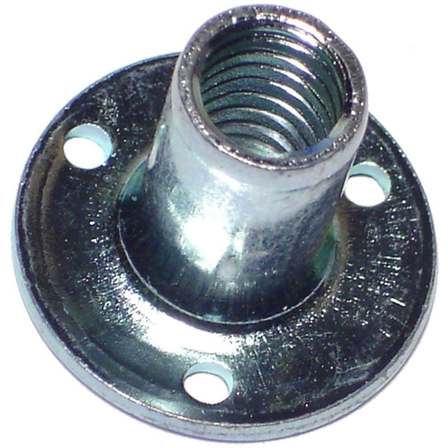

You need to find out the exact width of a Stock Dunlop tire VS your current tire. That tire looks to be over sized from stock which is likely the cause of your issue.
Now that aside, when I did the conversion to a 150, the fender though tight did not rub on the tire. it was actually the fender and license plate hardware that was rubbing. I had to get creative and make things happen to make the hardware more low profile, after that I was all good. Maybe give that a look, hardware is easier to deal with then the wheel and fender. I used a bunch of Tee Nuts, with the tee going back into the fender/strut. Then cut all the bolts flush.
