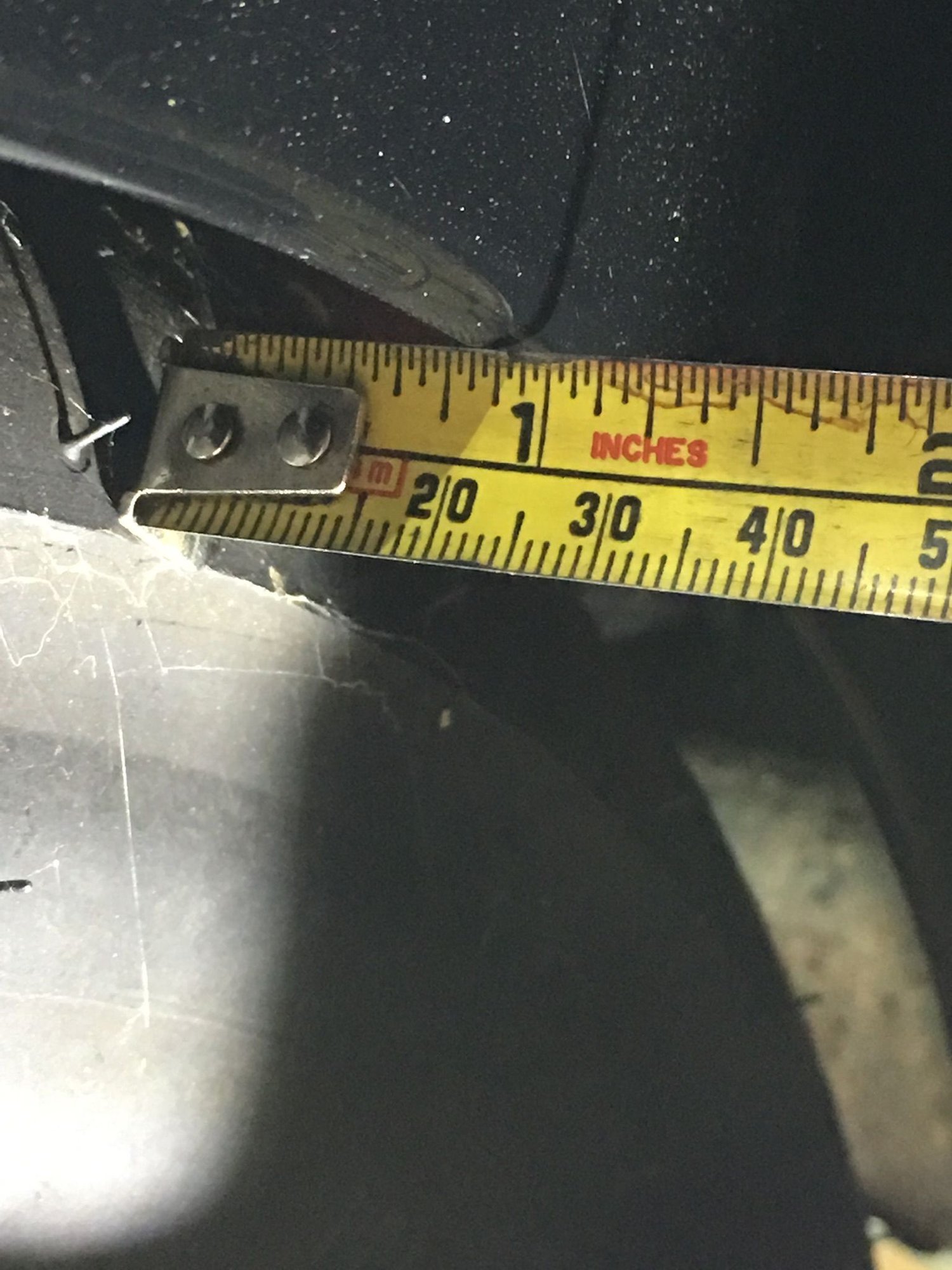

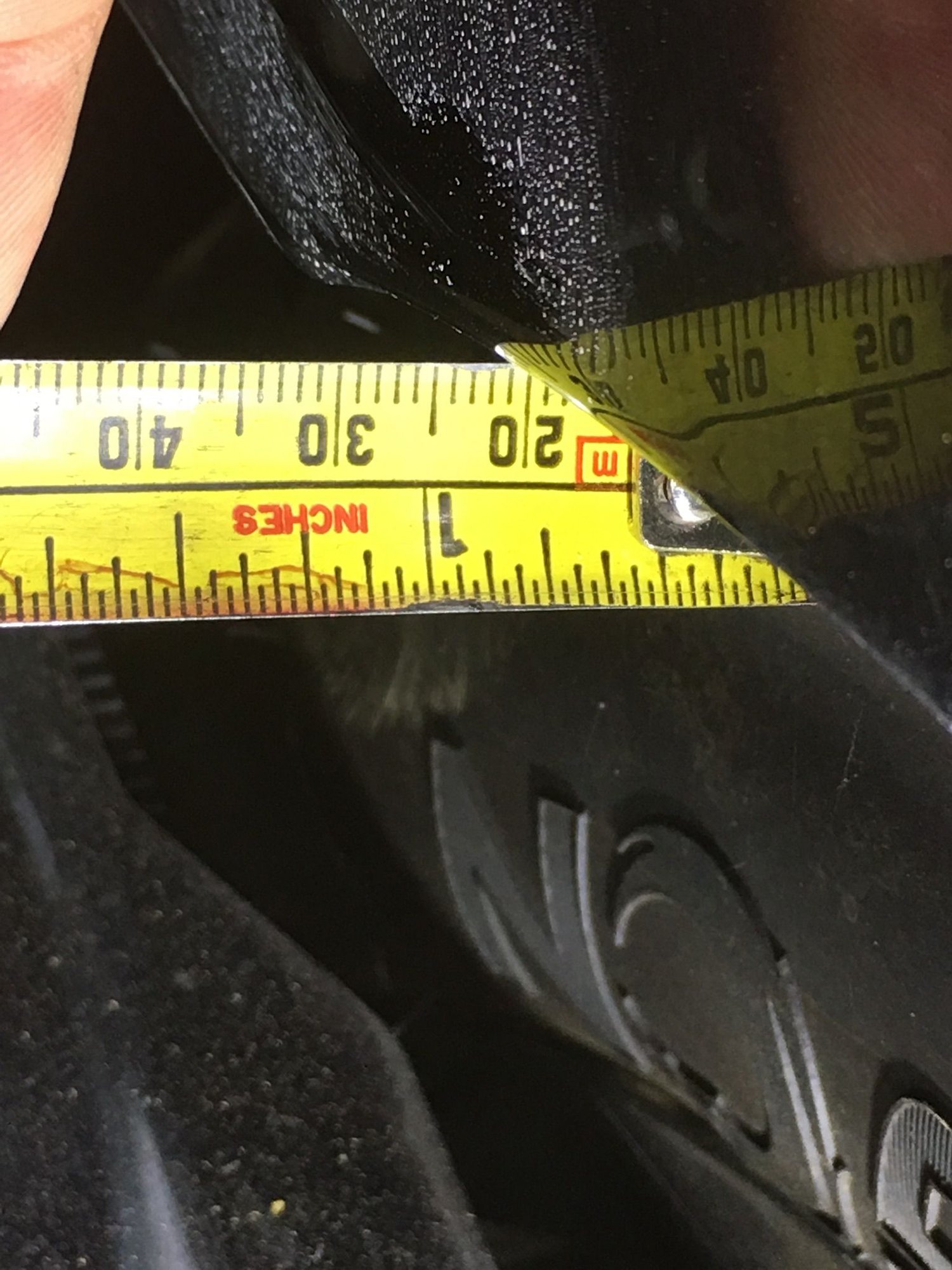

Ok I got the pictures of my bike for you, sorry for the delay. Mine has about 3/4” of clearance on each side from the tire to the fender.
