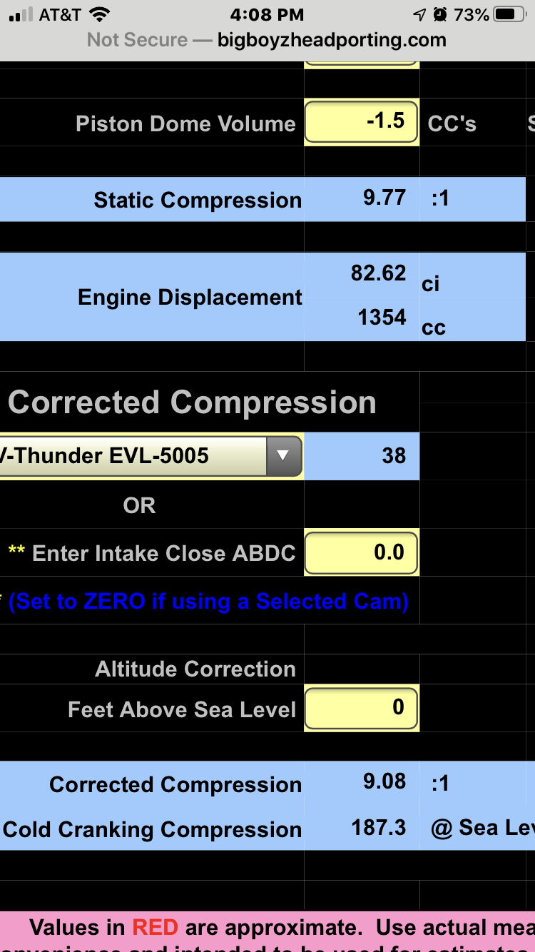

Great cam!
What I’m running in the Lowrider, S&S Performance Heads, cc’d to 71.5, Mikuni carb & Thunderheader.
Bikes not quite 600lbs & I go 230lbs, so pulling some weight.
Sometimes go 2 up & that’s no problem.
Posted up some statistics of what I wound up with, as far as compression, etc.
Good Luck with your choice.
