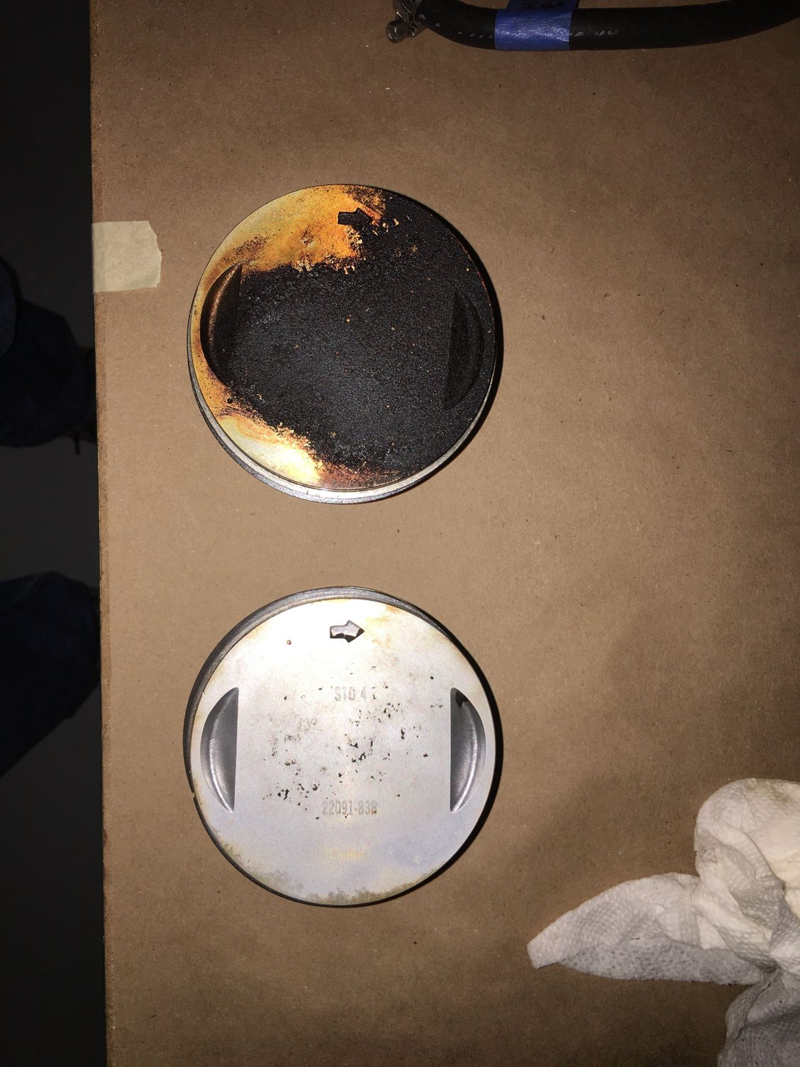

Old Mar 21, 2020 | 11:12 PM
drm1978's Avatar
drm1978
Joined: Aug 2014
Posts: 302
Likes: 49
From: Gambrill, MD
So, it doesn't cut nearly as fast as glass been does, but it doesn't mar the surface either. Here are my two pistons; 1 before, 1 after.
It also did a nice job on the combustion chamber of one of the heads. The primary problem with a small blast cabinet is that it's hard to see. Once the media gets flying around (although I have a shop vac attached to it), visibility sucks. That makes it especially hard for complicated pieces like the cylinder head.
-Dave
