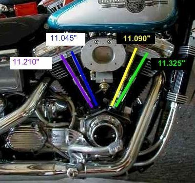

this is very useful information.. and should have been in the original post.. any ways you said you used the stock pushrods.. Are you sure you installed them in their proper position? They're not all the same length..
