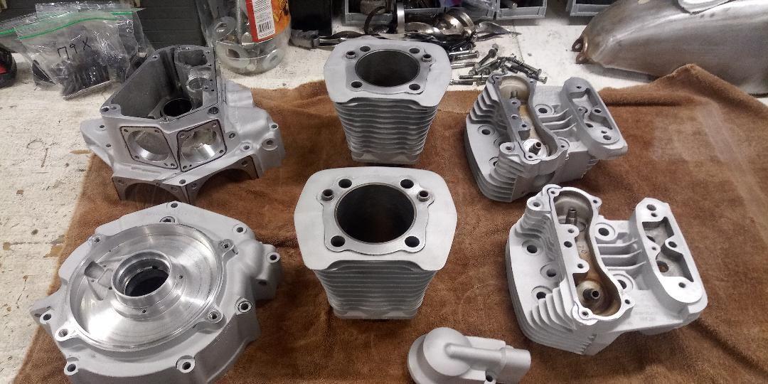

Old Mar 10, 2020 | 06:20 AM

Please tell me it's a trick of the light and that someone didn't just sand blast the gasket surfaces!!!!!!!
Old Mar 10, 2020 | 05:33 PM
silvereagle1770's Avatar
silvereagle1770
Joined: Dec 2012
Posts: 49
From: mich
must be a trick of the light no gasket surface got it and was told not to sandblast so they were glass beaded ?
Old Mar 10, 2020 | 10:35 PM
texashillcountry's Avatar
texashillcountry
Dirt don't hurt
Posts: 21,062
Likes: 4,547
From: Haslet Texas
FWIW no matter what the media I call it sandblasting it's just a generic term to me.
As long as they didn't hit the gasket surfaces it's all good.
You might want to check all threaded holes though.
If it was a good shop they have plugs to put in them to protect the threads while they blast and if they didn't you will have to retap the holes as the blasting will mess up the first thread or two.
