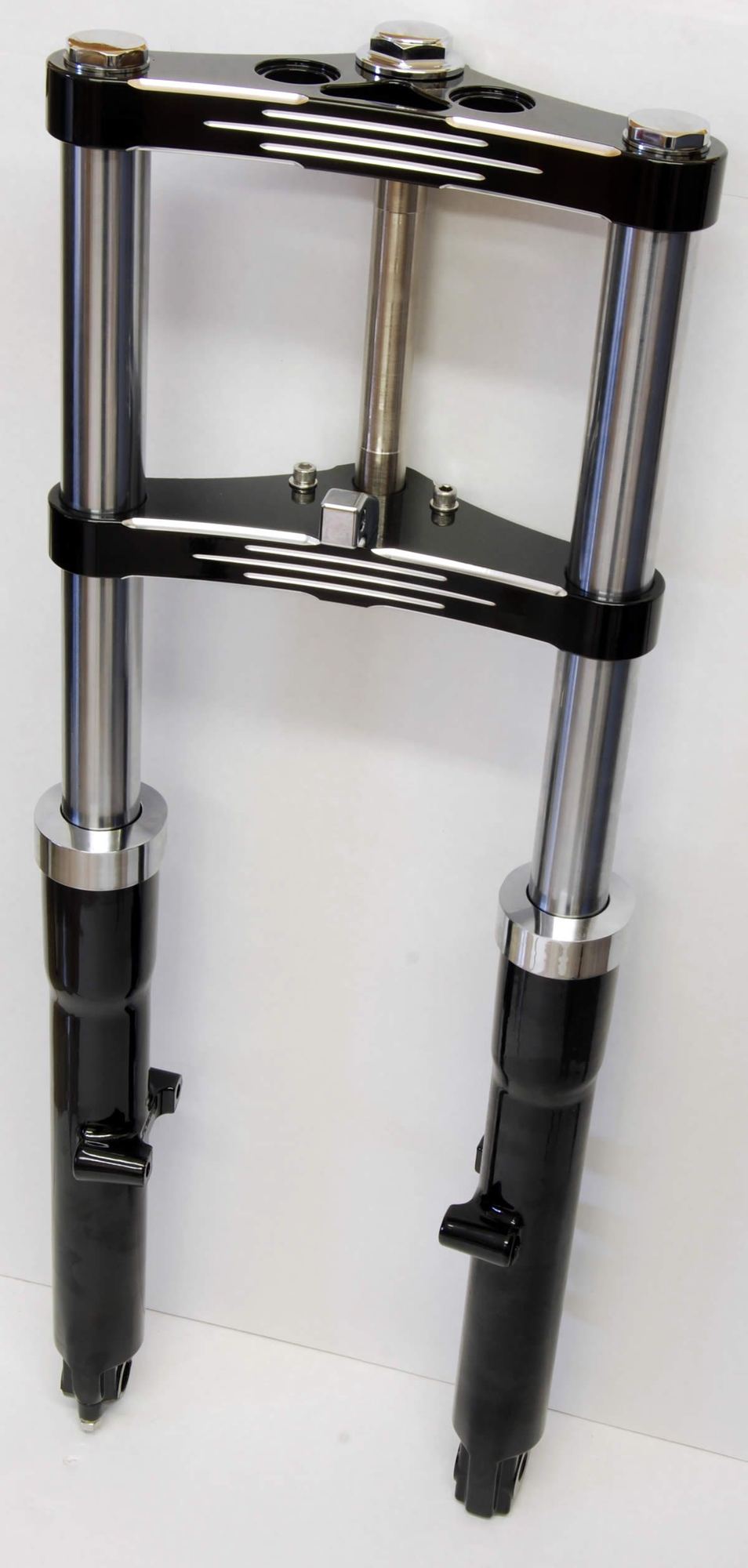

This is the front end I'm contemplating. Motorway engineering sells them. Also known as Vulcan Engineering @ vulcanworks.net. They use OEM 2000 up lowers. Which is nice because of the better calipers than what we have to endure.. They say they set the trees up to 0 rake.. so the only thing I'll need is a caliper, a new fender and a new headlight.. definitely thinking the 2" over on the tubes. My trail will still be up around 6.0". But that depends on the triple tree offset.. Currently my Fatboy has an offset of 1.36". If the new front end has more offset then it will bring down the trail a little but I don't think I'll feel the difference....

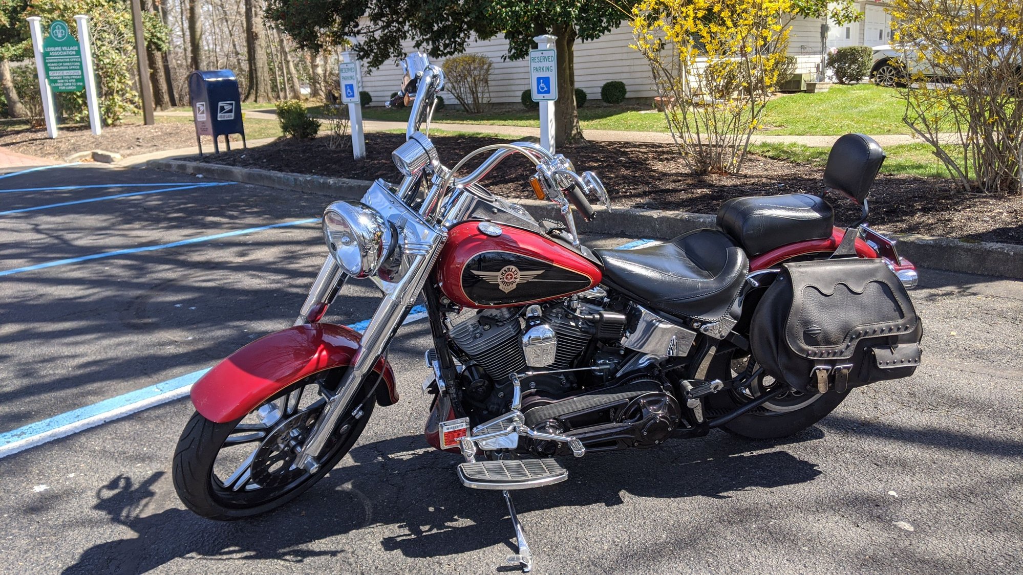

and here's a pic of my new Buck Horns... Took the bike out for a quick ride and man these old school bars feel awesome... Love it...
