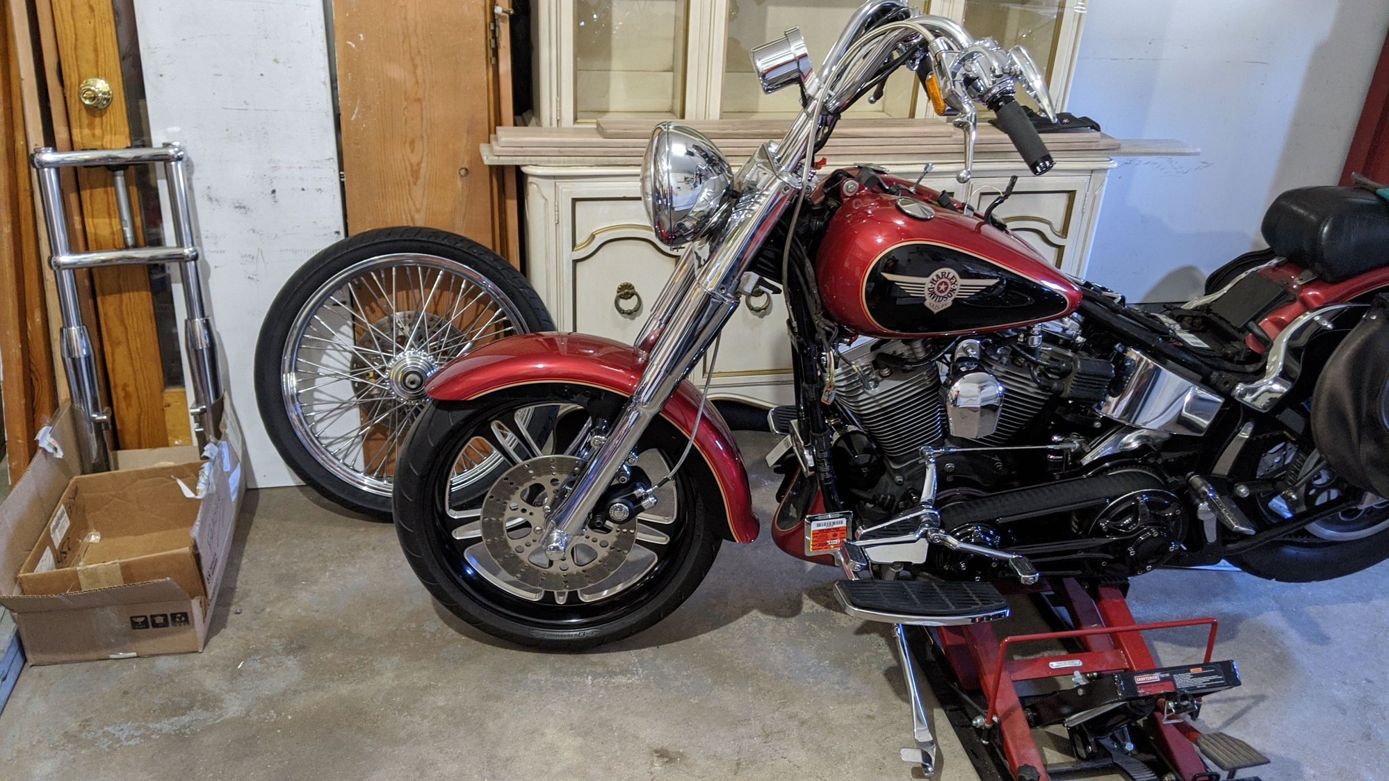

Friend of mine has a Demon Cycle Wide Glide front end that he took off of his '07 FXSTC. It's got a 3° rake and It's 2 inches over on the tubes. With the 21 inch wheel that he's letting me borrow for a little while It should put my trail right around 5.7". We'll see what happens and how it goes down the road. So I'm starting thread off with this first pic of the disassembly and will update as I go... Hopefully it'll be back on the road tonight or tomorrow..
Maybe... remember raked trees reduce trail...

As long as I keep it over 4" I should be good..

Absolutely...4+
I rarely measure Trail numbers... If I like how a setup handles... I take a Note what the changes are/were... Not all of My Bikes see like same service however!!! ie, Slow Racing is Not Drag Racing!!!!!
