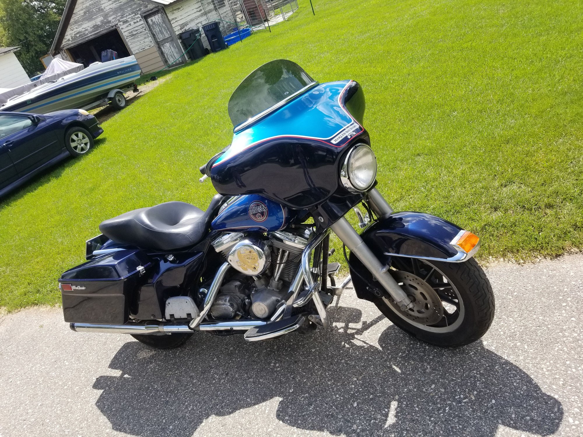

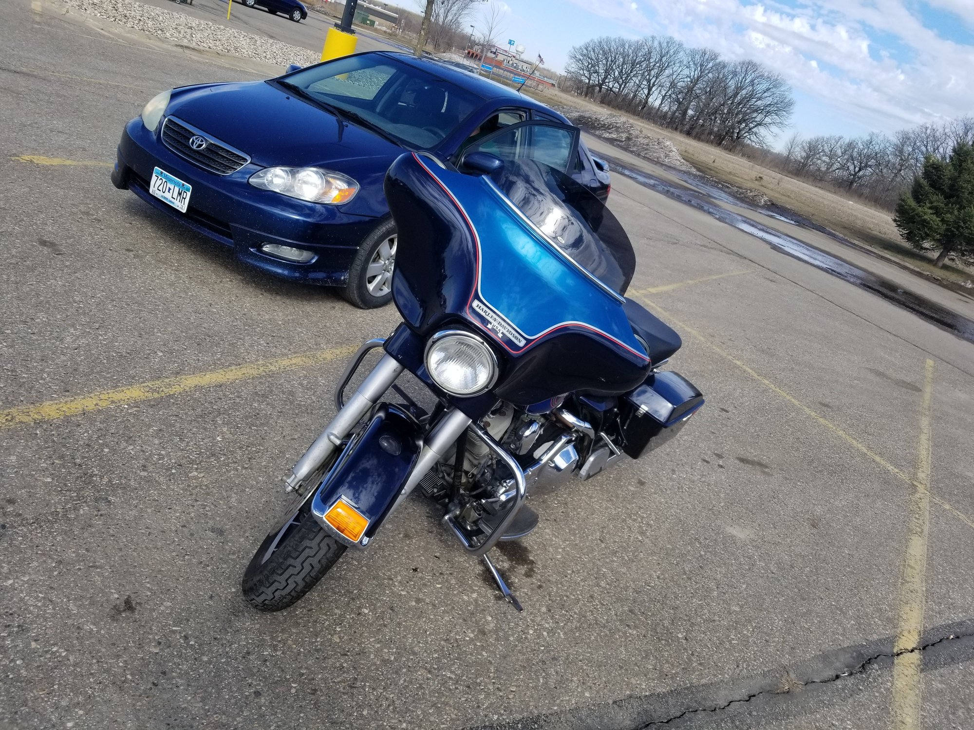

So last year I picked up an 87 flhs for $3400. At the time.i didn't think it was too bad of a price. Her is "cocotte" the day I picked her up.
First few things I noticed that where wrong was the radio did get any service, I didnt like seat, bike felt floaty, needed some more leg room oil pressure gauge and volt gauge do not work and it needed different bars.

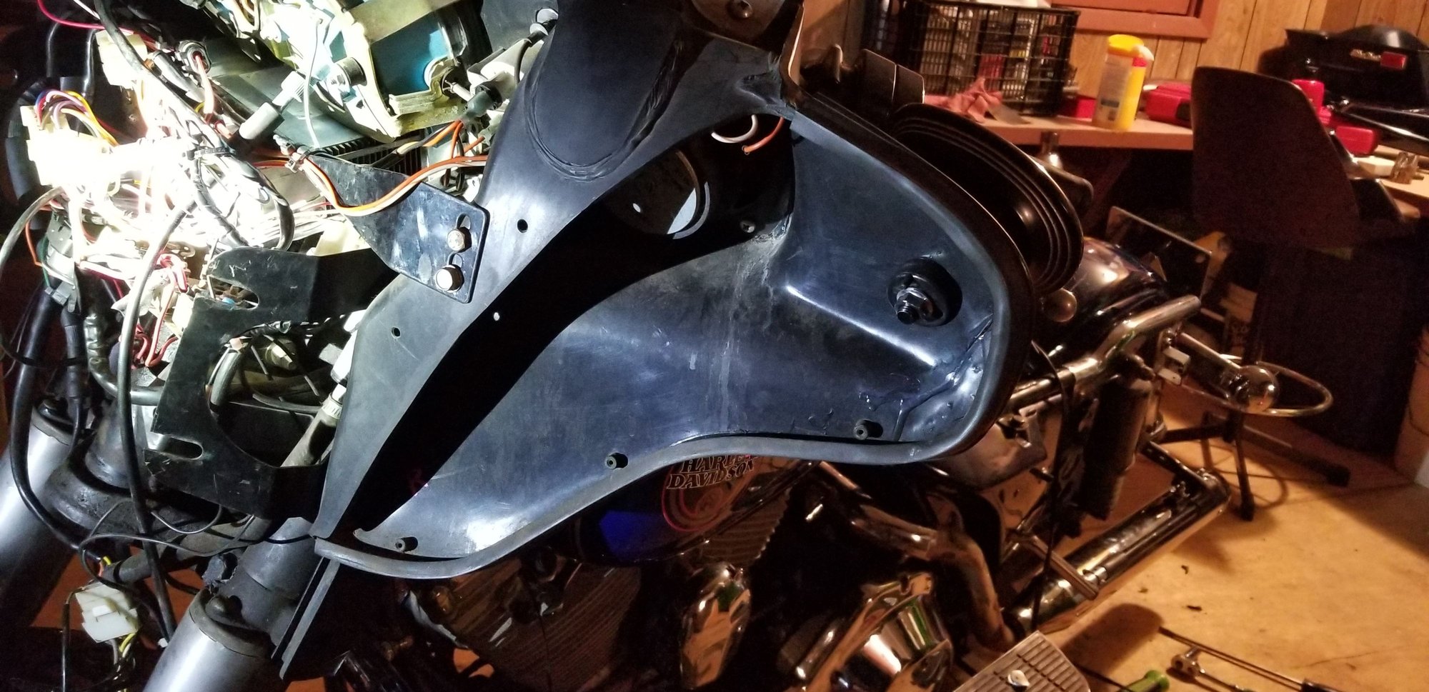

First thing I did was find an old cassette adapter so I could see if the radio worked at all. Turns out the radio works. Big plus. Go out to dinner and the keeps cutting out. Pretty much just played at an idle. Frustrating. So no radio rest of the weekend. Finally get home and start taking about the front ferring to see what I can find. Holy rats nest of wiring. So I start cleaning up the mess a little. Get to the radio and find the antenna wire is cut and both connectors have male end connections that didnt really connect. So cut out the old connections and installed new. Tape plays all the time now u less it feels like flipping sides. Pictures not the greatest had a light shining on the wiring so I could see better.

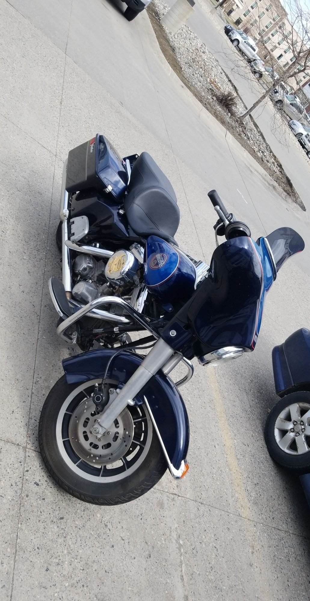

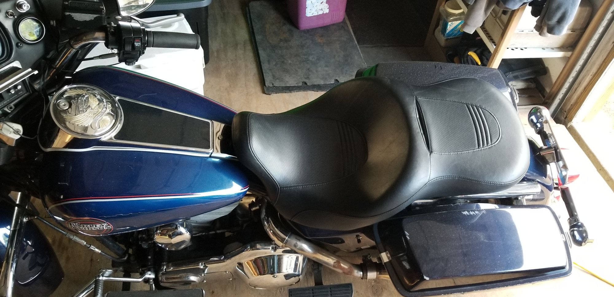

Couple weekends later I was over at one of the ol lady's friends place. So while the ladies hung out the guys went and looked at bikes. He showed me "ginger" 14 road glide. While hanging out in his garage I noticed a seat and some highway pegs sitting around his garage. So we struck a deal and they became mine. Went to put the seat on and the one of the previous owners bolted the seat to the rear fender. So that was a no go, but we did get the highway pegs on. Which I used on the way back home and I could comfortable stretch out my legs. Get home jack the bike up and unbolt the seat. Well the seat that was on there was a reach seat. I'm a lanky 6' 3" so that didnt work for me lol. Got a 1/4-20 insert from work, drilled out the hole a little bit and installed the insert. Now it's like factory. New seat is a lot more comfortable
Got it all cleaned and polished

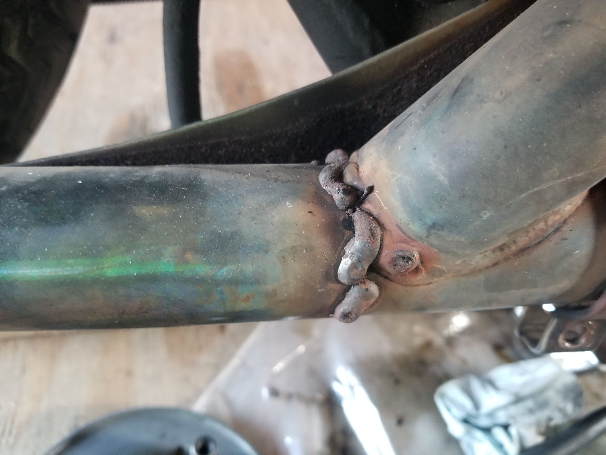

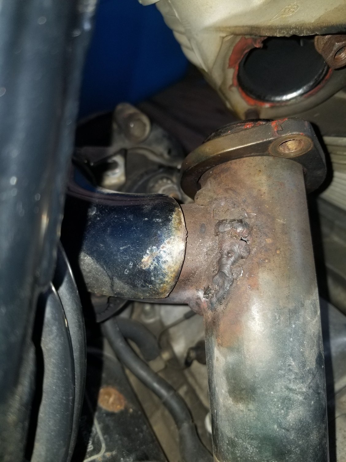

So now that it's getting back to being warmer, Im starting.to tear it down. Removed the heat shields and see crappy welds that leak and look terrible.
so I picked up some 09-13 Vance and hines dual baggers with some moto jackpot slip ons up. We will see if they with and how the crossover pipe fits with the oil filter there. They should be here next week.

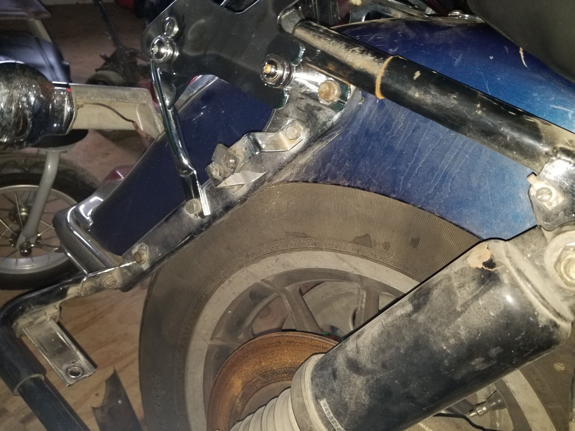

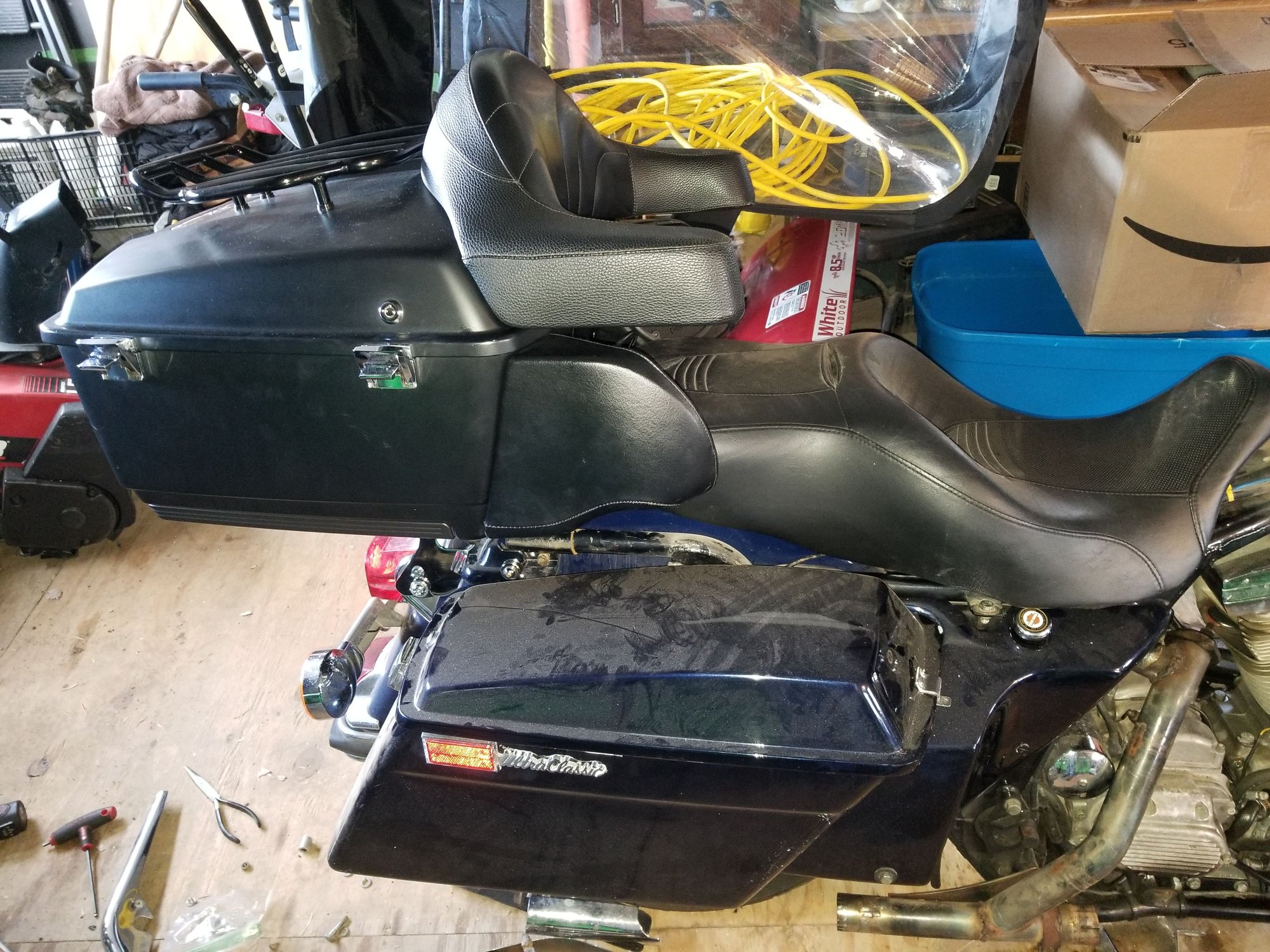

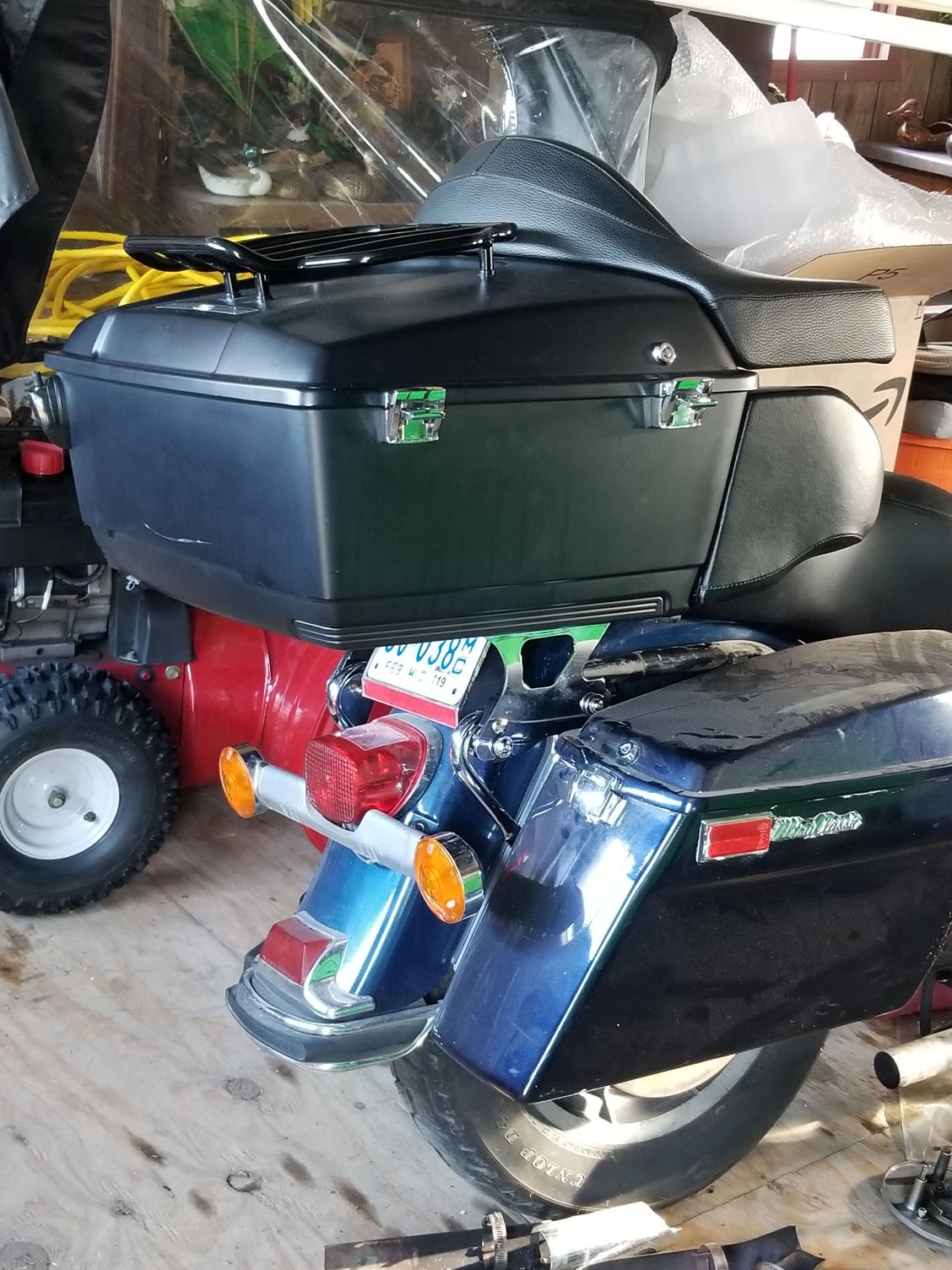

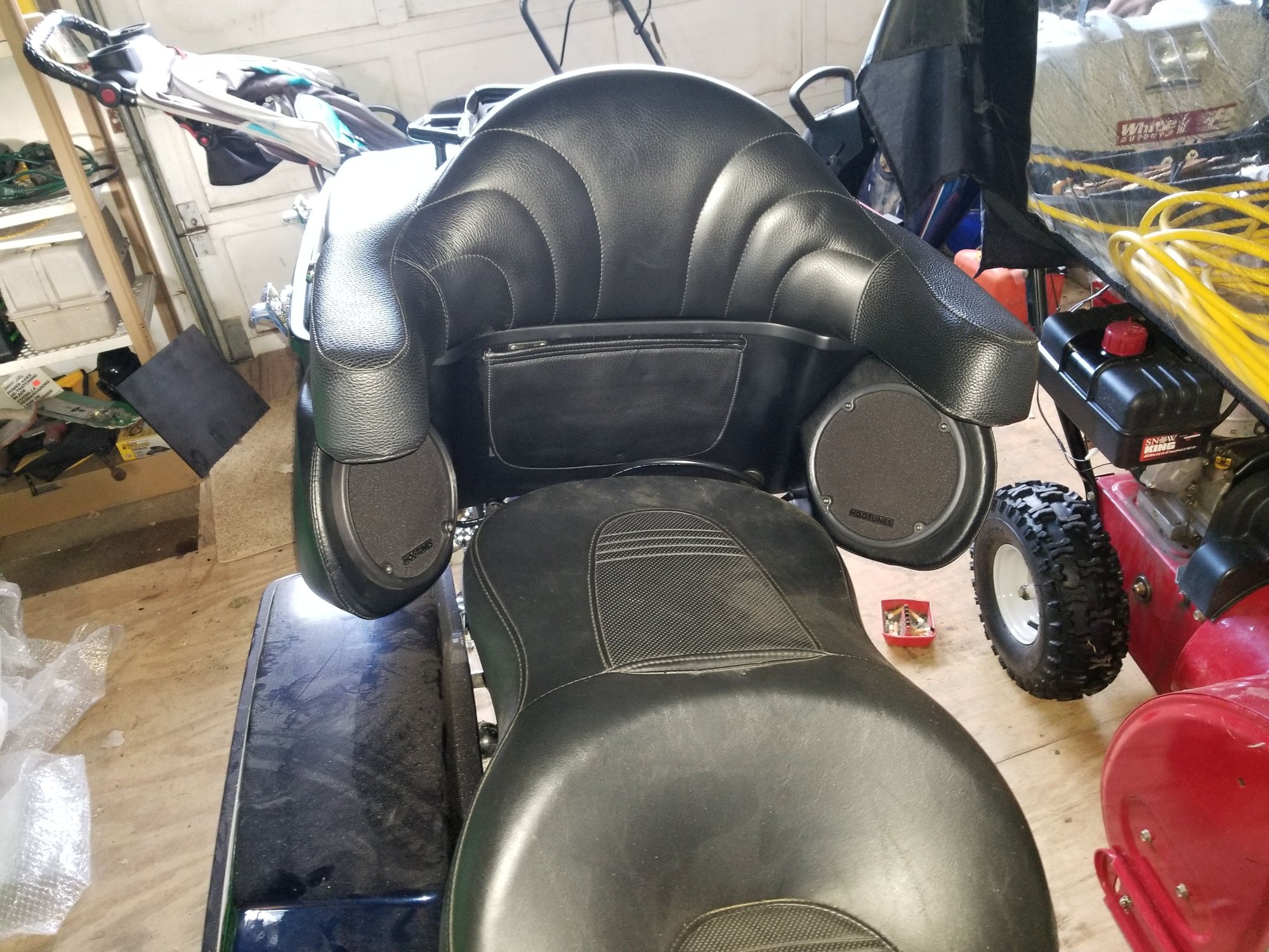

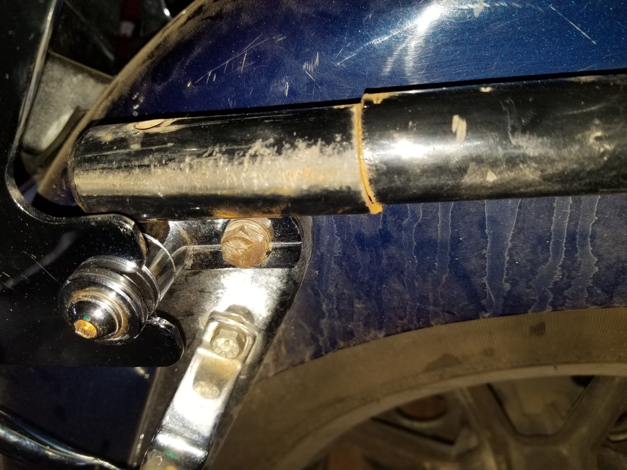

I picked up a tour pack off from a 2010 in suede black with hog tune speakers over the winter. Last monday I recieved the quick detach and mount for a 98-06 I believe.Got home from work and started to get everything installed. Took the chrome tail frame cover bracket off and what do you know one of the previous owners cut the tail frame about 4 " after the shock mount. It's a good thing no one was around at that time. Remove the other side to find the same thing. Acrew it I'm going to install everything anyways. Got everything mounted up and tried it out. It all works!!!! Now I know I need to weld the frame back together and get everything aligned but atleast I know it all fits. Had to drill new holes in the tour pack but that's not hard at all.
