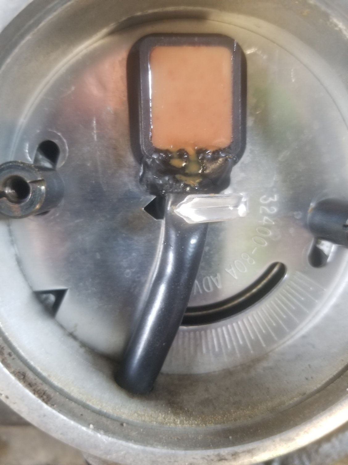

So I pulled the cover of the ignition sensor and found that it has been replaced with a drag specialties. The ignition module is still the stock one. I do see a still goo starting on the sensor. Now it's time to decide to change out the whole system since I plan on changing cams I might as well I think. Now time to decide which one.

So It never even dawned on my but my timing is pretty much fully advanced. I wonder if that's not haf the reason I was getting mid 20s for mpg. Granted most of it was interstate so that's 80 mph. So hopefully the new ignition system helps that.

I used a Crane ignition system on my 1990 Glide, however I would follow suggestions from more recent converters to use a Dyna 2000 - experts will be along pdq with more specific model details! If your bike still has the stock module there are good reasons to replace it - the Dyna goes inside the cone and replaces both module and pick-up. To comply with EPA regulations the stock ignition modifies ignition timing away from optimum, so you should get a much sweeter running bike.

I was leaning towards the 2000. Seem to have pretty good results from what I can find here.

Nice Bike! Looking forward to your progress. You may also want to consider the Ultima 53-644 ignition, its a copy of the Dynatec 2000. They work great and the price is right. Don't use the coil that comes with the kit though
the only differences that I have read is in the curves. the ultima has more aggressive curves if I remember correctly. I need to do a little more research on it.
