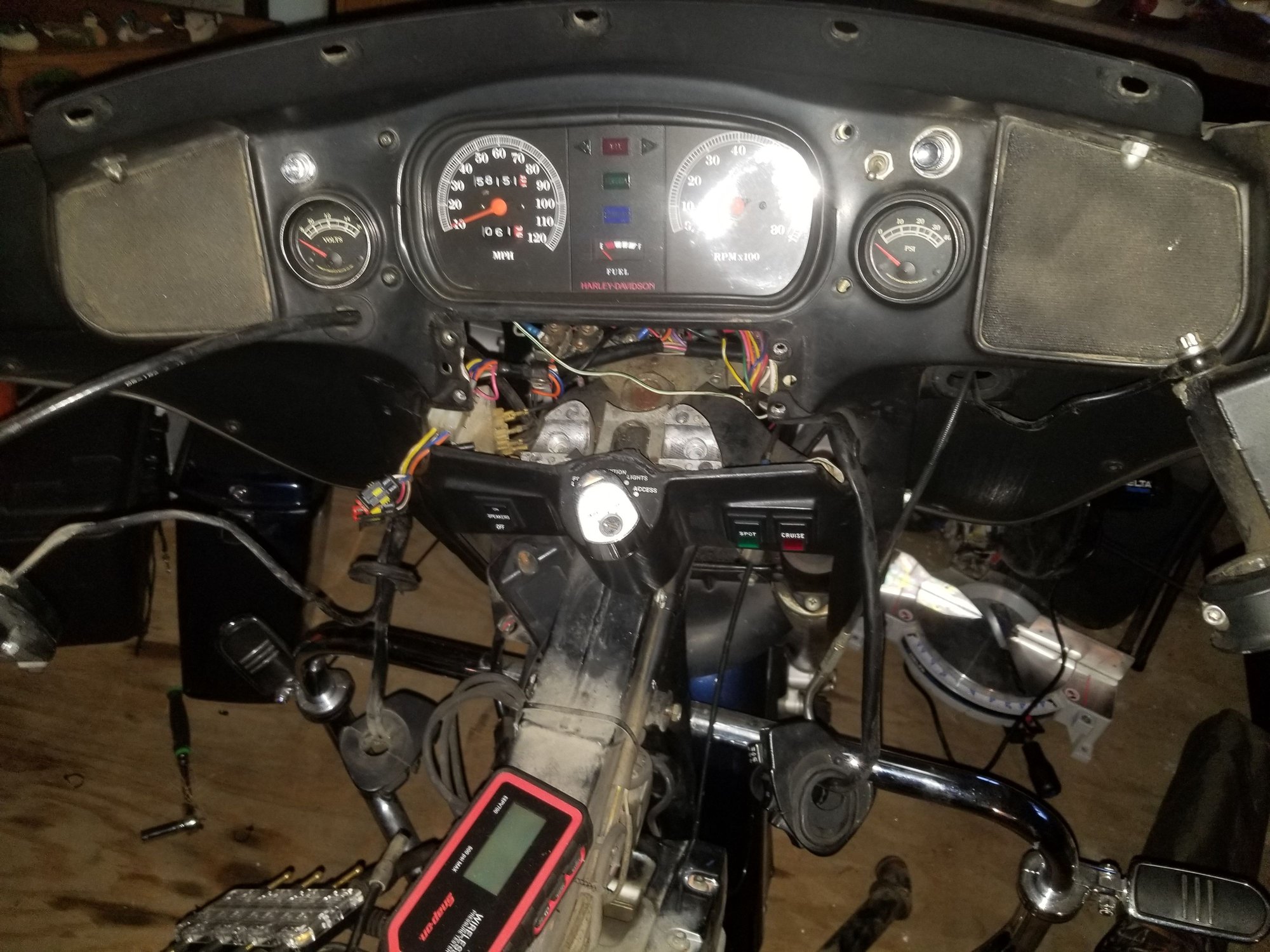

Disappointing for sure! I suspect you need to order bars for an FLHT. FLHT bars will be correct to work with a fairing. can you post a pic of the guage side of your inner fairing? It will help us tell what years it is from.

snapped a picture quick of the inner. Hopefully that helps. I wish the guy would of listened to me when I said I needed bagger bars but oh well. I called them today and asked if the would split the difference between the 2 bars so I'd give them 20 more and the would give me 20 off. Hopefully they call back tomorrow because he said he had to talk to the boss.
