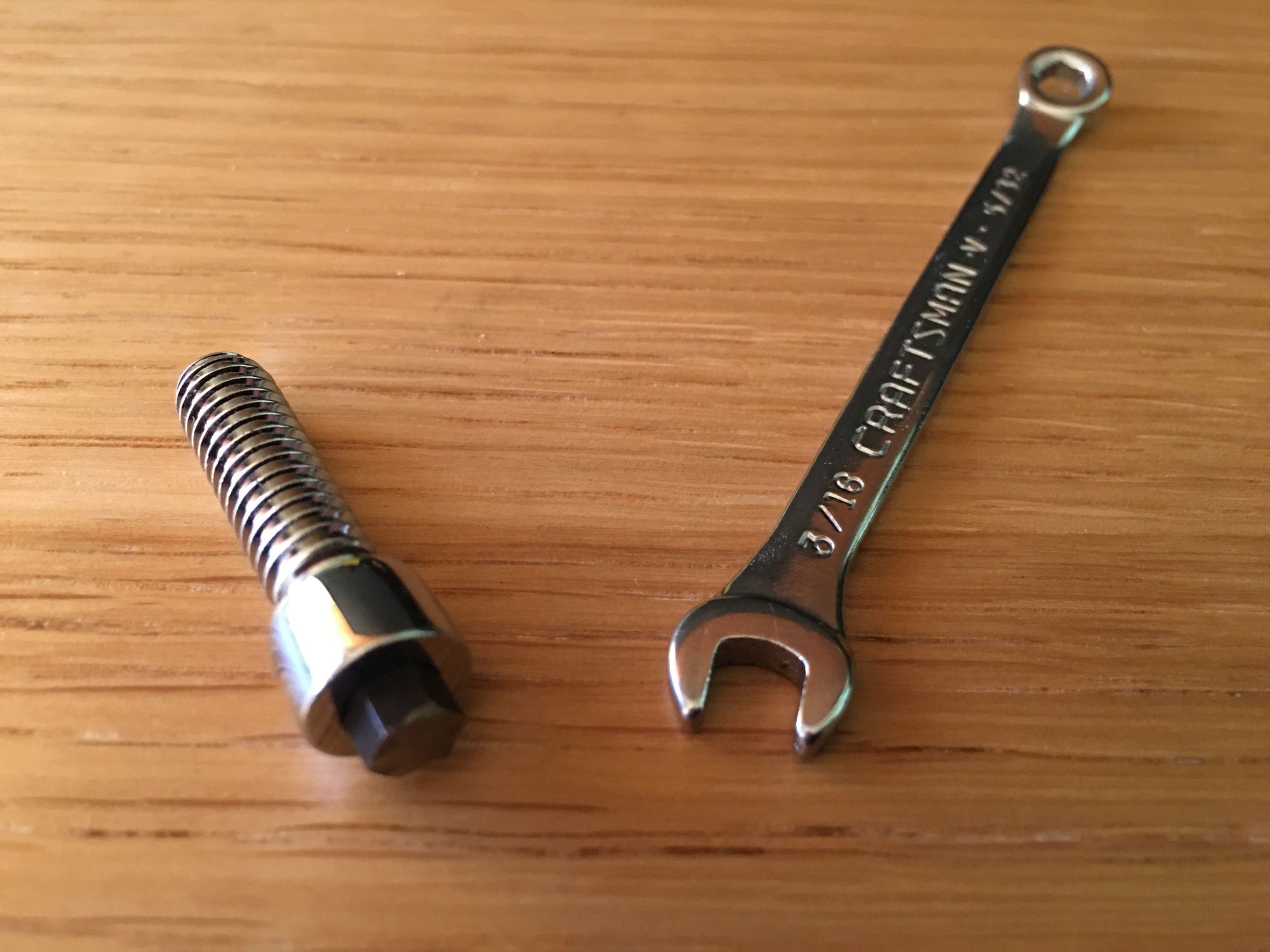

So here's what I did. I cut a 1/4" section off of an old 3/16" Allen wrench, tucked it into the hex cap screw, then used a 3/16" open end wrench to tighten it down on the rocker cover. Worked like a charm!
That's what I did to tighten the intake to head bolts.
