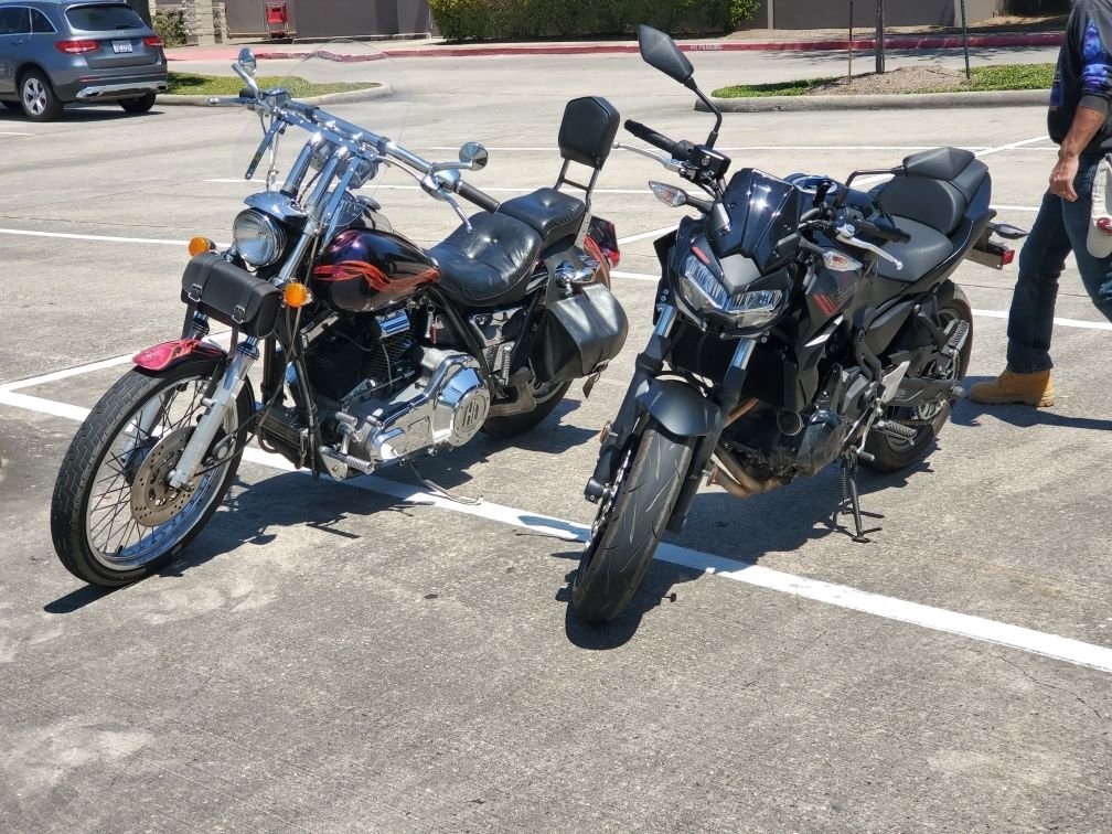

I used this on mine and really like it, fits well and looks good, good price and built well, can get in smoked or clear. A pic of it on my bike https://www.ebay.com/itm/Large-19-x1....c100005.m1851
