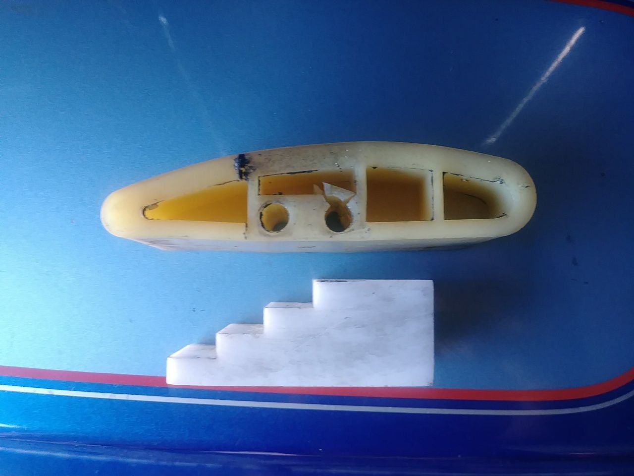

You can also use other items laying around such as primary chain adjuster block, rubber door stop, or a good ole rag will do to jam up the chain and sprockets. Jam bars are nice for home, but I keep a triangular door stopper in the saddlebag. You could make one of those tools for cheap. Go to the Dollar store and buy a cutting board. Cut pieces and staggered glue them together, or just order one.

FWIW I've used a small block of wood (short piece of 2x4) that I had laying around.
As you say just about anything will do in a pinch.
I still prefer a small piece of bar stock that if needed is easily fit inside a saddle bag.
