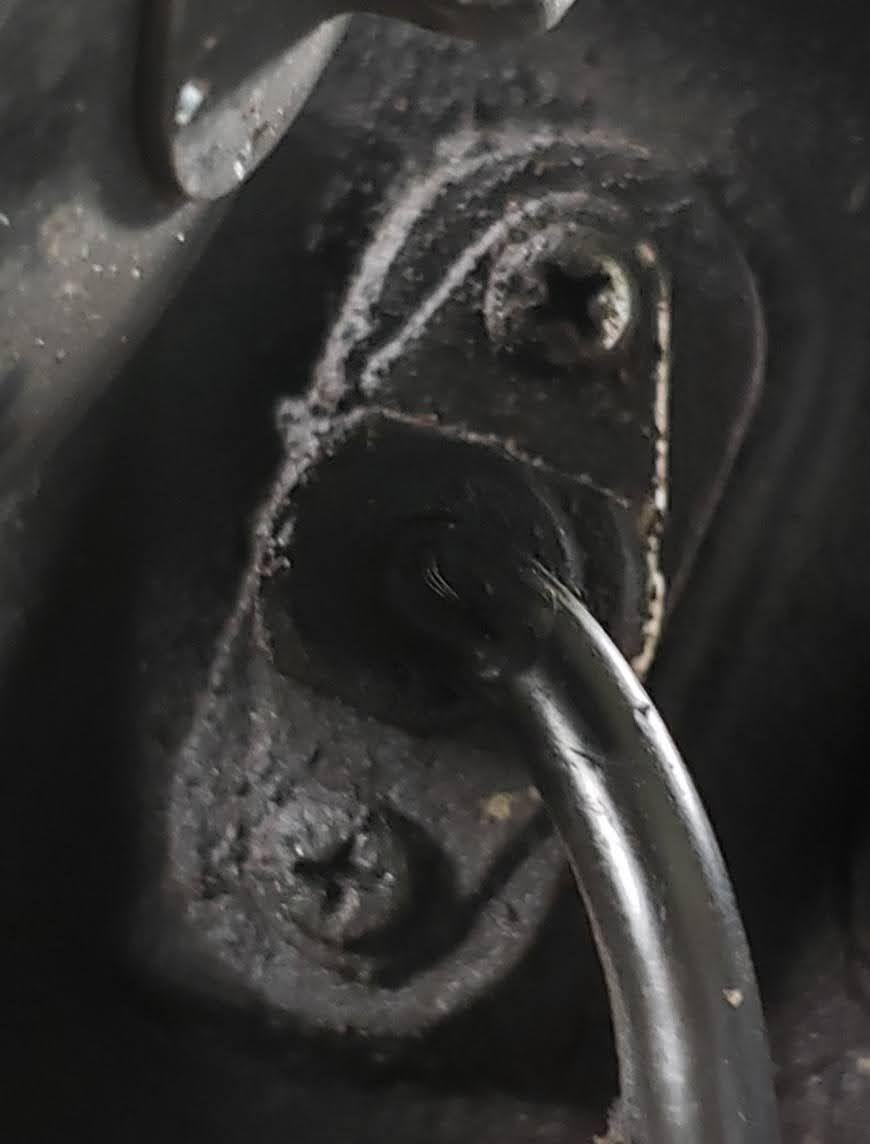

I may have found the problem. At least I did find something to fix.Could these exposed wired on crank position sensor cause the type problem I described?
Old Sep 10, 2020 | 09:27 AM
86glider's Avatar
86glider
Posts: 1,528
Likes: 933
From: Long Island
oh yeah
