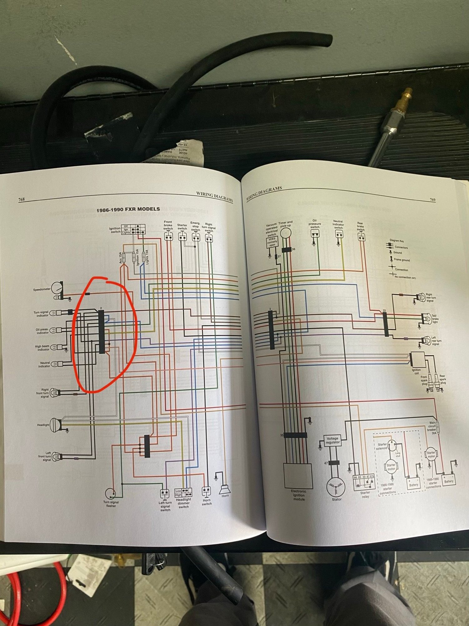

Also might be worth noting the wiring is not stock on this bike. It has 96+ controls, and the connector in the back of the headlight that would have dash indicator lights and turn signals has been removed and the bike doesn’t have these luxuries anyways.

With the negative terminal disconnected and the key on, but only with the key on, I have continuity from the positive terminal to my inner primary. This proves it’s a short on a switched wire correct?

Upon following further there is only continuity when the wire from main breaker to positive terminal is connected

And with the regulator ground disconnected it has continuity to the positive terminal as well. Maybe I’m chasing my tail on this one but there shouldn’t be any reading from positive to the grounds correct?
Ya think?
Now tell us, has the electrical system worked properly since the new switches were installed?
