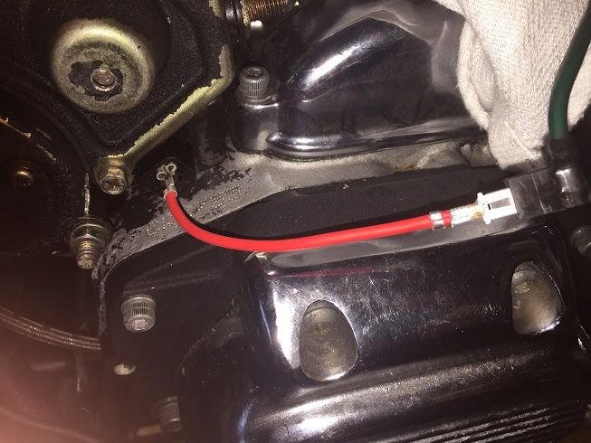

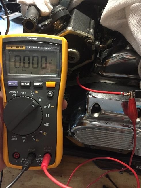

When testing the signal circuit (the green wire between the starter relay and the solenoid) for voltage, it should still be connected so that the circuit is under a load (actually, all circuits should be tested while under a load).
Leave the wire connected, and read the voltage when pressing the start button.
You can put the probe of your meter into the connector at the relay green wire terminal, or slide the connector off just enough to expose the blade terminals on the relay.
If you can`t get at the relay connector, you can make up a little jumper wire which allows you to keep the circuit connected and gives you a place to connect your voltmeter:
Jumper wire installed
With this jumper wire installed, you can test the signal circuit while it is under a load.
I did this as well and it dropped from 13.x volts directly to 0 when tripping the breaker
