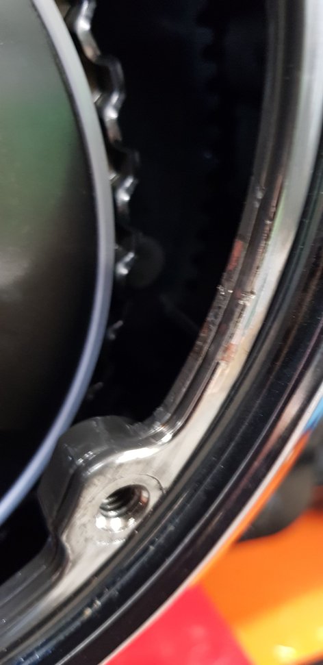

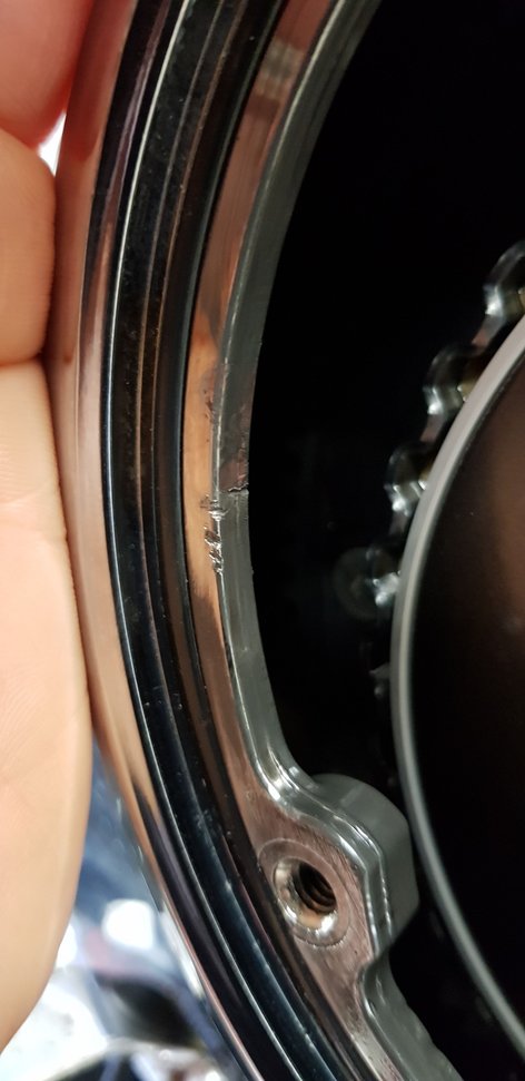

Looks like I have an 18* ramp already in there (don't know if that's stock or not) and seems like some knuckleheads have been wrenching in the primary side by the looks of the gouges in the sides of the case.

Don't know what the gouges could be from. Maybe former owner tried to pull the case without removing the center screws? Or dropped something inside and went fishing.
