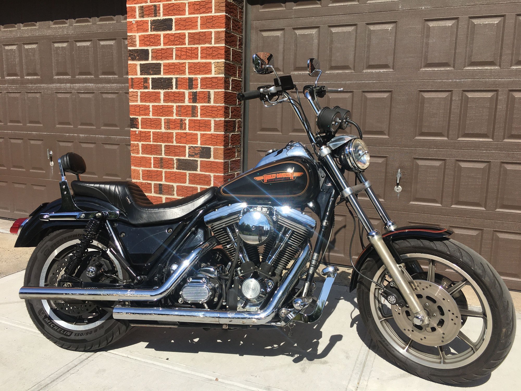

I was on a group ride last night when I saw a bright flash and my bike died, luckily I was able to coast over to the shoulder in traffic and get it to start up again. Everything seemed fine except all four turn signals just stay solid on when I try to use them but they still function properly as hazard lights.... once I got home I found out the low beam on my headlight was out (which probably explains the flash). I'm riding a '93 FXR that just had some pretty extensive engine work done and I know some of the wiring got cut and resoldered when the oil tank was pulled. I'm just looking for pointers on where to start with this. Before you ask, I have LED turn signals front and rear but have a Custom Dynamics load equalizer installed and have never had a problem since I put it in, doubt that's the issue. Looking at the service manual it seems like MAYBE one of the 15A circuit breakers could have gone? If anyone has experience with a similar problem let me know what you figured out, it'd be much appreciated.
