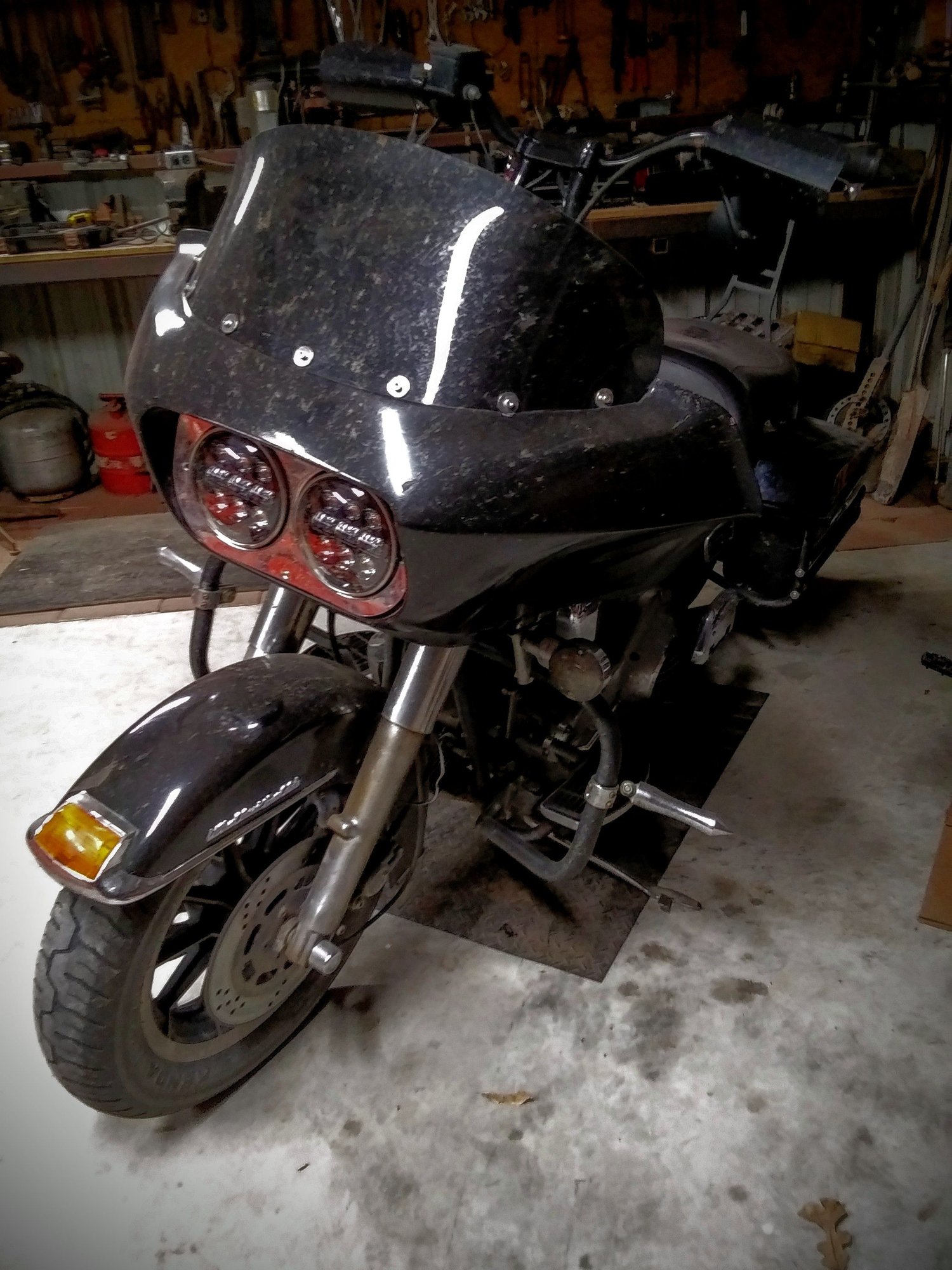

Lots of people want to confuse the FLT With the later FLTR, Tour Glide vs Road Glide. The fixed fairing looks similar from a distance so it's an easy mistake but they are different animals, especially concerning the headlight mounting. HD and aftermarket make a complete plug n play unit for the Road Glide, but the Tour Glide uses the H4467 sealed beam like early FXs and Sportsters.
Rizzo, here's the FLT mounting bucket. Easy to see why LEDs aren't in many Tour Glides.
These are pirated pics. If you look closely, the inner bucket, the part that adjusts has only a about a 2" hole in the center for the electrical plug and form fits very closely to the back of the bulb.
So, it'd take a lot of careful cutting to even get a low profile Led in there and the whole assembly will be butchered pretty bad, but do-able I guess. I gave up on the idea since saving amps was my intent and Leds pull more than the sealed beams. These assemblies are occasionally available on ebay but are usually in worse shape than these, and even the ratty ones aren't cheap.
No confusion, I owned a FLT and understand they are different. That being said, jonnycando confirmed that the back of the bucket can be removed and the LED's installed successfully.

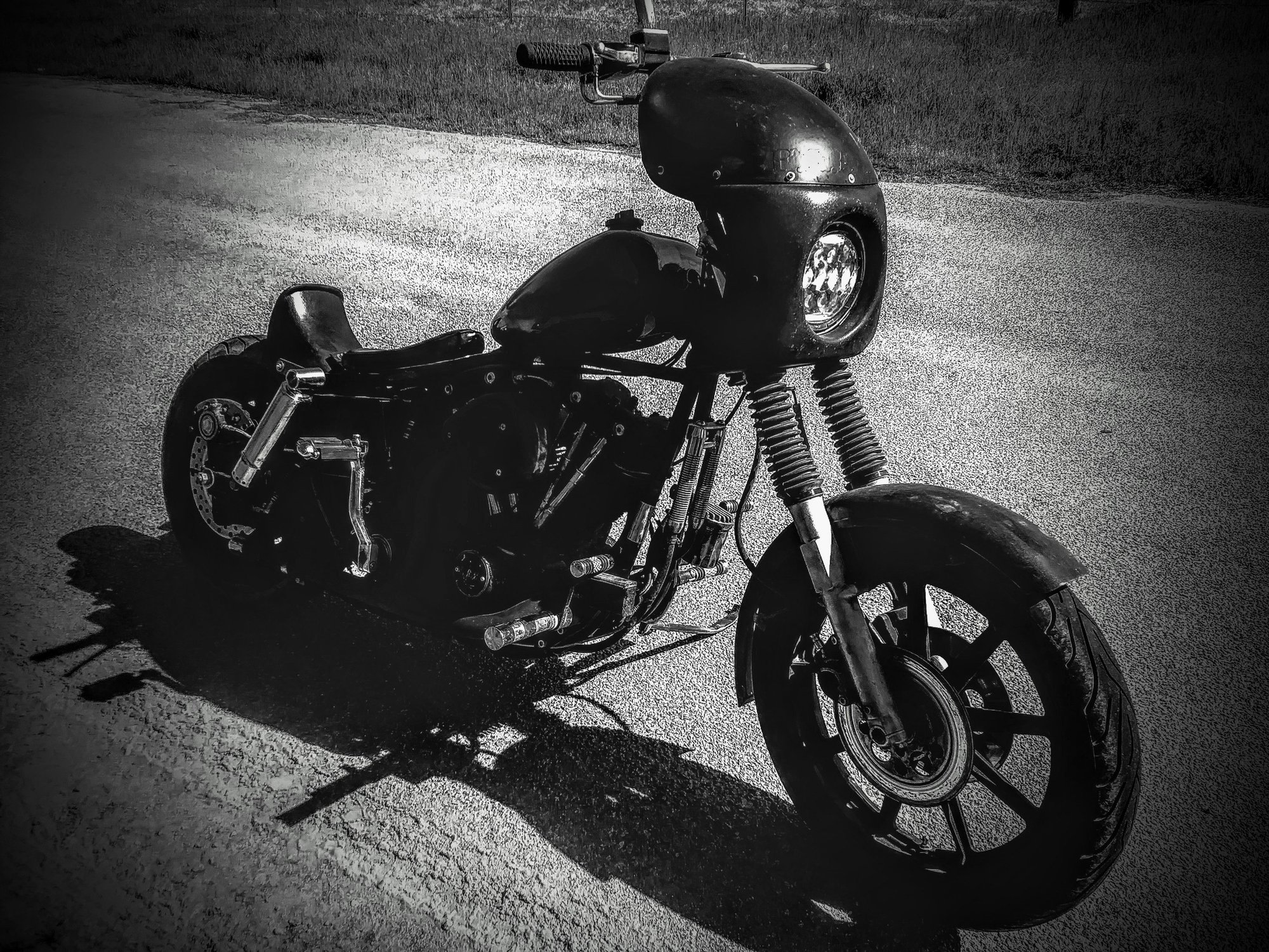

So I've ran leds in my shovel for the last 3 yrs and been really happy with them.
Dont know why ive never thought of throwing them in the TG but this thread got me itching to do so. I live in the sticks in southern Oklahoma but today I decided to go to my favorite somewhat local Indy and pick up a set. I picked out the shallowest set they had and actually they where smaller than the oem bulb. Room to spare.
Anyway, stoked with the look and very pleased with the brightness/pattern.
Many thanks to the OP for lighting (lol) a fire under my ***

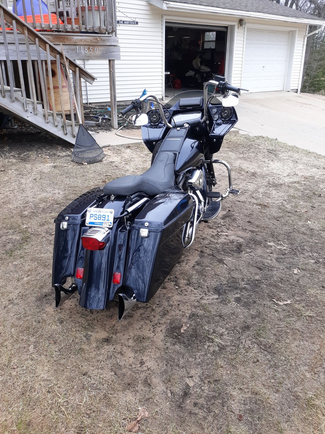

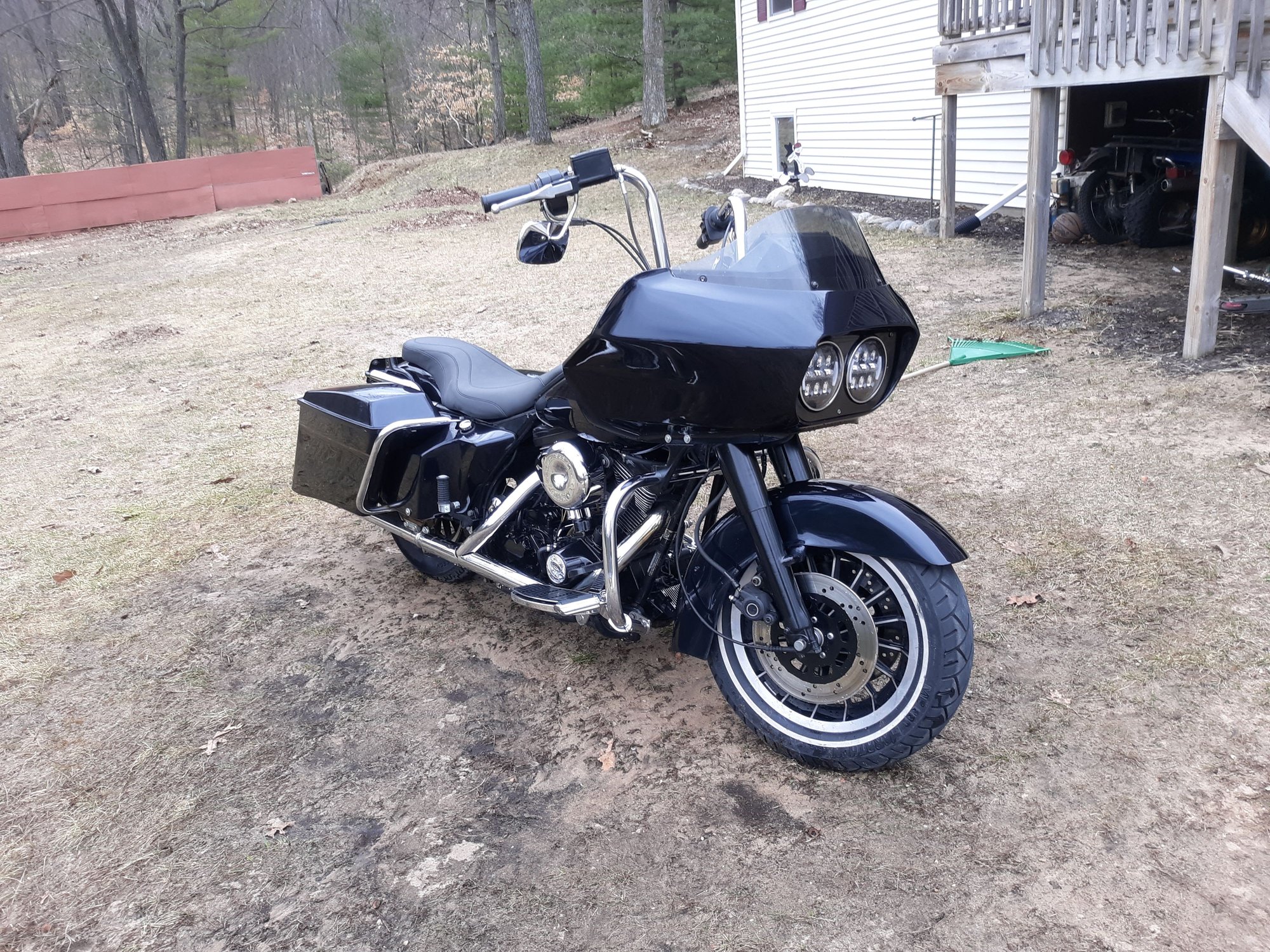

Finally got the bike out to ride it and i am loving it. Just a few small things to tend to at later dates, but its done for now.

Looks great!

Nice job! How does it ride?

I’m impressed. wow that bike came out great!! I always liked the handling and protection of that fairing. You took out the fugly, nice job. I put an ev13, single fire ign. and an s&s in mine and never ran better.Watch for the pesky loose front pulley too. What seat is that?
