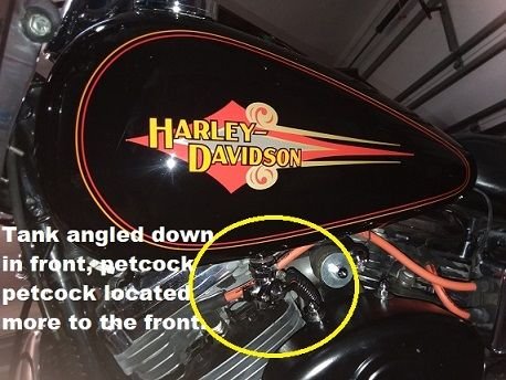

The only effect petcock location on a tank may have is how much gas you'll be able to get out of the tank. Petcock location is determined by the overall shape of the tank, how it's designed to sit on the frame and what may be in the way underneath it. Examples:
Savvy?
