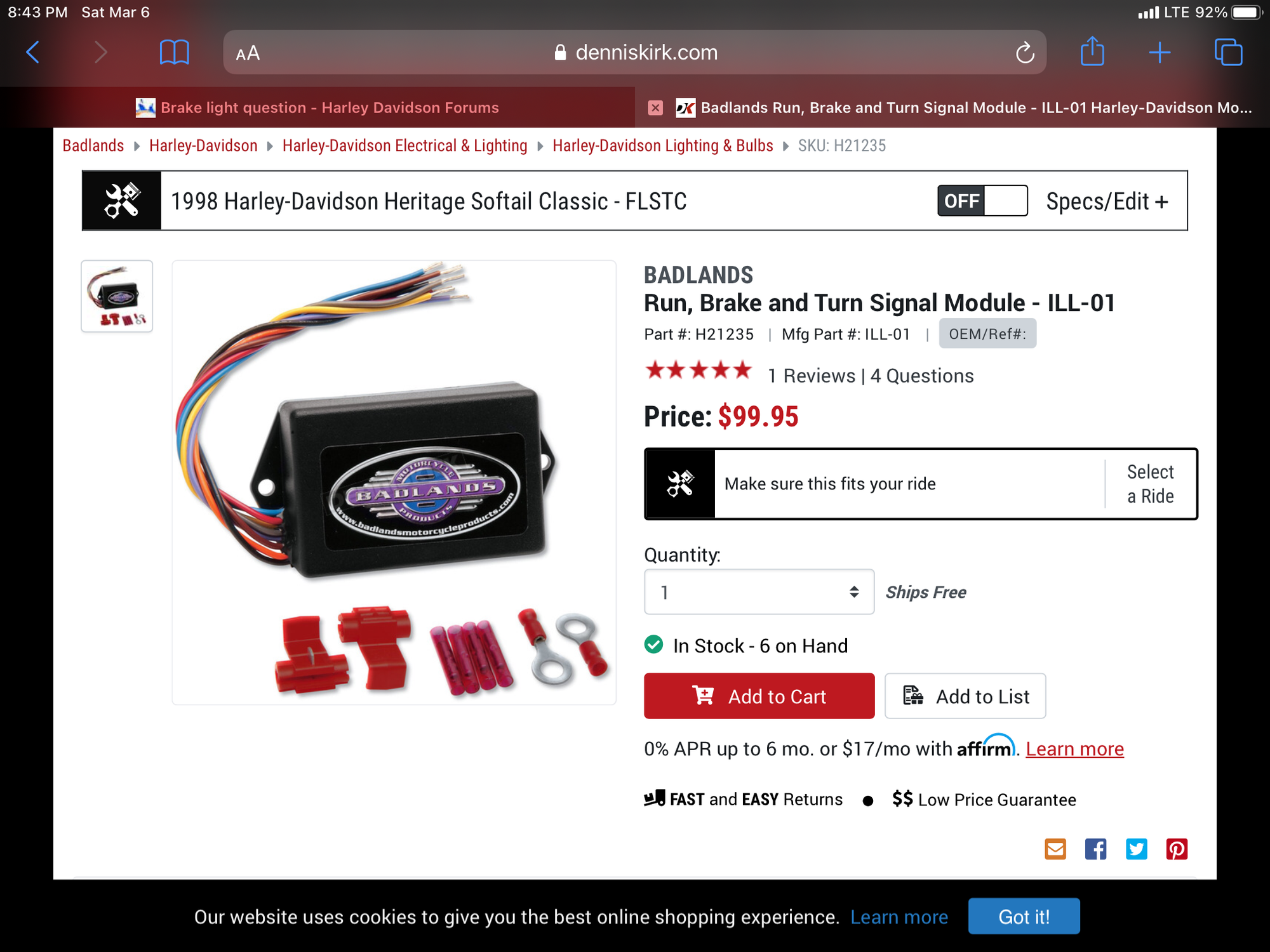

Is there a way to wire these turn signals as brake lights and still function as turn signals?
there’s only two wires.

I installed a Badlands module to do exactly that on my bikes.

^^^ That's the easiest way, I did mine with relays, but I'm a wiring geek.

Was it a Kury? Badlands has a pretty good reputation for modules. Kury, not so much.
this what you’re talking about?
unfortunately I’m not a wiring geek.
