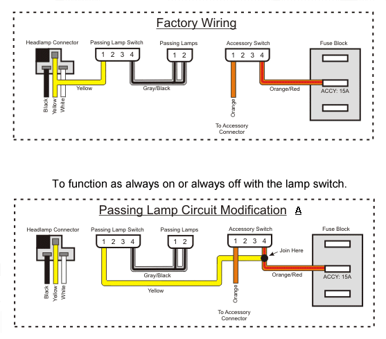

I often wonder why the Driving/passing lamps are made to turn off when switched to high beam. 1991 Ultra. That being said, I would like to change that. I have a wiring diagram and do not see where the driving lamps run through a relay?
Is there any reason why I should not modify so that my driving lights work on low AND Hi Beam? Has anyone before me done this and can save me some steps? Just thought that I would ask before getting all serious.
Thanks .... Frank

maybe this will help ...

A simple relay in the bucket will fix this.
Harley also sells a plug and play kit it can be found on the internet too.
Plus as an after thought you should use LEDs to reduce the load on the wiring
or you'll need a new fused circuit.

I did this on my '95 heritage by simply running a hot lead to one side of the switch that controls the driving lamps.
I'm still running incandescent lights and have had it in this configuration since '09 without problems.
