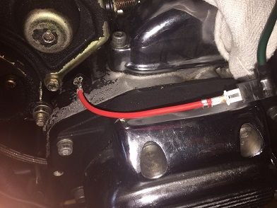

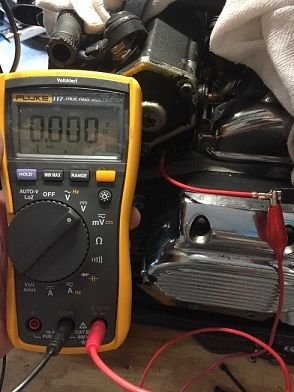

Read the voltage (when starter button is pressed) at the wire that runs between the starter relay and the starter solenoid.
Don`t disconnect the wire, the circuit must be under load.
On some bikes there is no easy way to do this with the wire connected, if so you can make up a jumper wire with an exposed terminal that you can connect to the voltmeter.
