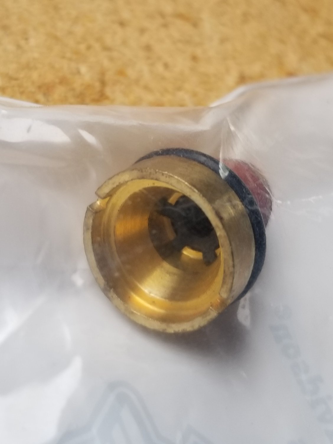

What thread problem on tank? The fuel fitting are very 'special" in the tank, check valves threaded into (within) the threaded holes, above the line fittings when installed

the return line is cross threading. could be my own doing but i did not want to go all the way in with it feeling strange. i ordered a tap and die set to get a better feel of whats going on.

I had to work on my tank and after removal i found a check valve loose in the threaded hole. This is a RARE outlet check valve i am hoarding , i thought mine was in trouble but made it work. Simple thin stock tool to install using the little notches.

Used a thread chaser and a die fixed the damaged start to the tread holes and got them back together. No leaks yet... hope it stays that way. I'm going to order the aftermarket lines and be ready to go.. where did you get the incert piece. I had to reinstall one of mine. I should order those too.
