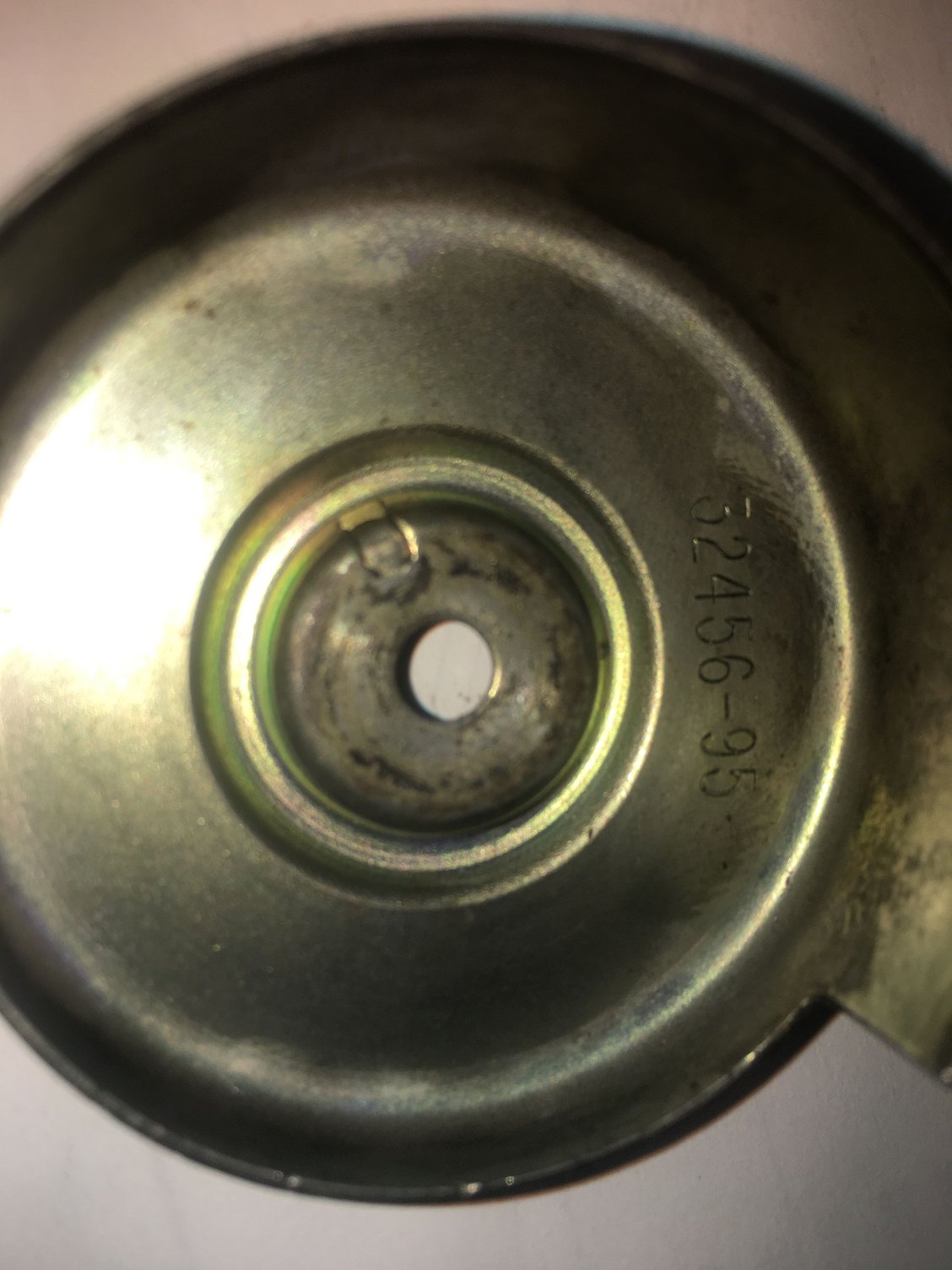

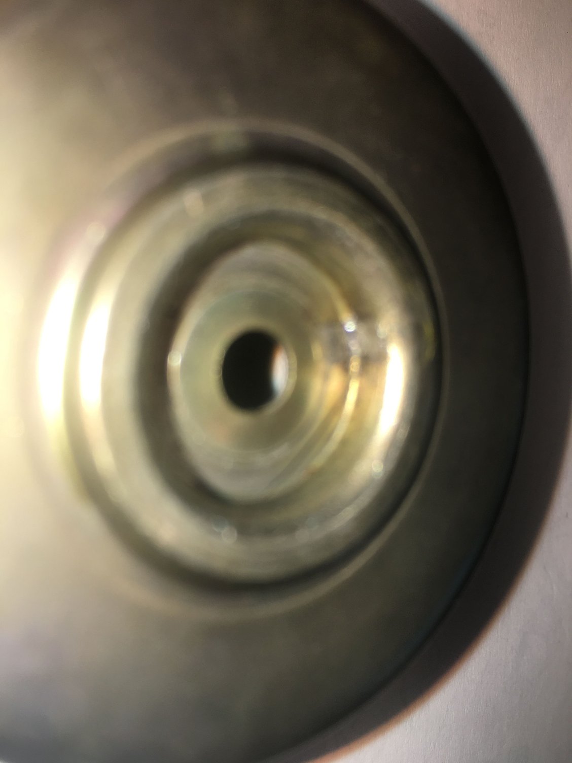

Buddy of mine bought a 1997 EFI Road King. He bought it cheap, because the previous owner couldn’t get it started.
I’ve checked the usual basics…..first
Motor turns, but it seems as if the timing was off. I took the ignition cup out….the notch is missing/worn out. I’ve reinstalled it where the notch would be….still no start.
Anyone else have the cup get screwed up?

I have zero experience on fuel infected bikes, but the cup was probably tightened down out of the cam notch which flattened the dimple. That's about the only way that can happen - they don't wear out. I'd replace it, especially since it's EFI and figure they are finicky. Injected bikes do use a different timing cup than carbed bikes.
Maybe some of the others with EFI experience can help you out on the rest of the no start issue.

It’s a long shot, check timing marks under the nose cone.You never know what the p.o. may have done.

Below is a cut and paste that may help you.
Note:
You have the correct cup in picture if bike is fuel injected BUT keep in mind that cam sensor is NOT timed.

I would start with a new Mm efi timing cup and get that so you know that can be mounted correctly. Check the cam sensor to see that it is not "melting out". Look at the cam sensor backing plate IIRC, my mmefi has both slotted holes and 2 single holes.
On MM efi systems the 2 fixed single holes are the ones to use, slotted holes are strictly for carbed bikes. That puts the cam position sensor in exactly the correct position related to timing.
