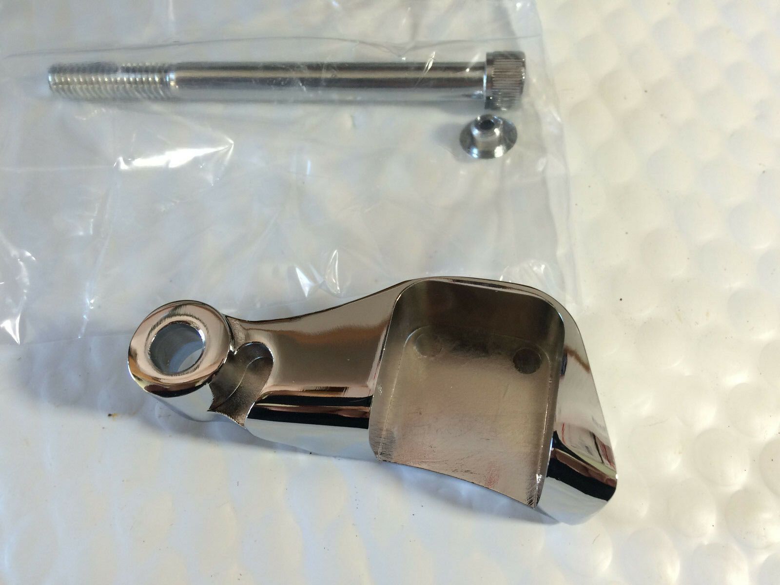

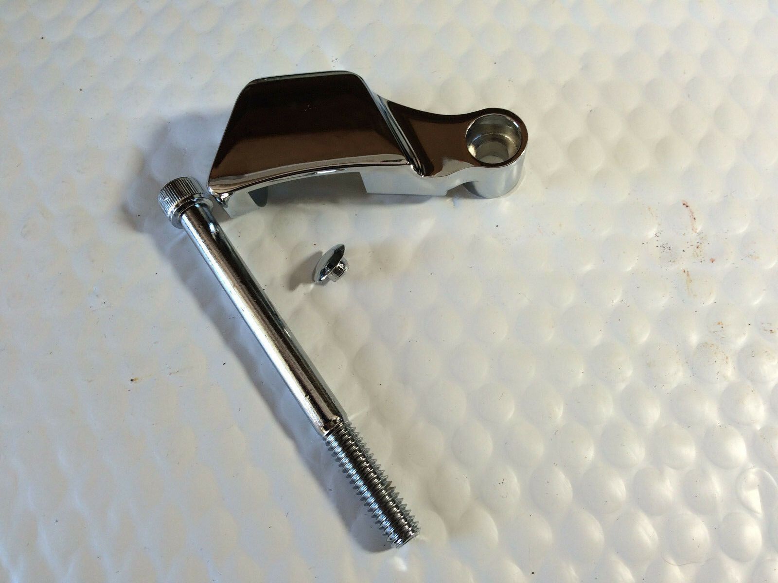

This style retainer works great, captures rubber connector snug.

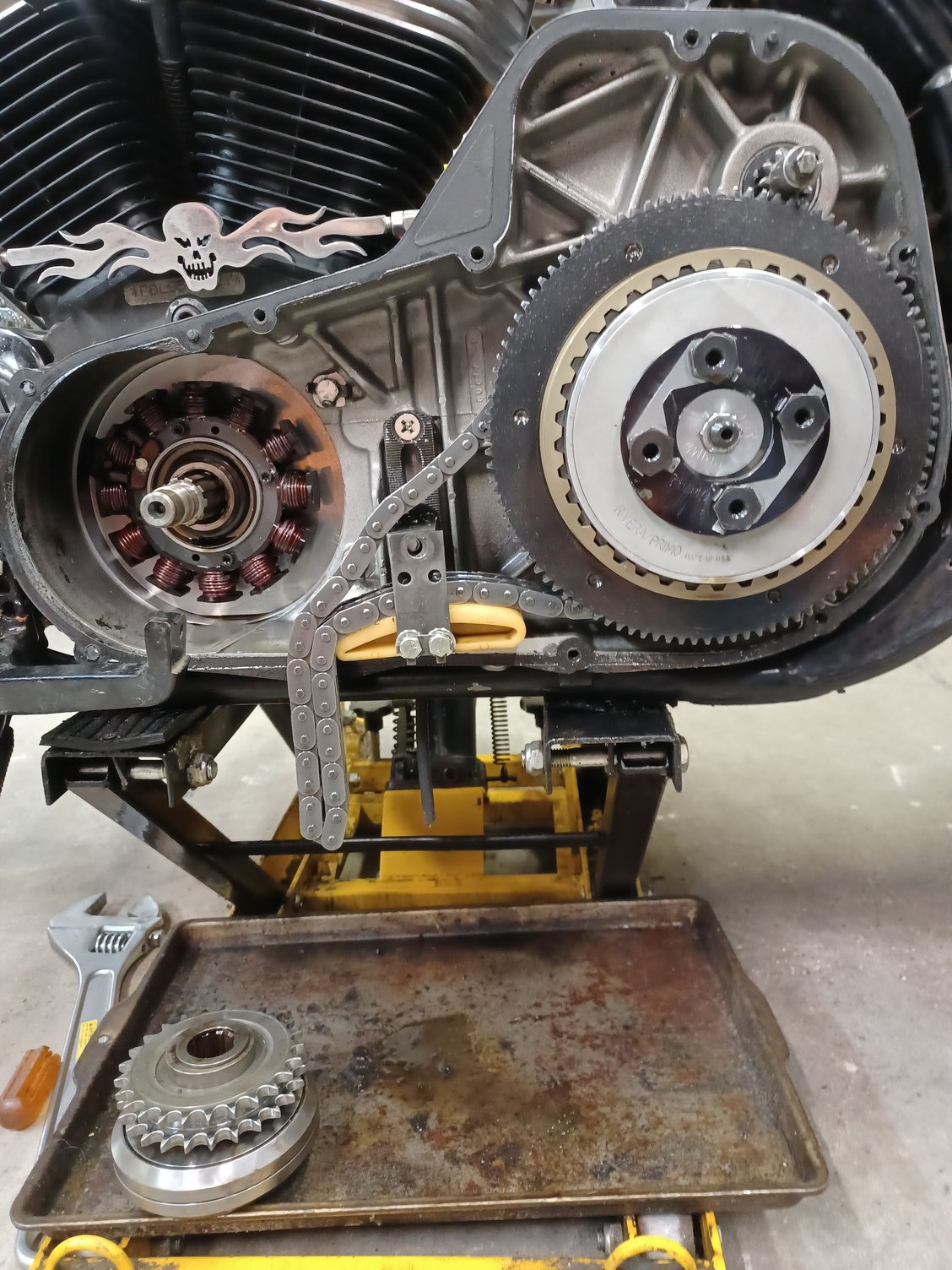

Well. The Harley gods are helping me out so far. I was able to pull the compensator sprocket without having to pull the clutch. I am going to do like ya'll say seal it off good with sealant. I might even use the retainer that Schex showed. A touch of chrome never hurt either. Should last another 26 years. That means I will still riding it when I am 93 years old.
