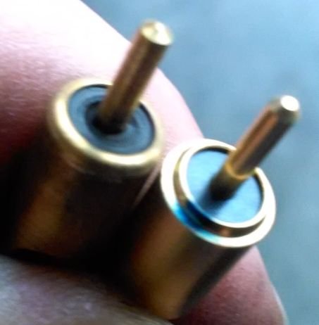

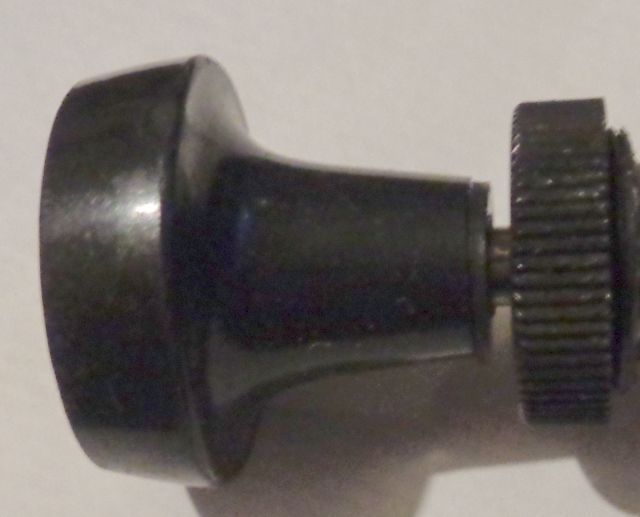

With the cable/valve assembled to the carburetor and the drag adjustment nut (outer) loose enough for the **** to return to the closed position on it's own (don't pull it out and let it snap closed) there should be 1/16 - 1/8" free space between the **** and outer nut. If there's more, something isn't letting the valve seat. If it goes all the way, may be a worn valve.
Take the enricher (choke) cable out at the body. Remove the valve on the end, clean it and check the cable for binding. The valve should easily slide thru that bore. If the cable or valve itself is binding in any way so the valve cannot fully seat, that will cause a high idle problem. Replace any suspect parts.
Cable - 29229-88A
Valve - 27583-88
Left valve is old style and suspect. Right valve is new.
