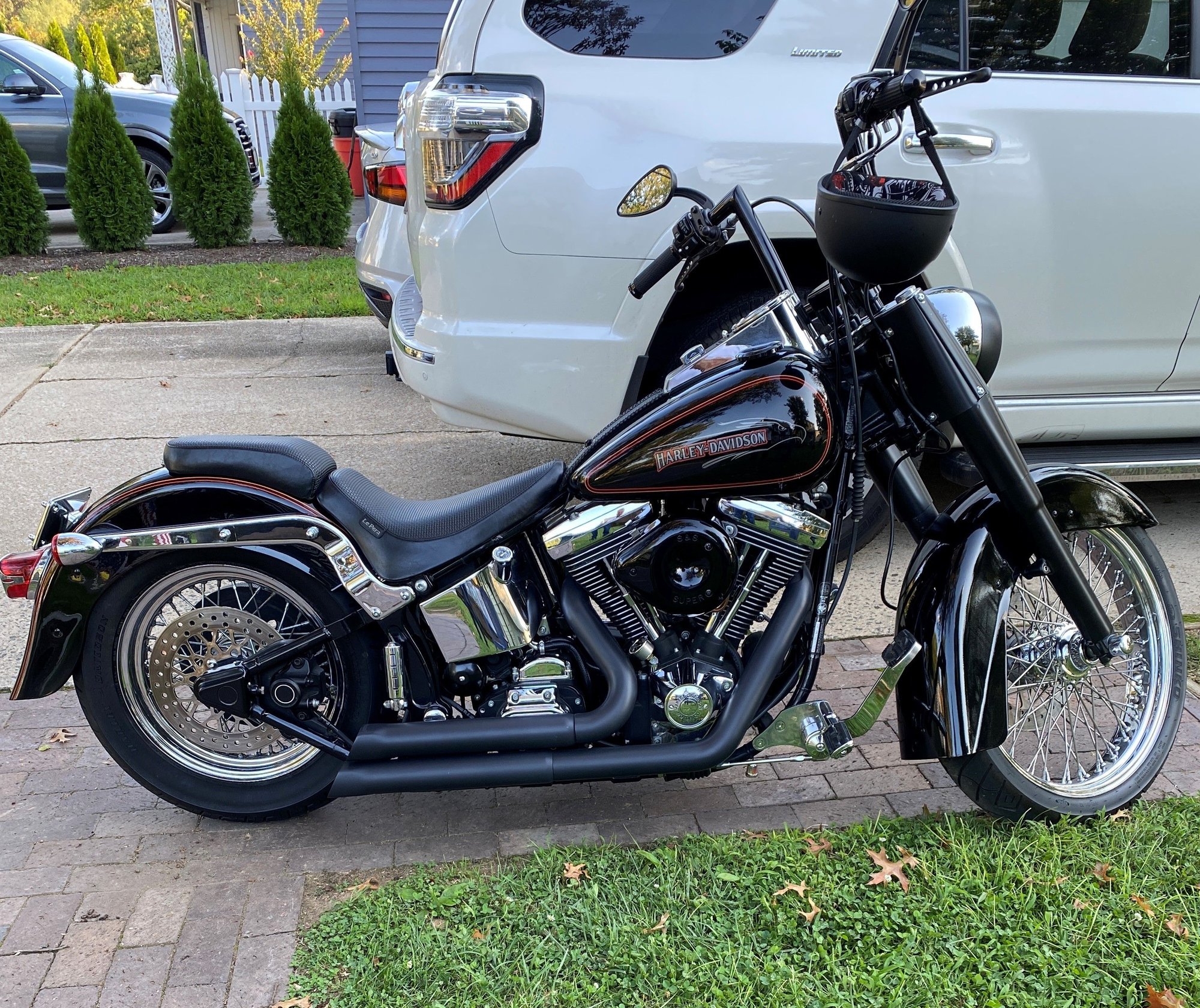

Rob, do you have a pic of the mc? And what year Dyna?
think the forwards and master and line all came off 97 dyna the frame mount should already be on your bike

pic of my bike ? sure

Was that supposed to say "got rid of the floor boards" If so what forwards did you use?
Modified stock ones, basically kicked my pegs forward 2" and reworked my brake pedal to use the old S curved style from a panhead. lays the arm down nicely so you have lift you foot almost to the air cleaner like most shovel setups.
My dragging issues were always with the pipes, used to run turnouts and I would grind the bottom edges off the bells regular, also slapped the kickstand into the primary a few times, busted 2 outers this way. Floorboards didn't last 6 months before I tossed them, even tried the old smaller oval style from the pan days. Should raised the old girl long before I did handles and rides better overall and I can get stupid in the canyons.
May have a complete chromed billet forward setup you may be interested in later. Picked it up when I was at that Indian dealership, puts my feet just a bit to far forward for my liking on the shovel, designed for the softail frames, think the numbers come out to 3" extended or a hair more.
