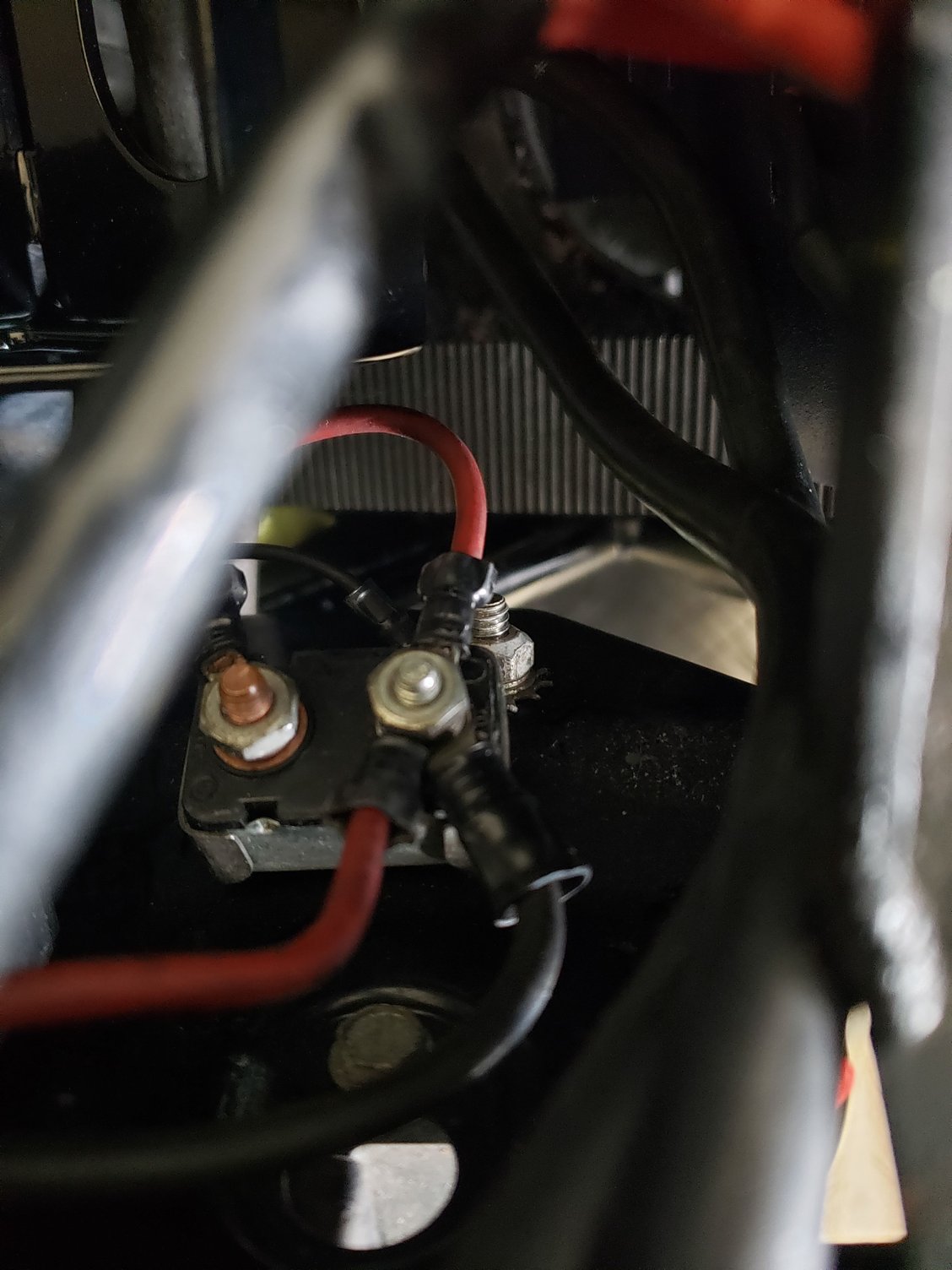

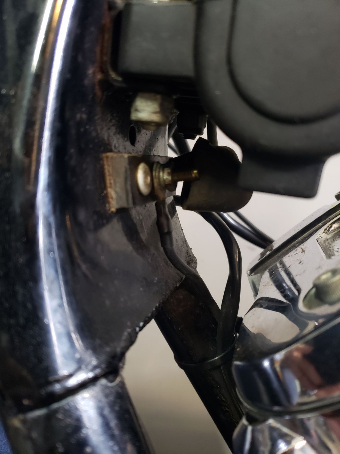

Guys, I am currently upgrading my charging system. I bought the 32amp Compu Fire system. I understand cycle electric is the go to, but for right now, the budget said $200 for a compu fire.
Right now there is only 1 wire from the regulator, and looks like it goes to ground near the coil? The compufire has two wires. Any idea on where the second goes to? Thanks in advance.

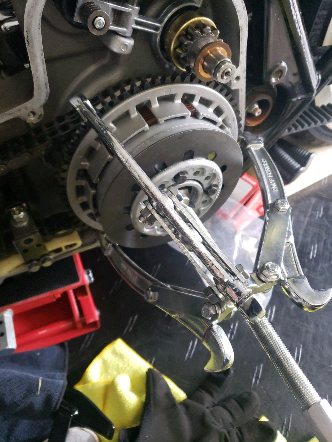

Also, what a pain in the dick to get the clutch side off. Need to get a clutch puller. Didnt realize this year was different from previous years.

There should be 4 wires on the regulator.. 2 of them are the field connector for the stator one is to the main breaker (power from battery) and the 4 th is the ground..
As for the clutch basket, the trans has a tapered shaft so yeah a puller is necessary..

This is the one wire from the regulator. Then off of that is goes through the harness to the breaker.

Figure out the wiring but hung up on getting this thing off. Jesus its on there. I dont wanna crank down too hard.
