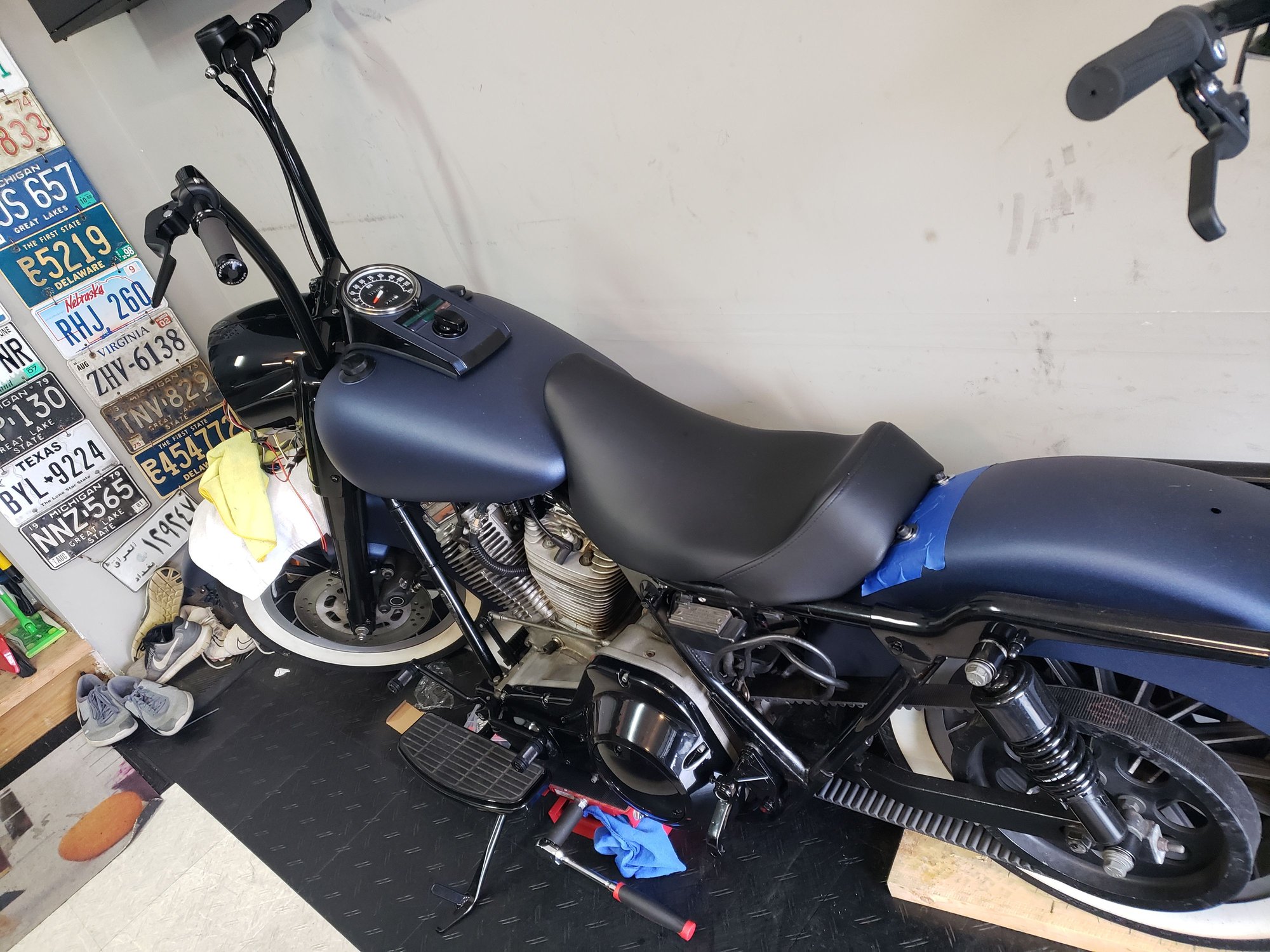

Got bad news... trying to install my headlight i noticed something wasn't right. The nacelle somehow when PC got FUBAR'd. It went almost into an oval shape. I did not notice until I went to install the headlight bracket. Kinda annoyed about it since new ones are pricey.
don't mind the wiring. Lots to clean up when I install the tank.

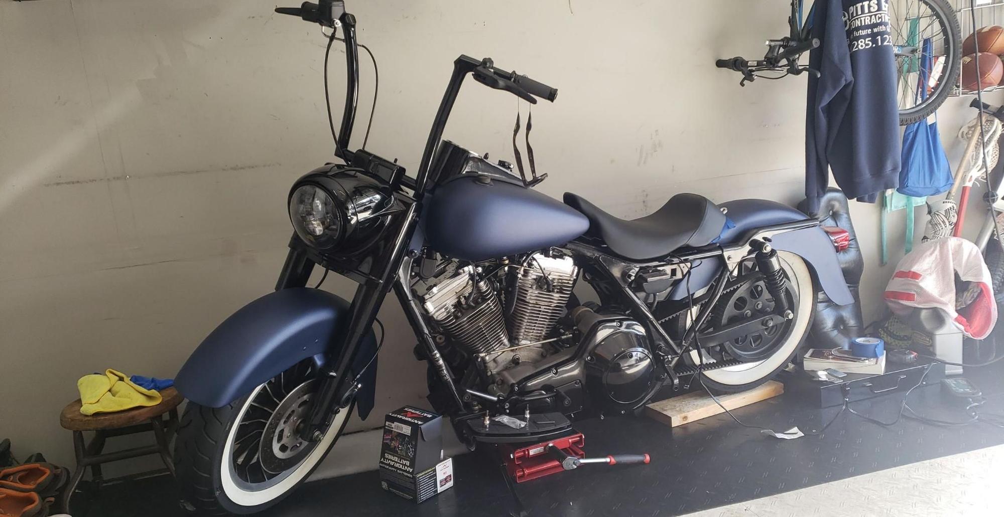

I had to make a custom bracket for the solo seat. Got the Anti Gravity battery in. Amazing how light they are. Waiting on clutch cable and adjustment. Pretty much there.

I did not end up relining the tank. I went the Evaporust route and it came out great. Flushed it really well and filled it with gas immediately. Added a inline filter as well.
Those Handlebar controls are $300 from Dennis Kirk and J&P cycles. I found them on Ebay still in the box for $40.
The front brake calipers were a breeze to rebuild. I wish all brake calipers were that way.
I ended up using a one piece riser from a late model touring. Grinded off a tab and PC it. Works great. The regular rubber bushings were not cutting it at all... I ended up going Arlen Ness Poly bushings. What a hold these things have. I had to grind down the bolts to work, but these bars don't move an inch.
I still need to make the seat mount out of steel bar. It's aluminum right now. It's holding, but not a permanent fix.
The LED bulbs in the dash are a huge upgrade. I couldnt even see the OE bulbs during the day. Neutral was impossible to see.
