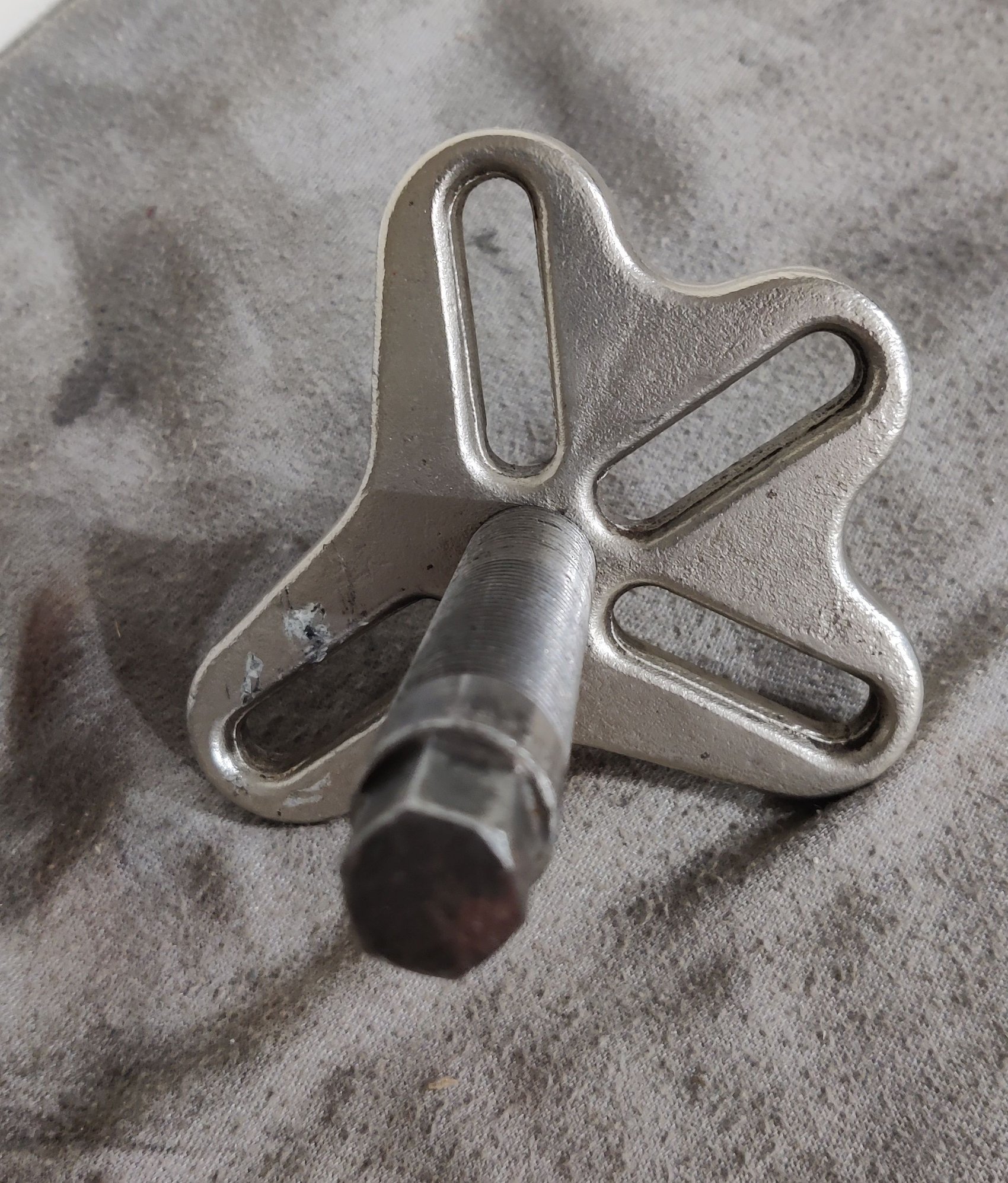

This really is the type of puller you should be using on that... It'll bolt right into the hub the way it's supposed to..
That's the one I use.

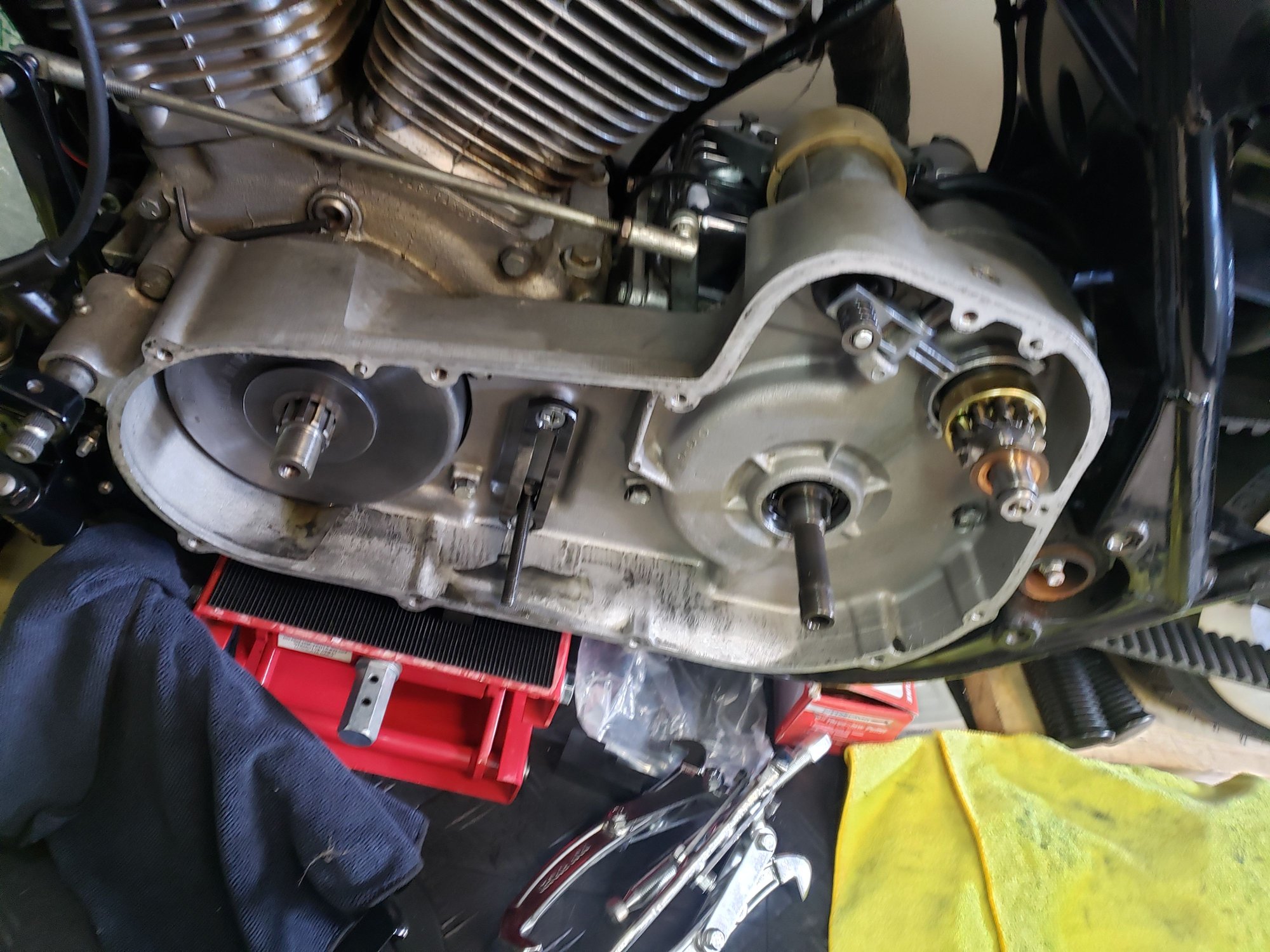

There’s also one that I use which you remove the 4 bolts on the clutch, install the puller and 4 bolts and drive it out.Do you have a FSM? That puller you have will destroy the clutch basket.

Would of helped if I removed the clutch adjustment rod. Duhhhhhh.

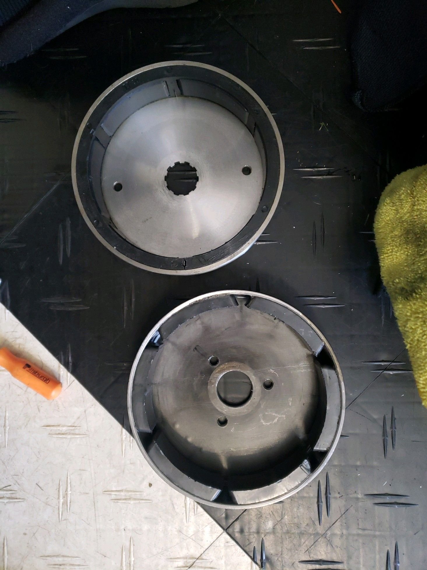

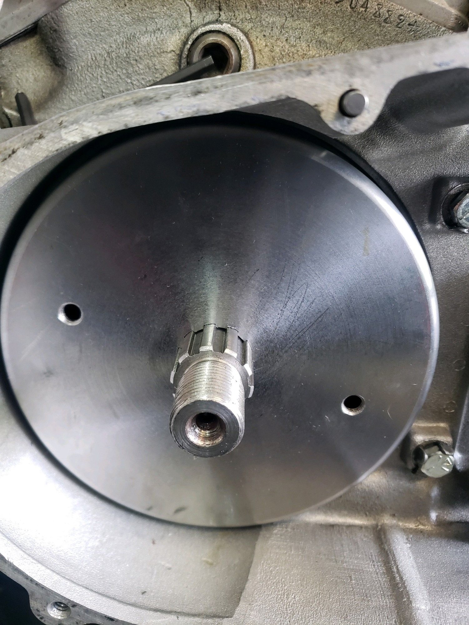

I can not get this cover on to save my life. It will not line up with the splines. 32 amp CompuFire system. Stator went in great. 55520 kit
Would it be OK to use the old cover? I just don't see this cover going on.
Old Apr 2, 2022 | 09:16 AM
  #46
86glider's Avatar
86glider
Posts: 1,529
Likes: 933
From: Long Island
Mini file to clean it up.
File the new one down? The splines?
Old Apr 3, 2022 | 02:44 PM
  #48
saintslax11's Avatar
saintslax11
Joined: May 2007
Posts: 1,489
Likes: 19
From: MD
After taking a break for a day and reassessing, it went right on in the first try. I got down to ground level this time and just slid right on.
