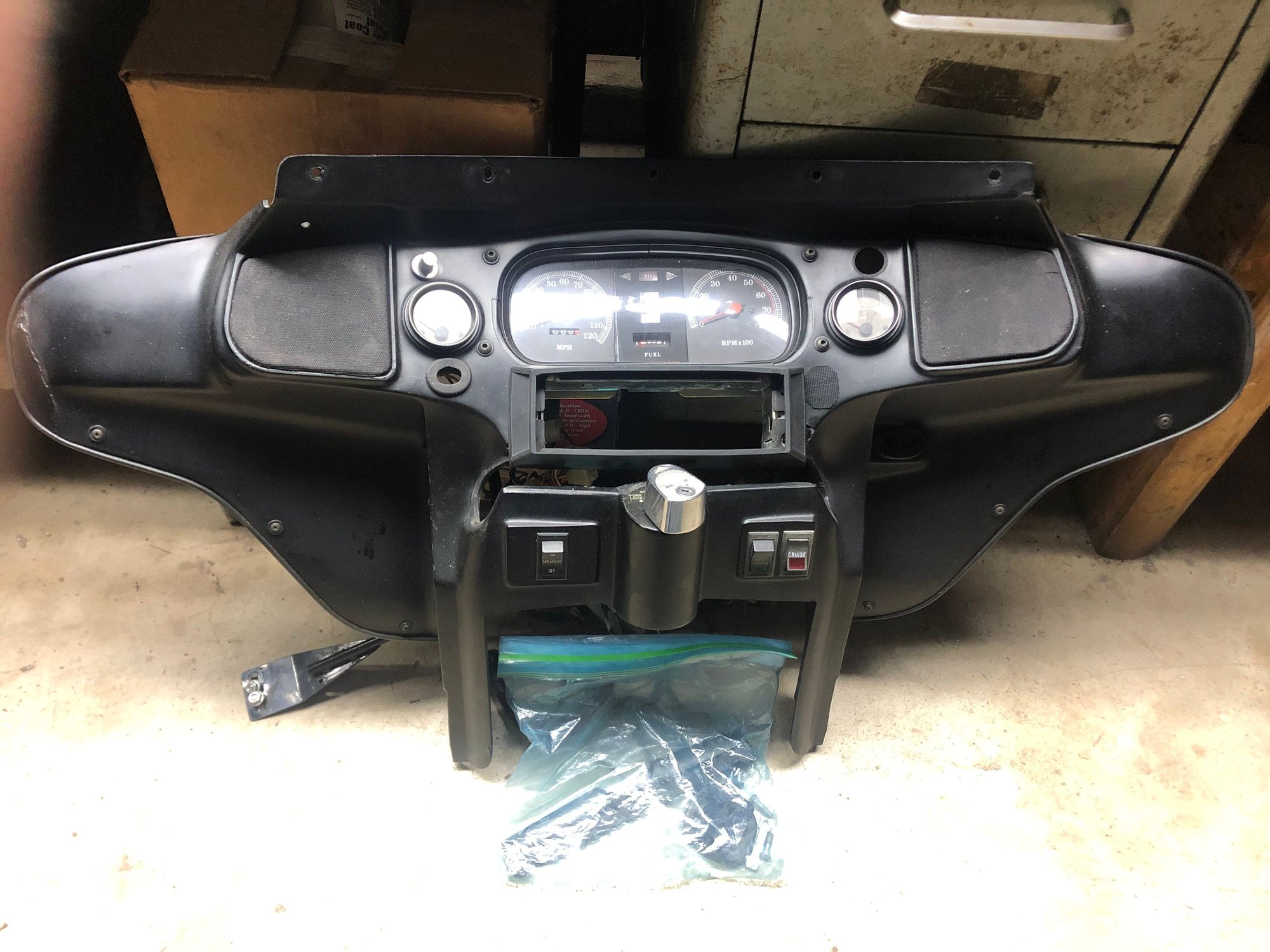

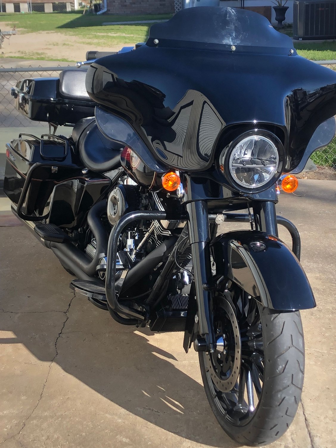

Did a few more things on the bike.
A 2018 Streetglide Turbine front 19" wheel fell into my lap, so I painted the rotors and installed the wheel. I use appliance epoxy for some parts that's painted instead of powdercoat, not required, but can be baked on and is some pretty tough stuff, the higher temp you use, the more it knocks the gloss down, gun builders use this paint and bake at 300+ to get a non gloss look.

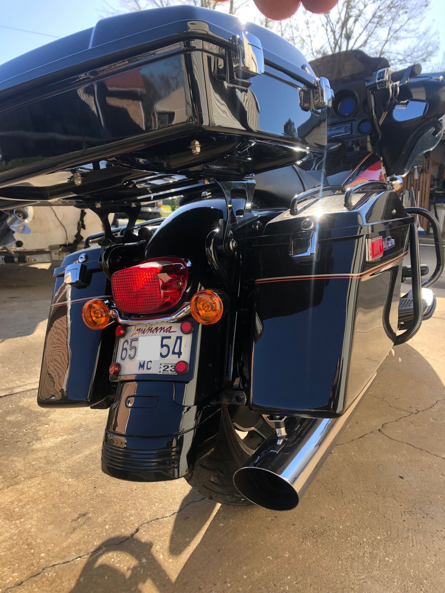

Powdercoated the tour pak brackets, bag supports and crash bars.

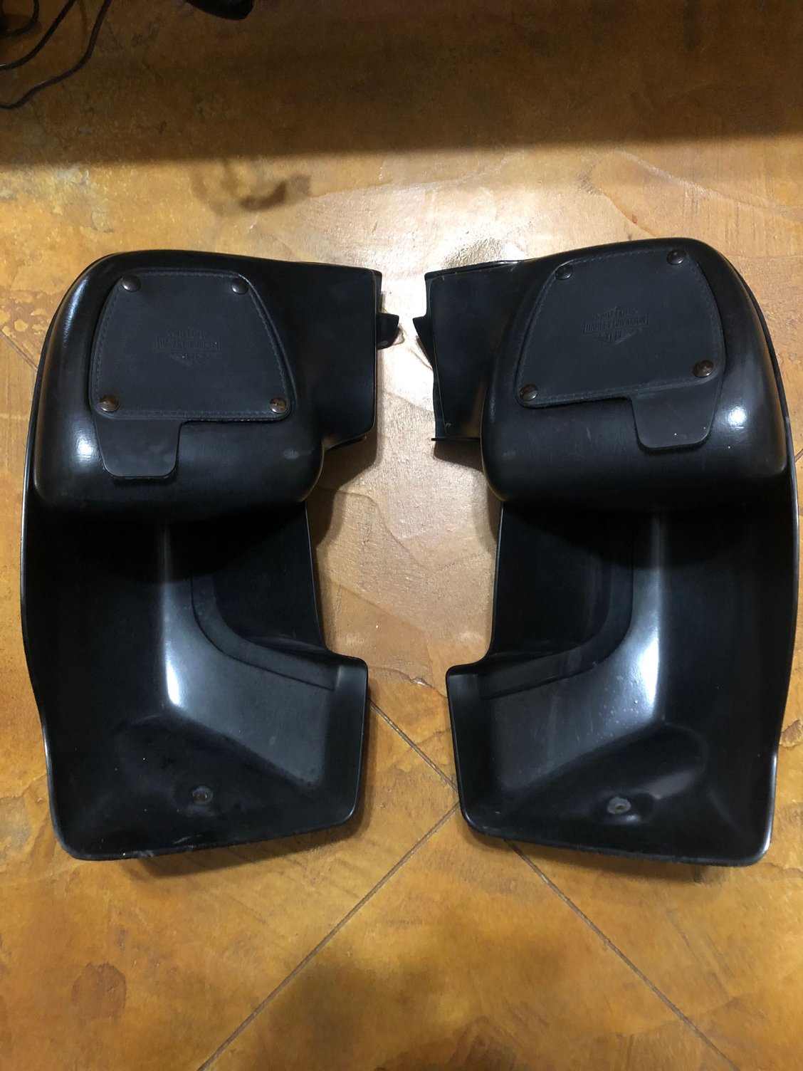

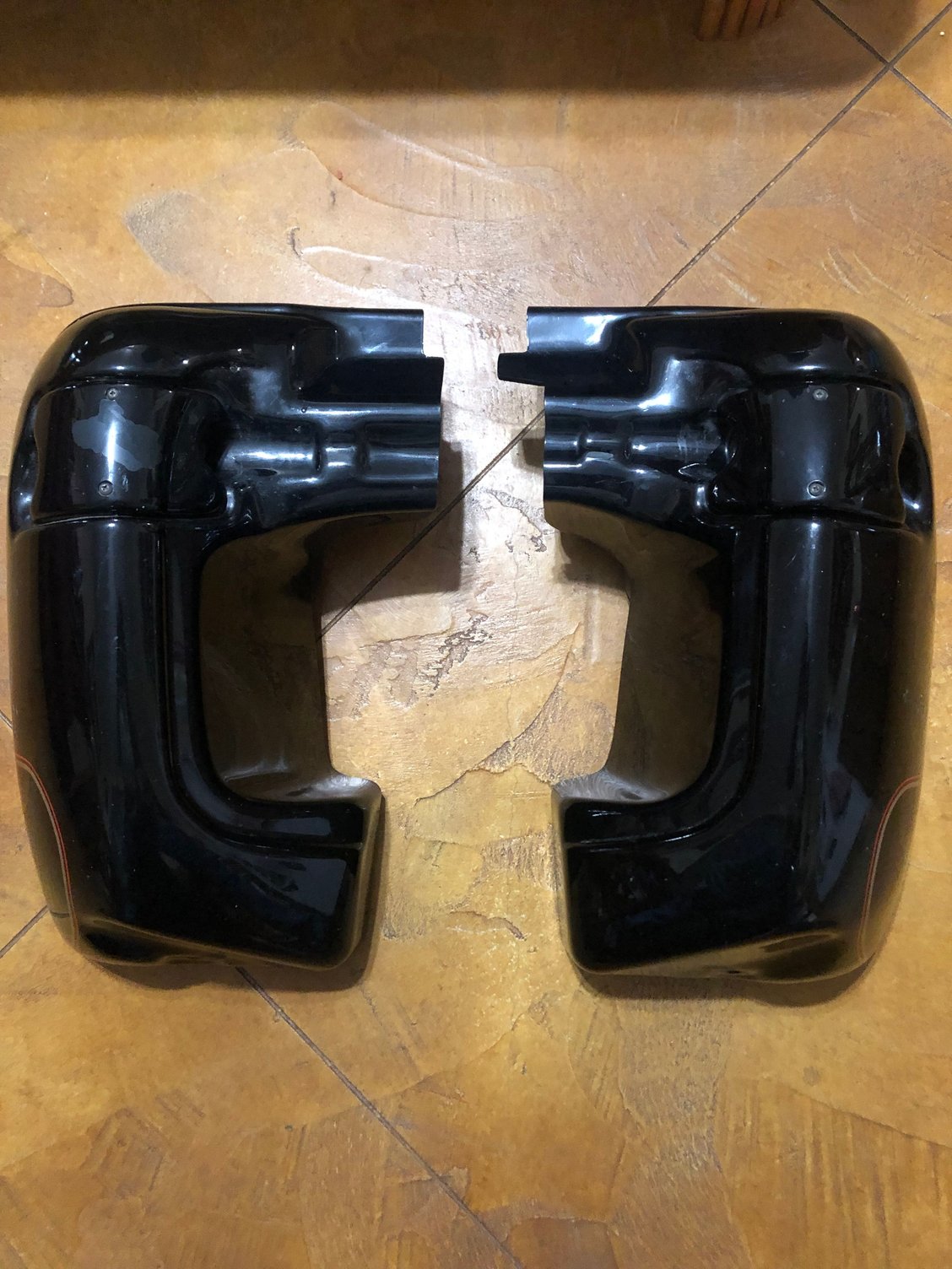

Had just enough paint on hand to paint the fairing

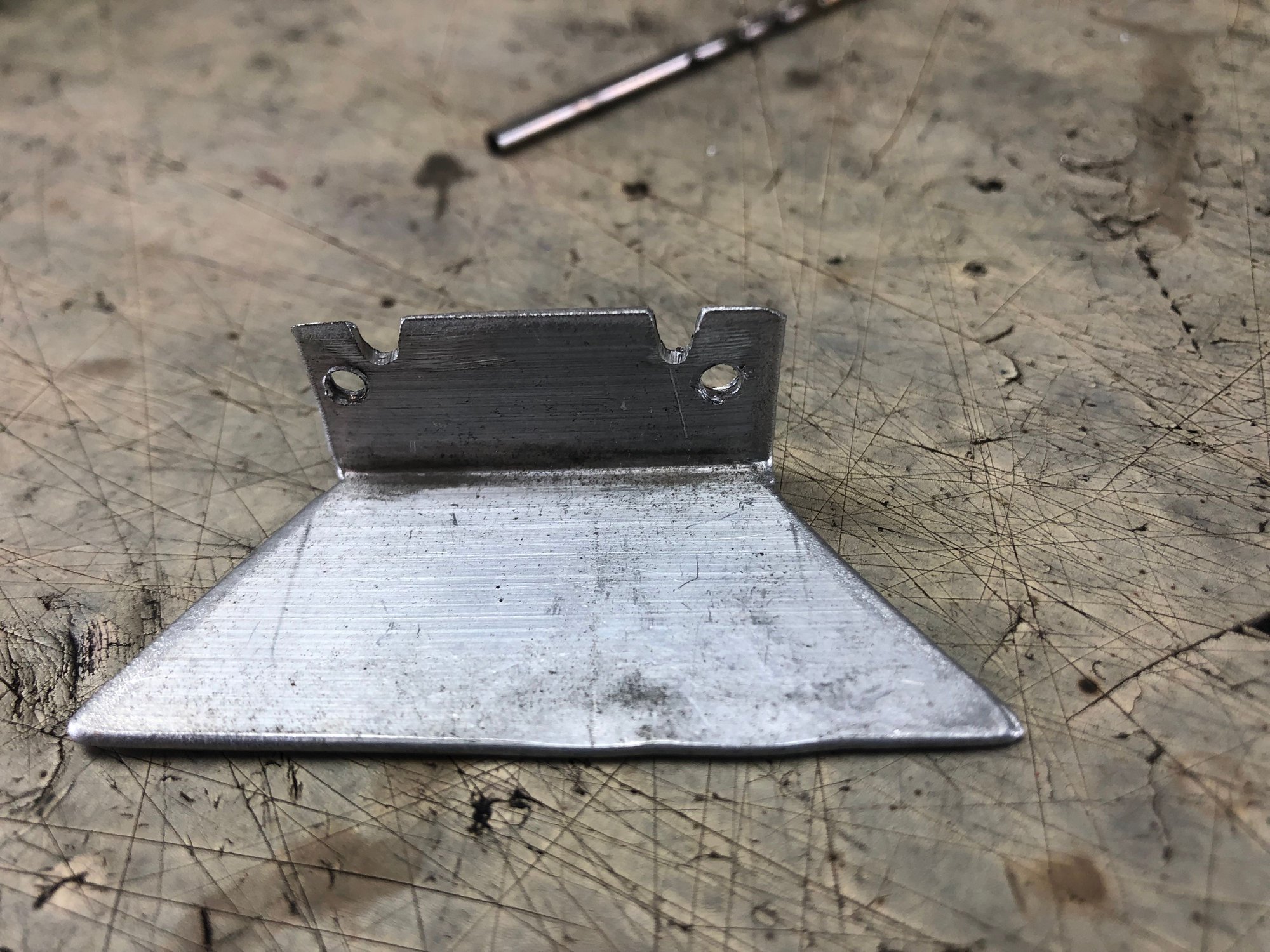

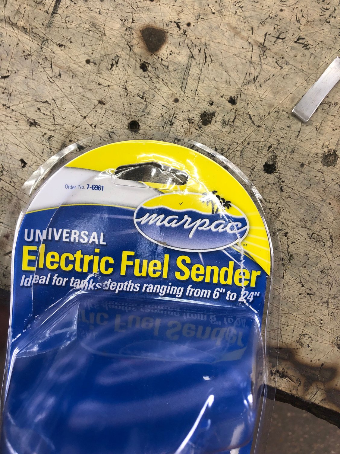

The fuel gauge sender was halfway working, I replaced the rheostat on the oem bracket with parts from a sender meant for a boat fuel tank, had to make a bracket to make it work, it worked out well.
Somehow the picture of the finished sender disappeared so no picture.
