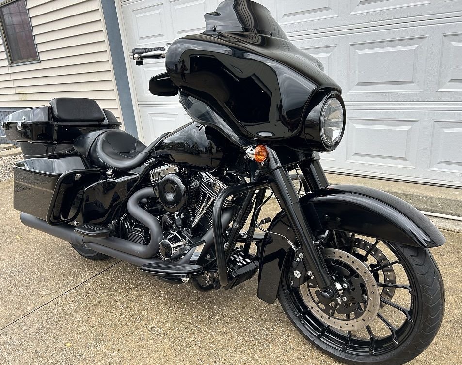

Nice bike what year is it?

1990

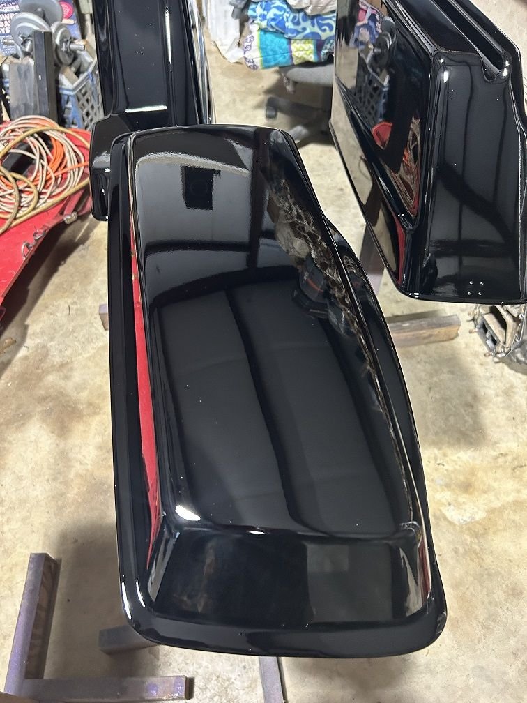

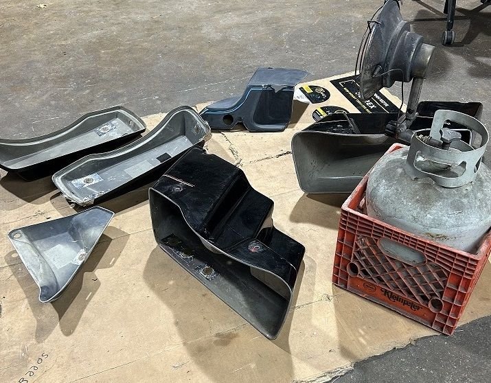

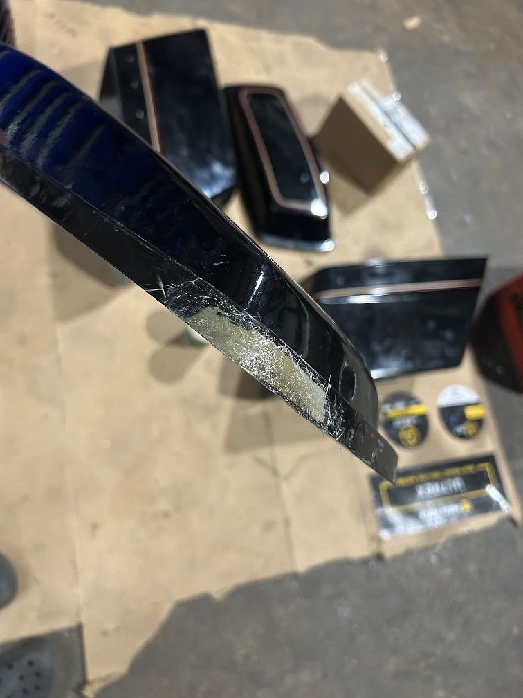

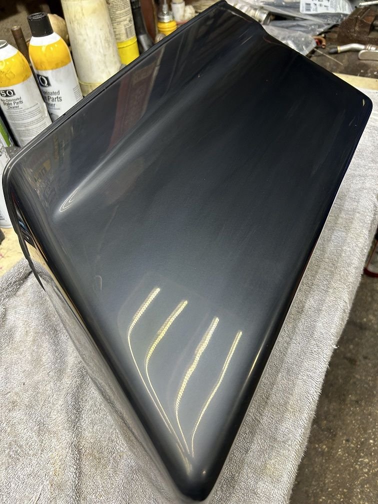

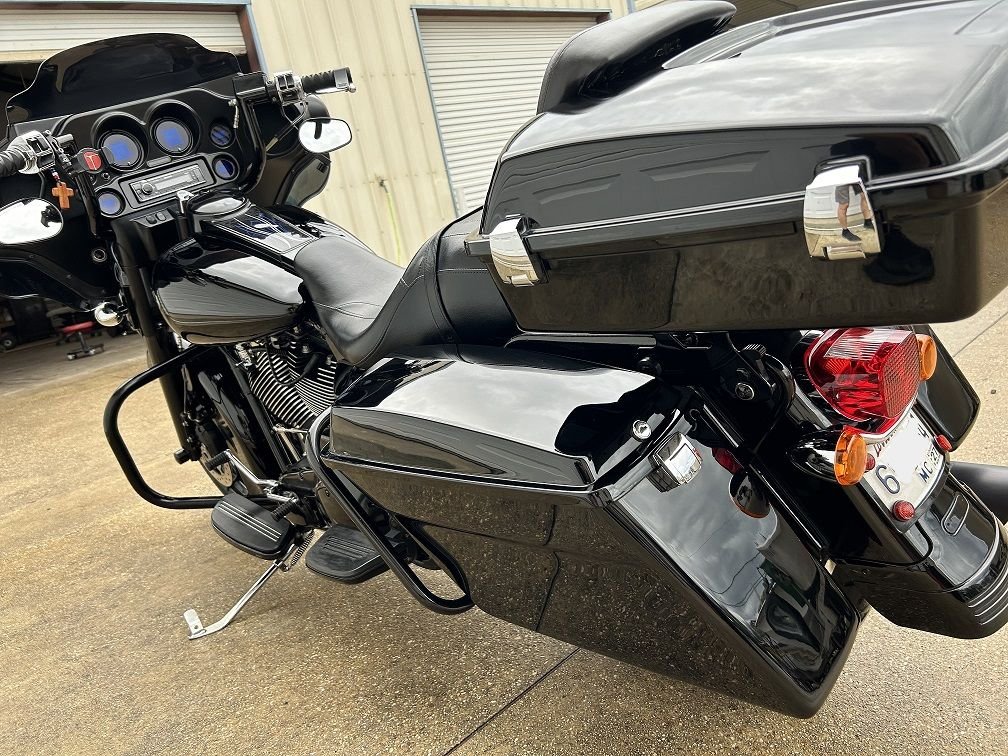

I finally got around to painting the saddlebags and side covers. I had to repair some damage from when the lid flew off, and cover the holes from removing the emblems/reflectors and rails.
Bodywork, paint then cut & buff

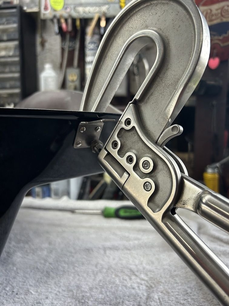

Replaced the hinge clip hardware, sure was nice to have access to the rivet tool.
The clips were worn half way through, drilling & pinning them wouldn't help if they broke there.
New weather stripping for the lids.
All shined up, that's a wrap for the paint.

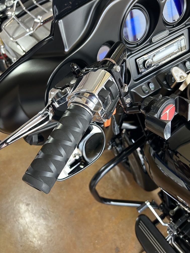

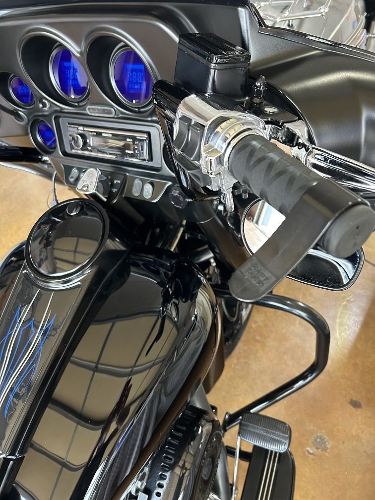

I stole this idea from Hossamania on HTT.
It's shrink wrap for fishing pole handles, from Amazon, 1.6 meter length, 40mm dia. for about 8 bucks.
Installed on stock grips, I'm liking it so far.
Got a link?
Also, was it a hassle to replace the weather stripping in the bags? I have a bag on my Sporty that needs new weather strips.
