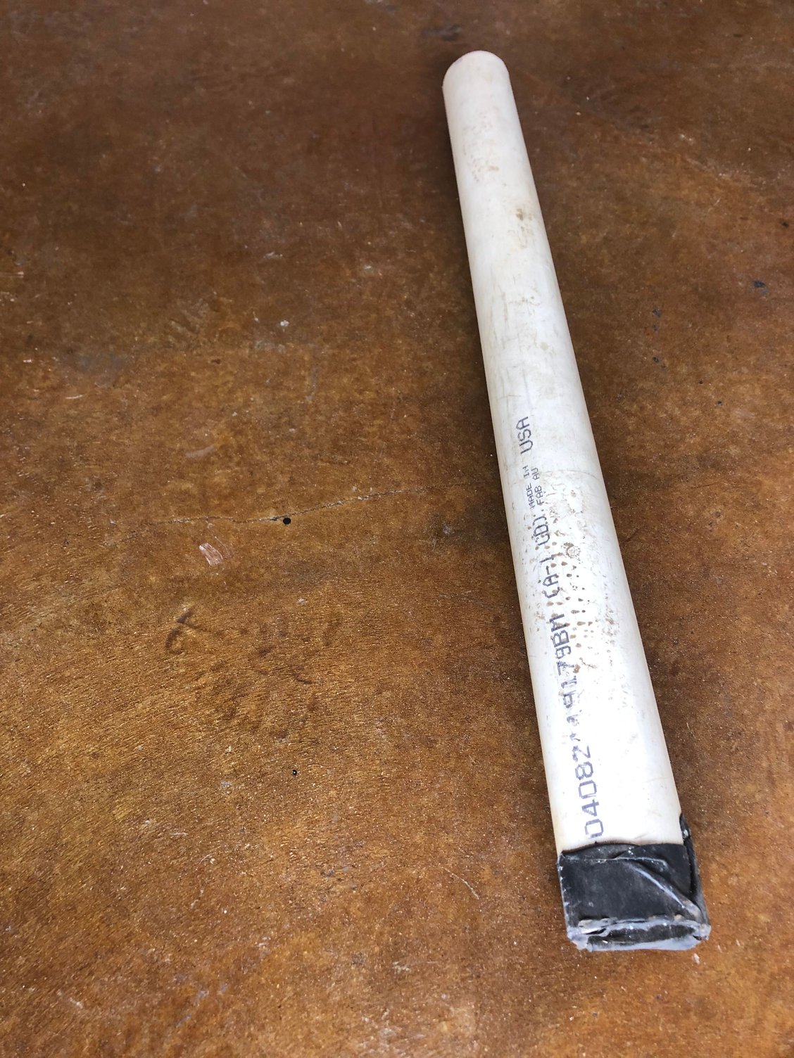

Originally Posted by t150vej
. It can easily get sucked into the front of the carb and give a false positive
This is my anti false positive rig, 2 1/2’ piece of 2” pvc, has some rubber tape on the end, probably not needed but it was there so I put some on.
Remove air cleaner, hold it on carb, spray away
