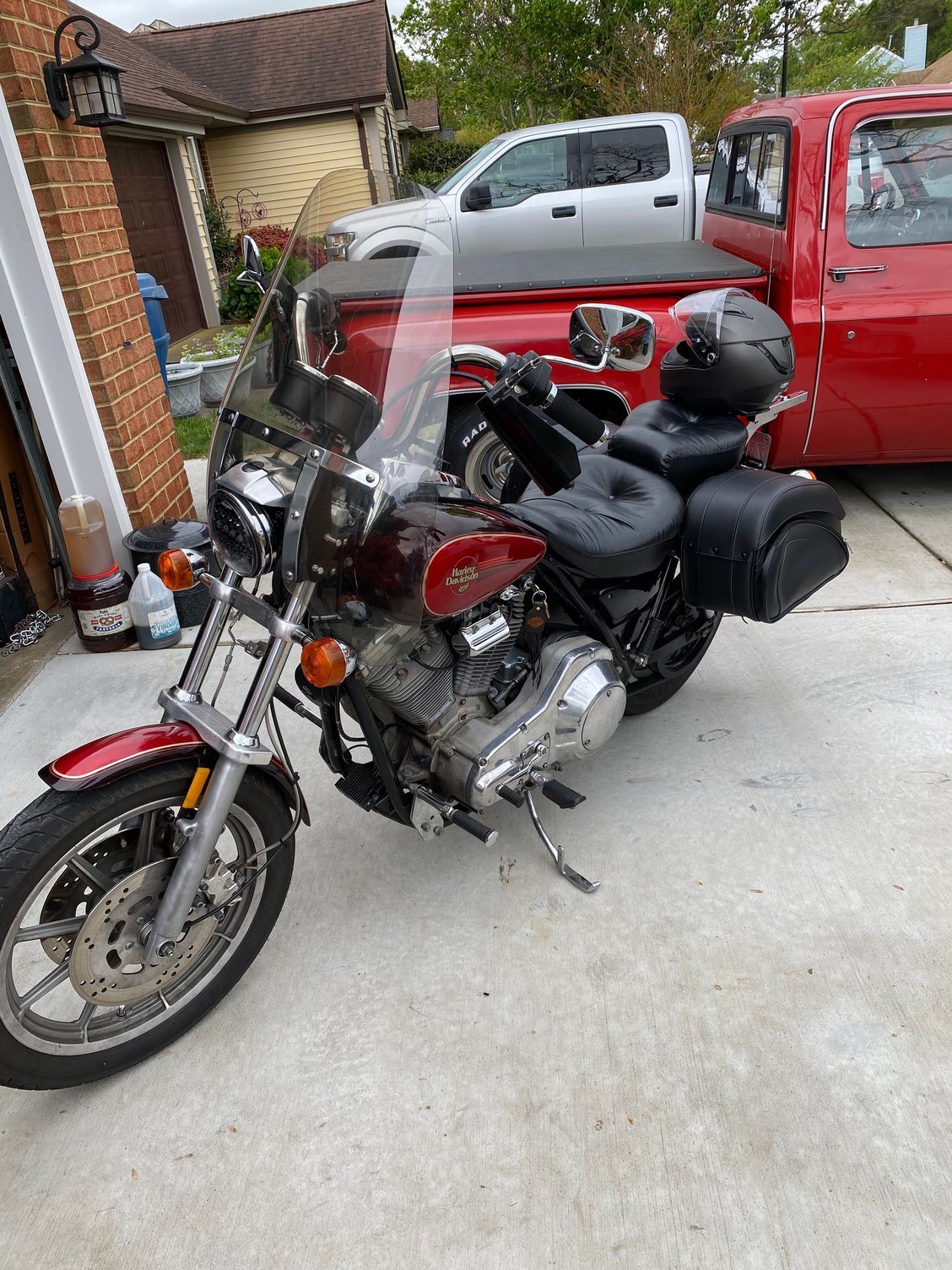

1990 FXRS-SP Stock motor except mikuni hs40 carb and supertrapp exhaust. Bike has about 13350 miles. Sat for years before I took ownership. Have been riding it for about two years after getting running again. Was running fine then started running rough and popping, loss of power. Traced problem to rear cylinder not firing. Replaced entire ignition system - new stator, rotor, voltage regulator, cam sensor, ignition module, wire harness, coil plug wires and plugs, still not firing rear cylinder. This is a dual fire system. Tried swapping plug wires at plug end only still no rear cylinder. Plug is wet with gas when removed. Checked for leaks on intake manifold and exhaust ports with brake clean, no change to engine rpm. Tried pulling plugs and looking for spark when cranking. Both show spark but rear looks to be lower level. Tried another set of plugs no change. Bike will run but runs like crap on one cylinder and don’t want to cause other issues like washing fuel into crankcase due to blow by on rings, etc. I am an old ho trodder and know to drill on spark fuel air for an engine to run. I have tried adjusting timing and no improvement. I have tried three separate brand new coils one a 5 ohm and two 3 ohm. No change. How can one cylinder fire and not the other on a dual fire coil?
new ignition module is a TwinTec with adjustable curves - tried multiple settings. Definitely set to dual fire mode.
bike has been down for a few months due to this issue.
thanks

Good looking bike, I'd say keep it if you like it. I half expected you'd find something there myself. Those numbers I wouldn't call good, but certainly acceptable enough it should run just fine.
