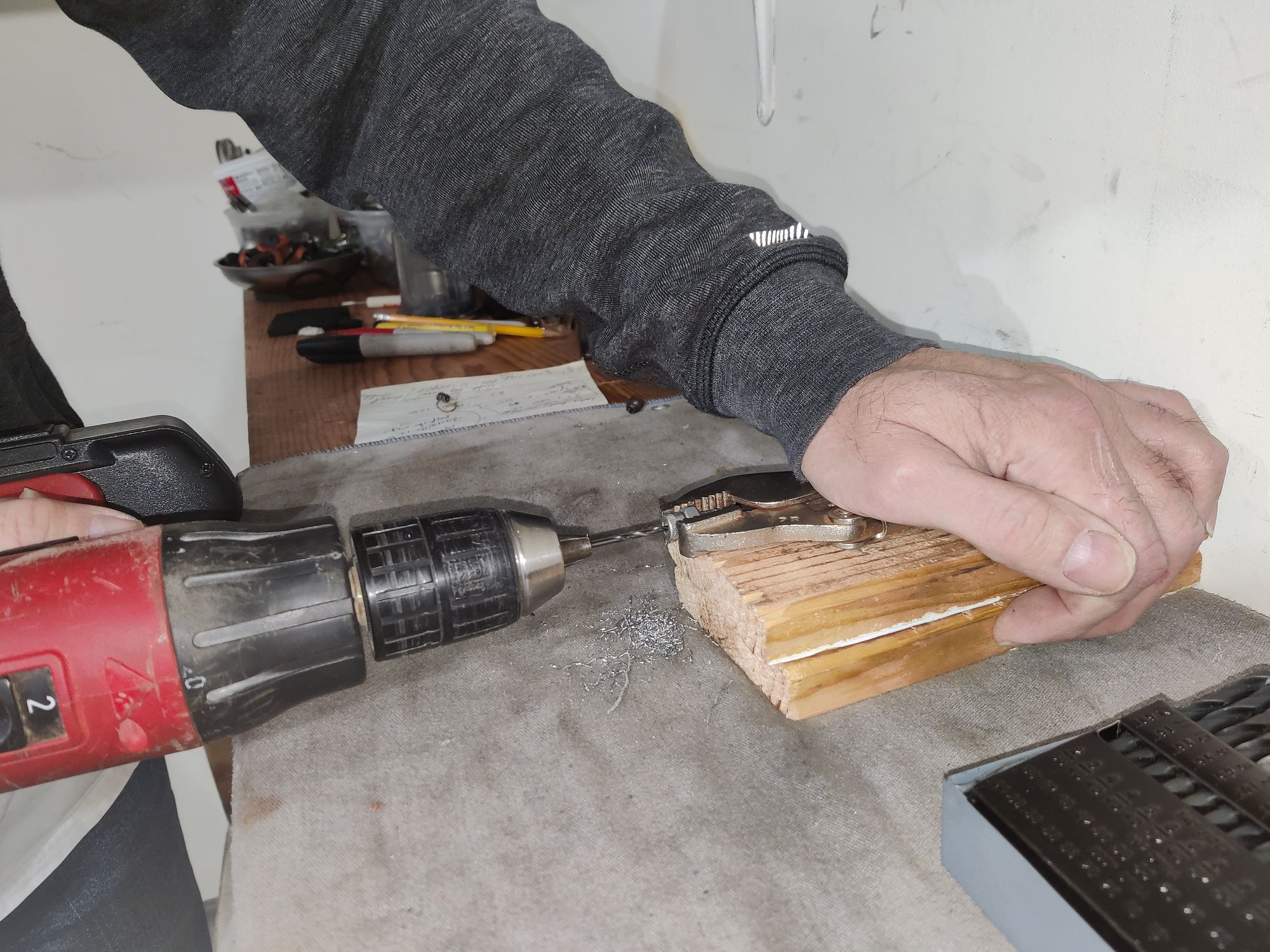

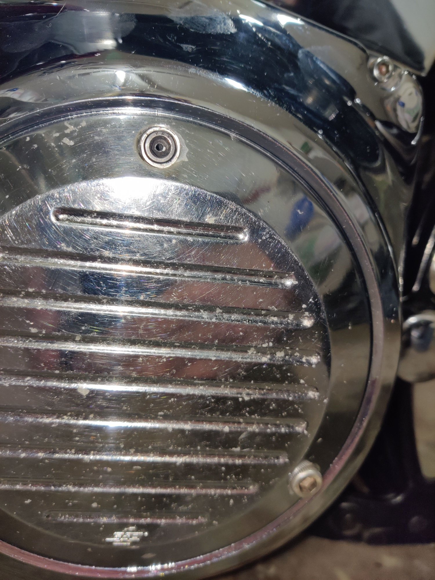

Man, I still have a leaky some where but I don't think it's motor oil... It's either my IPB seal or a shock.. the oil is too clean.. I just put the shock on a year ago.. 422's..
Not sure if the primary is venting or not so I tried the hole in the derby cover bolt truck.. We'll see what happens... Did I tell you"I ****ing hate leaks"....

Keep us posted on how the drilled hole vent works out.
How did you drill the hole straight? Resealing the inner primary on my Shovel and like this, put a vent hose on the backside but it's in the oil level area, will be fine but like this simple set up

Well I don't have a shop any more so I make do with what I can in my garage at home.. I put a nut on the Allen screw to be able to hold it firmly with vise grips.. Set up a couple of boards against the wall on my make shift work bench to raise the bolt above bench level. Then with my drill I just tried to keep it as straight as I could while keeping good pressure on it and drilled it out with a # 47 machinist drill bit.. No need to go bigger, it just weekins the screw.. It came out pretty straight and good enough for Primitive Pete.. lol.. when you don't have a drill press ya gotta make do..
