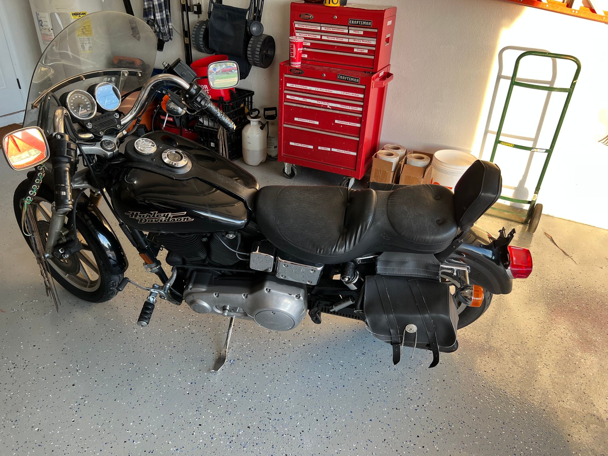

After 14 weeks, a couple hundred hours and mucho denaro, my Superglide transformation is complete. I bought the bike back in February for $2500 with the intention to build a bobber-style bike, something I’ve wanted to do for the last 10 years. As I mentioned in some previous posts, the bike ran OK when I bought it, but I still wanted a bike with a little more giddy up so the mods included a cam, high compression pistons, lifters, a street port and an ignition system. Thanks to all the members who helped when I posted questions about problems I had along the way. This is the bike when I bought it:
Looks pretty much stock from ‘95 but neglected
Bike didn’t run good at first (why I got it cheap), put in spark plugs, cleaned and tuned the carb, new intake, flushed all the fluids then ran pretty good

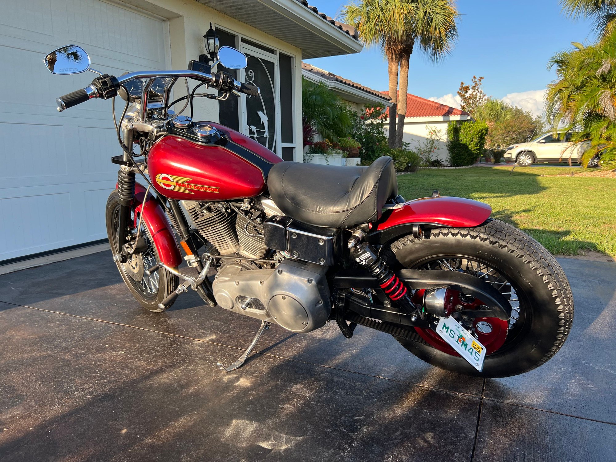

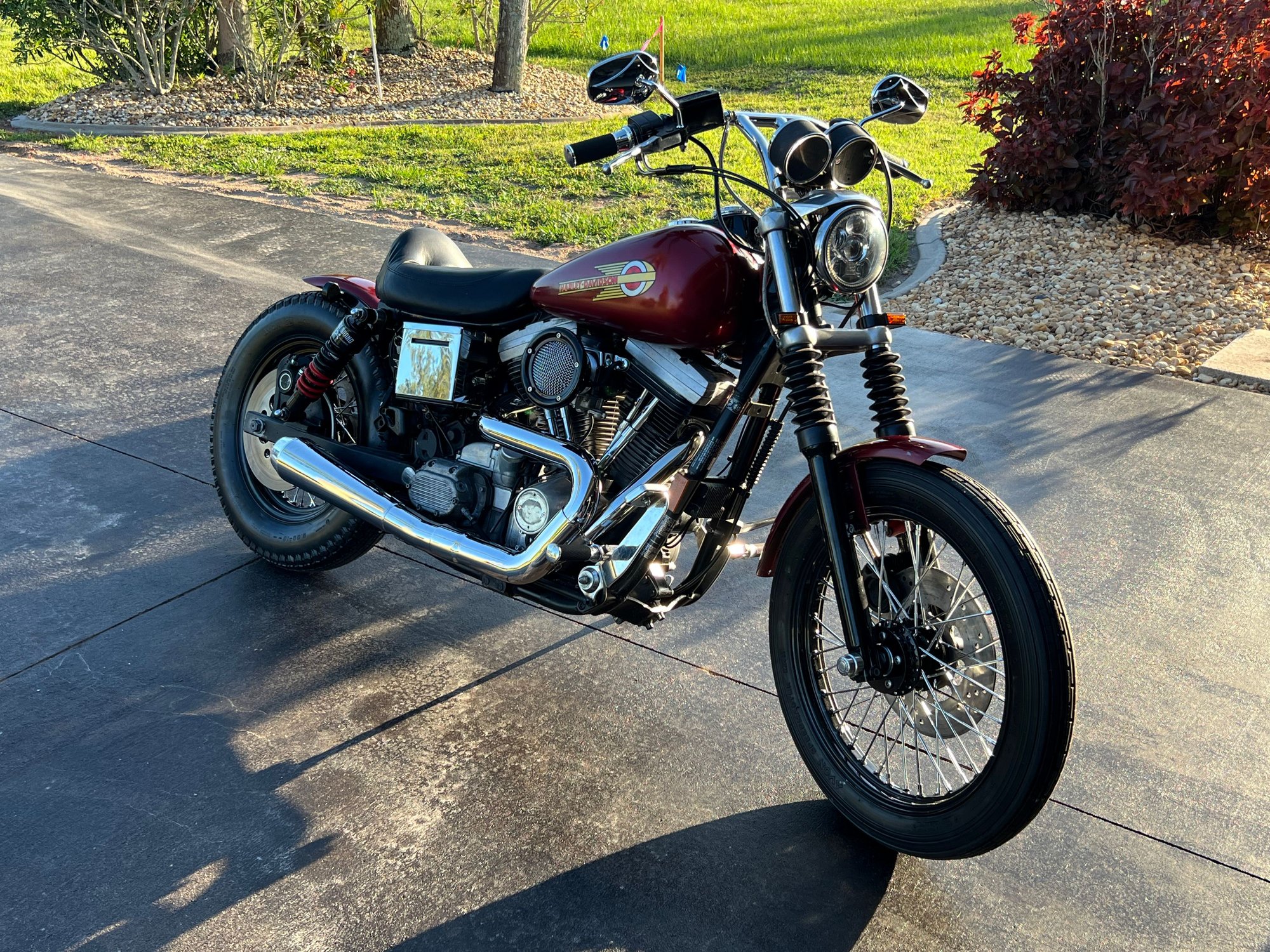

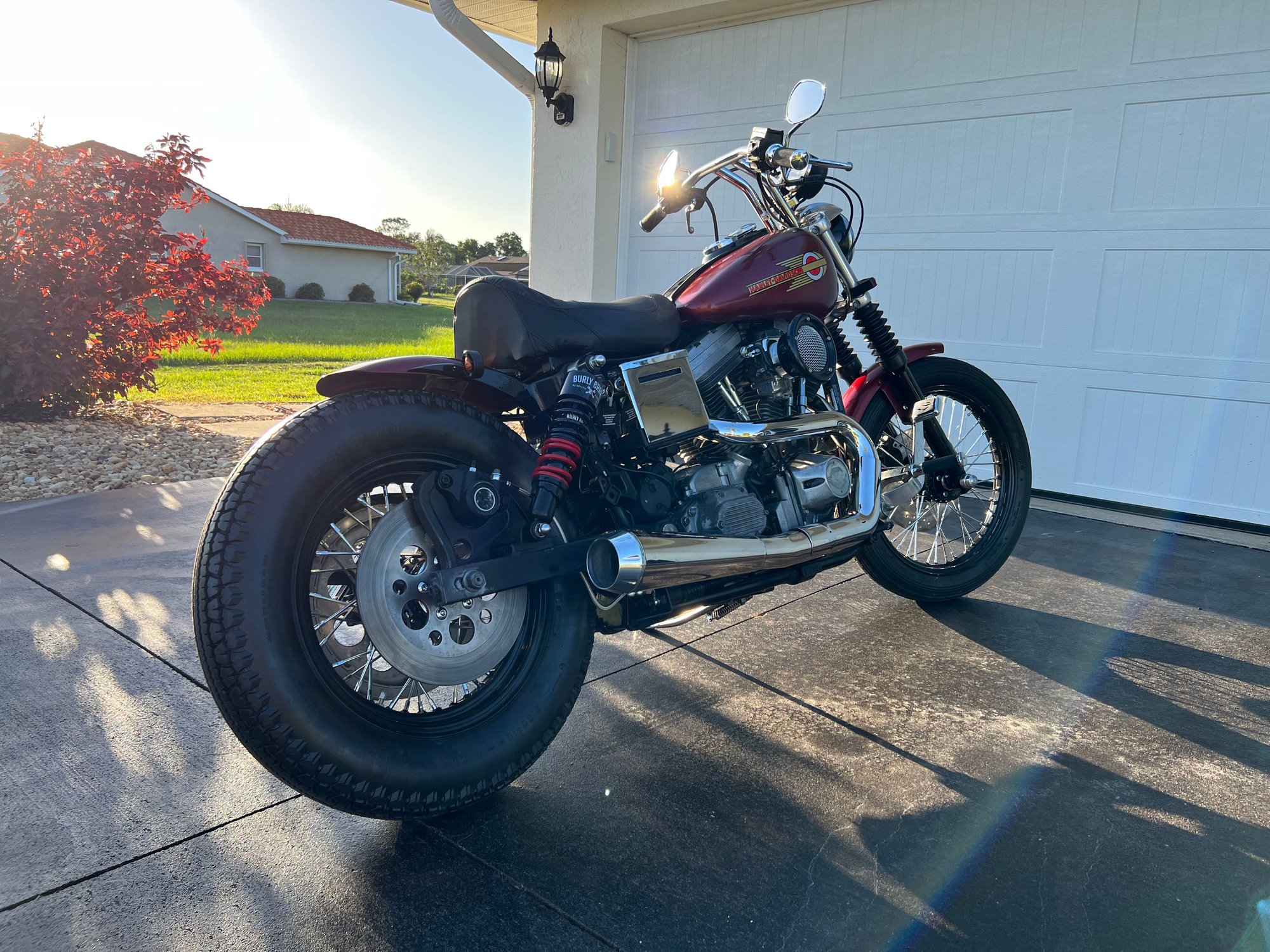

Bassani 2/1 road rage shortie, Avon tires, Paughco 9” T-bars
Rocket Bobs rear bobber fender, pricey but well worth it. Joker Machine LED turn signals front and back, LED headlight and brake light.
I used the stock seat, cut off the back half and had a panel sewed into the back. Not crazy about the look but that seat is so comfy.
Looks fast just sittin’ there.
I fired it up for the 1st time over the weekend. I could have made the initial start up a lot easier if I had put a couple Tbl of gas into the float bowl beforehand. Also, spraying some startup fluid into the carb was helpful. I let it run for about 5 minutes the 1st time, made adjustments to the a/f mix and had a fan running over the engine area. Let the engine cool, fired it up again ran a little spotty so I shut it down, replaced the 45 pilot jet with a 48 and fired it up again and it ran better and got good throttle response without any coughing. I’m running curve 4 on the Dyna 2000i. I let the engine cool and fired it up again and once it was warm, took it out for a 5 mile maiden voyage, varying the RPM’s while hitting’ the throttle pretty good and letting it decel rapidly. I followed the break in procedure on the Wiseco website. I’m taking it out this morning for a final 20 mile break in. The only thing that doesn’t work the way it’s supposed to is that my turn signal indicator lights on the dashboard don’t work. The turn signals work fine and cancel the way they should, I’ll have to sort that out later. Here’s a list of the parts:
Engine- Wiseco 10/1 dome pistons, honed the stock cylinders, Andrews EV 46 cam, S&S lifters, B138 cam bearing, Big Boyz street port, Bassani 2-1 Road Rage shortie exhaust, Kuryakyn Velociraptor intake, Dyna 2000i ignition, 48 & 185 jets. Everything else- Rocket Bobs rear bobber fender, wire wheels from TC Bros, Avon roadmaster in front, Avon MKII in rear, new fork seals and fork oil, Joker Machine LED turn signals, LED headlight off fleabay , Custom Dynamics signal control, new brake lines & pads, speedbleeders, TC Bros side mount license plate/LED brake light, Paughco 9” T-bars, Burly Brand stiletto shocks.
The only labor I paid for was $150 for Powdercoating the lower legs and gas tank bib, $340 for the Big Boyz street port, $360 to get the speedo fixed at Powl’s. I modified the stock seat from 2 up to solo and had an upholsterer cut the leftover seat cover and attach a new rear panel on it- $120. I painted it (rattle can) and the paint was from R&E, the color is Dodge high octane red with a gloss 2k clear coat. Giddy up!
